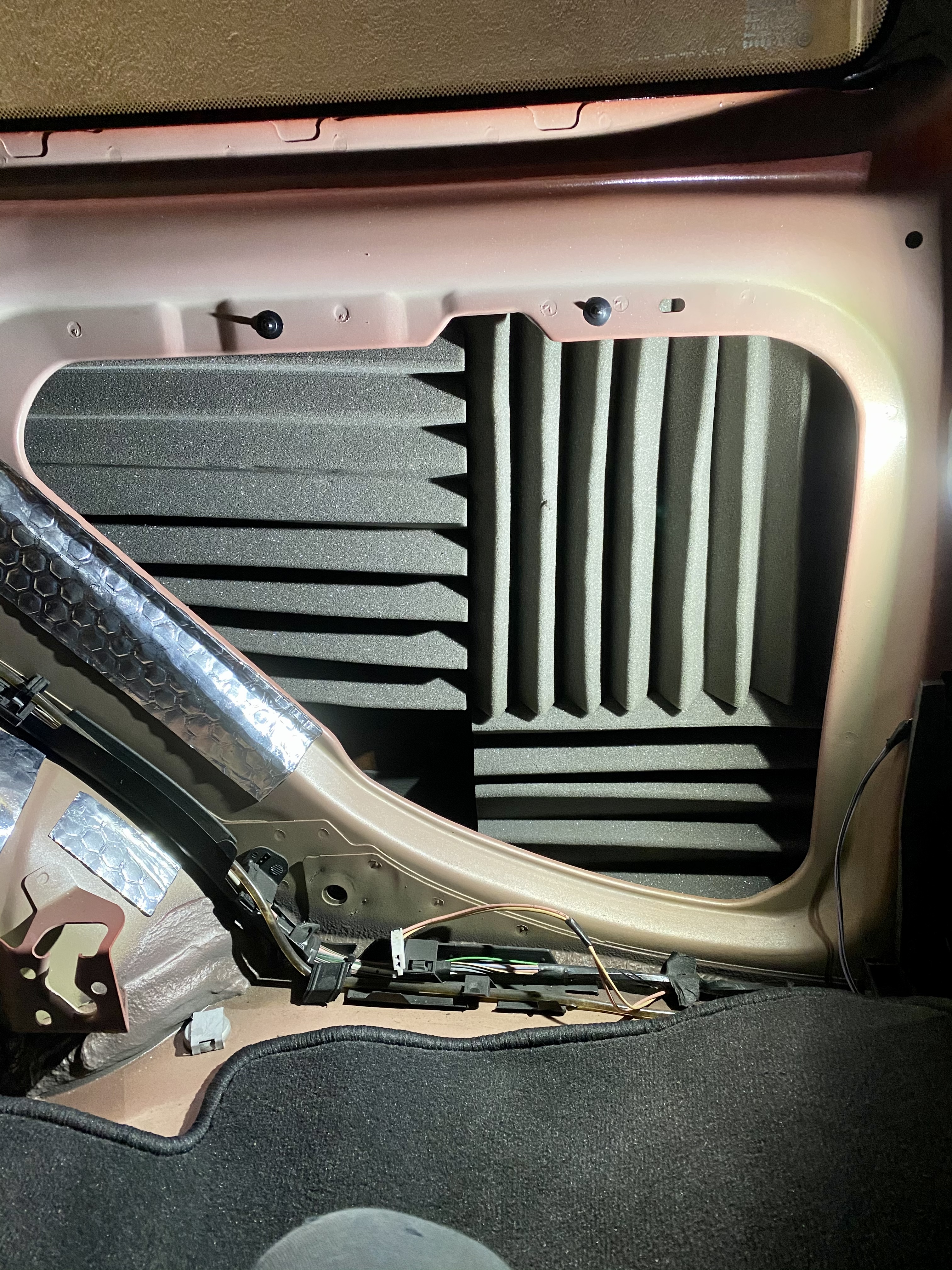

Really interested in the difference it makes as I might do the same when my interior is coming out this summer.
Is that a double layer of different materials behind the rear door cards?
frayz
Yep that’s correct.

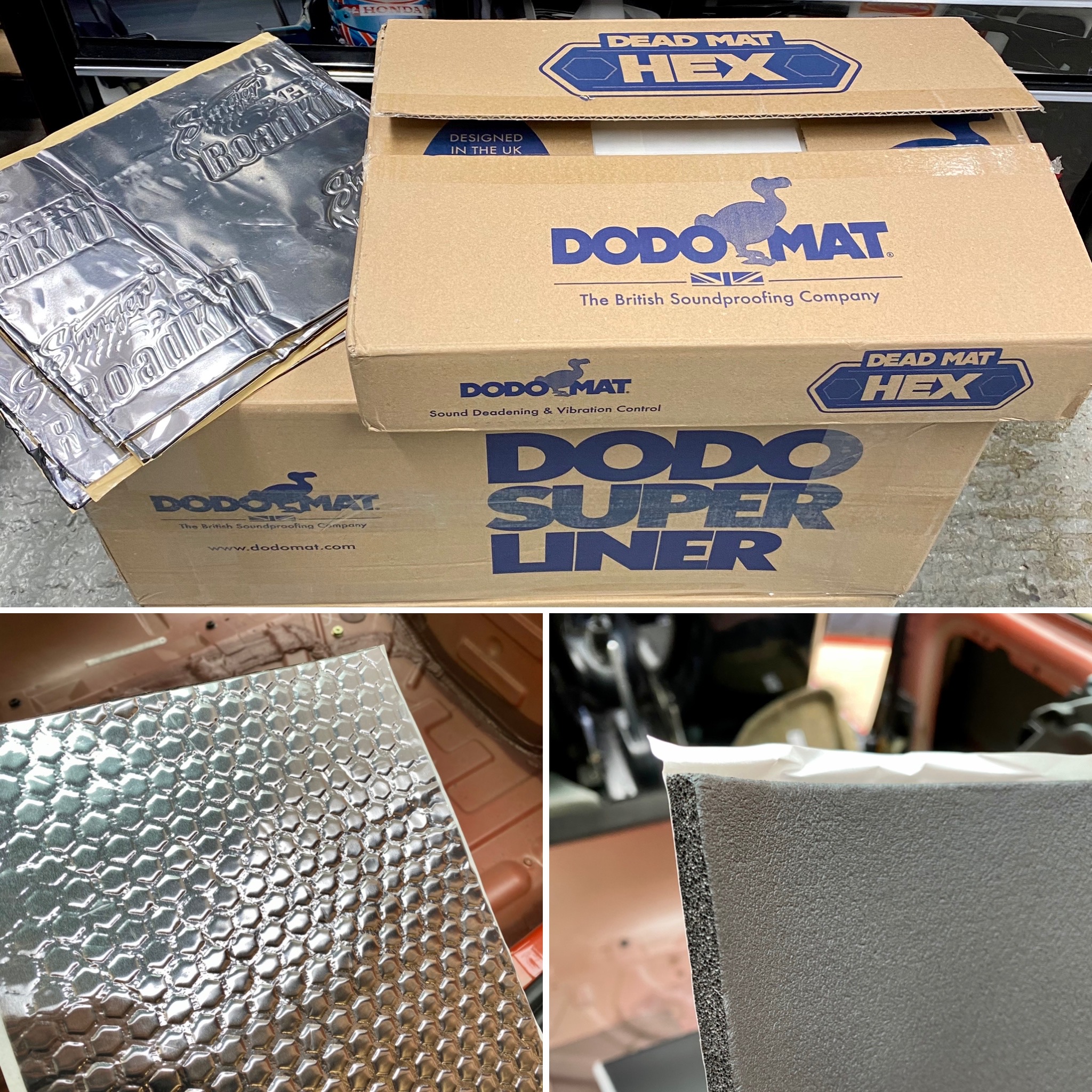

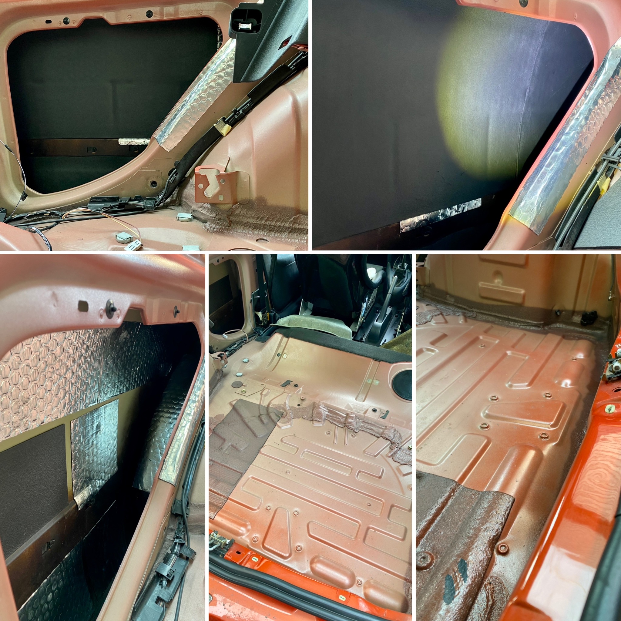

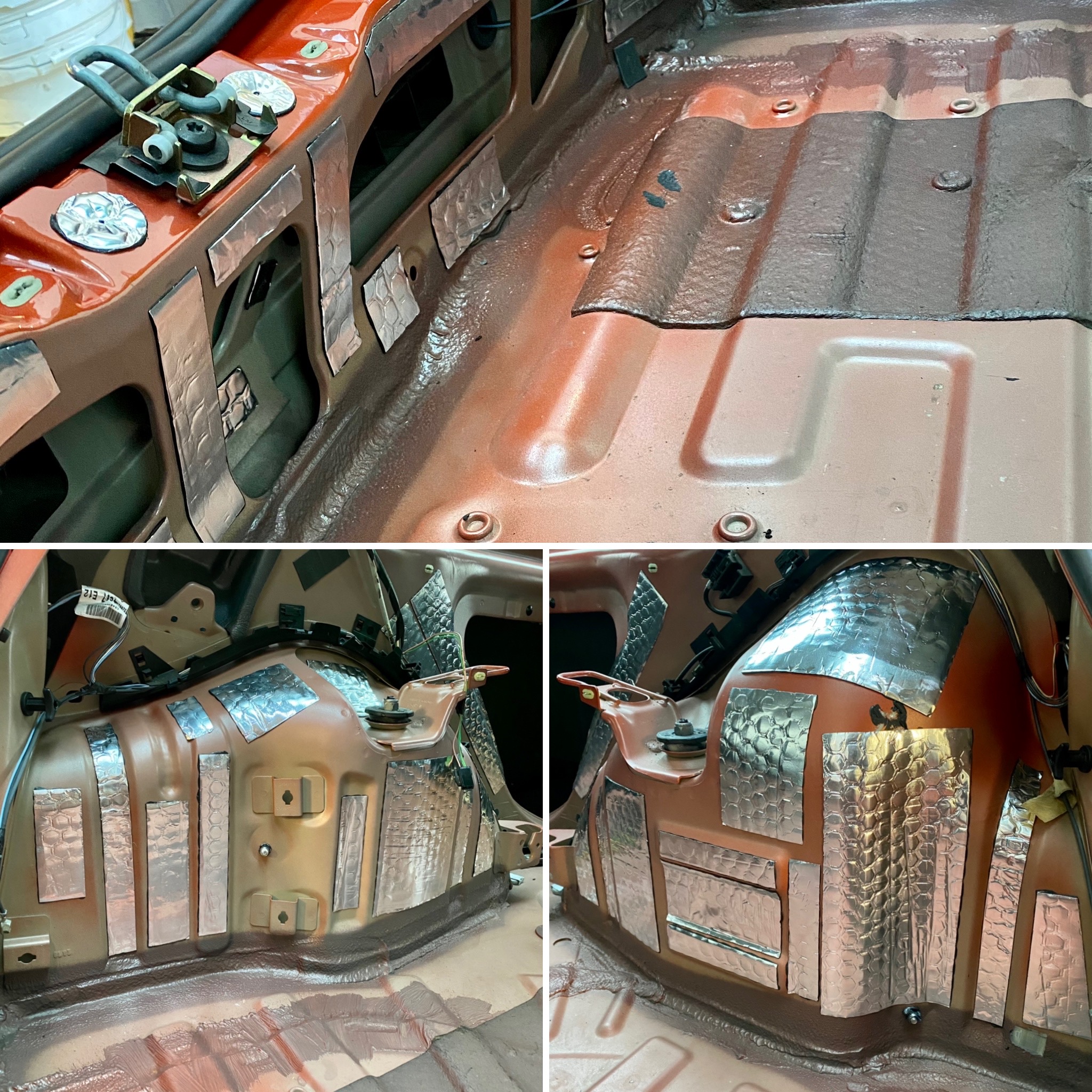

The whole lot will be at least double layered with 1 layer of 1.8mm Hex mat (50-75% coverage) then have at least one layer of 6mm super liner acoustic foam. The foam will be closer to 100% coverage. So far I’ve used 2 full sheets of 2mm Stinger Road Block on the tailgate both sides of the inner panel and inside the plastic trim and the boot lid actually sounds decent to close now.
The rear quarter panels have 3 sheets of Hex in and are the only parts to receive the second layer with foam so far. I’ve also done all around the arches between the panels too.
The acoustic foam is the stickiest stuff known to man but it weighs next to nothing. So I’m going to see how I go but will more than likely add multiple layers off that in the doors too.
The mass loaded stuff stops the buzzing but it’s the layers of foam that really cut the noise down.
It’s amazing how much difference it’s made already just knocking on the panels and I’ve not even started on the floor yet.
For info, the stuff I’m using is totalling 12kg for 30 sheets not including the foam. 30 sheets should just do the whole car not inc roof an is about 2.5sqm. Then I have 6.5sqm of foam to go in but may add more.

Did you weigh the 12kg yourself? As the dodomat 30 sheet pack I was looking at weighs in at 7.5 kg according to their website?
Not too bad a price either if the difference is so big.
I hadn't thought of the foam liner, but I have to admit I like the added benefit of thermal insulation.
frayz
I didn’t, I just had it in my head it was 12kg.
I looked at so many products, the 12kg must have been another. I’ll accurately weigh a sheet tomorrow and multiply by 30 and let you know.
Thermal insulation isn’t something you really think about in a car but it makes a huge difference. I’m surprised it’s taken me this long to investigate and dabble in it really.
Price wise, I’m £114 in so far on materials.

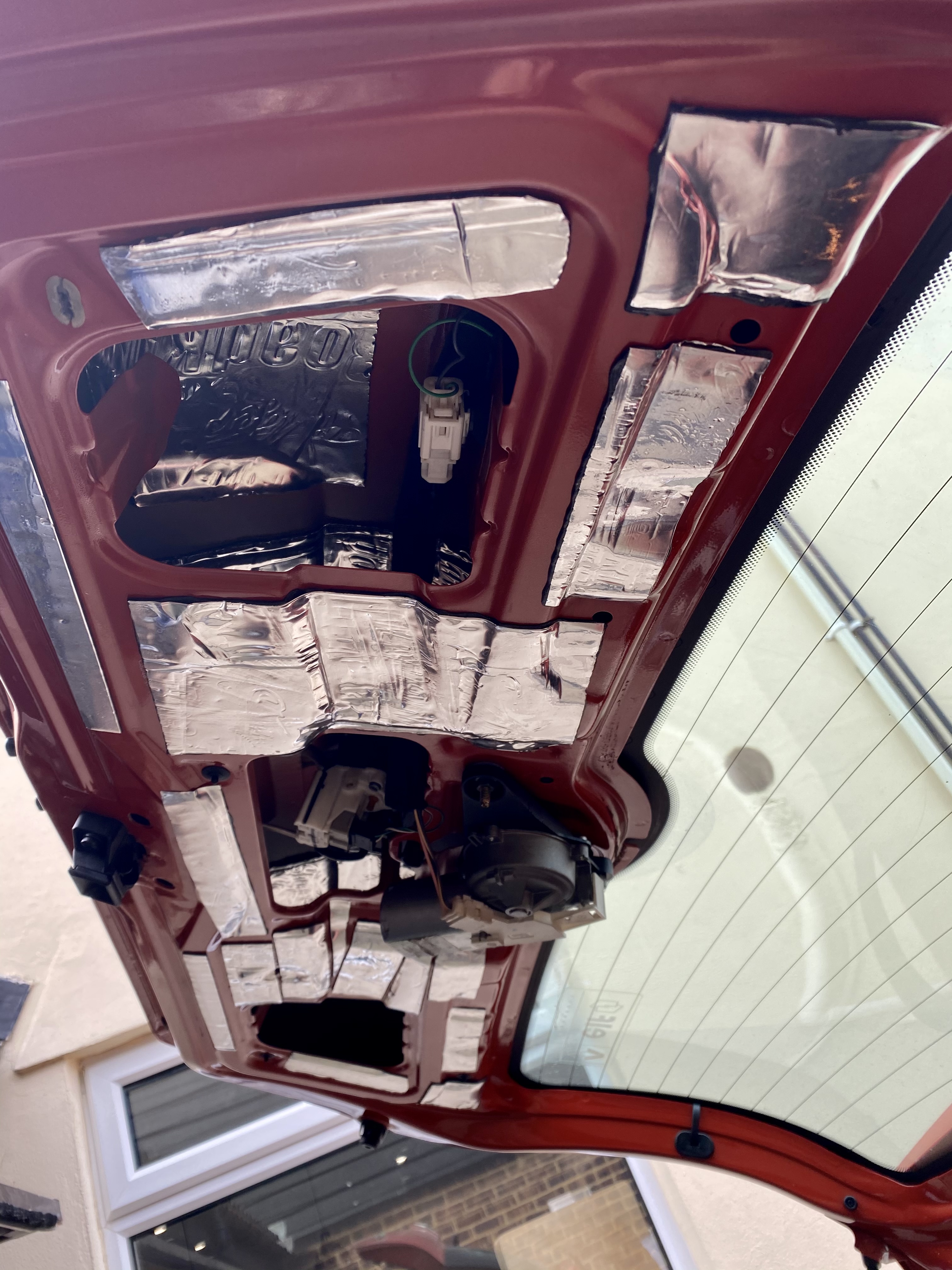

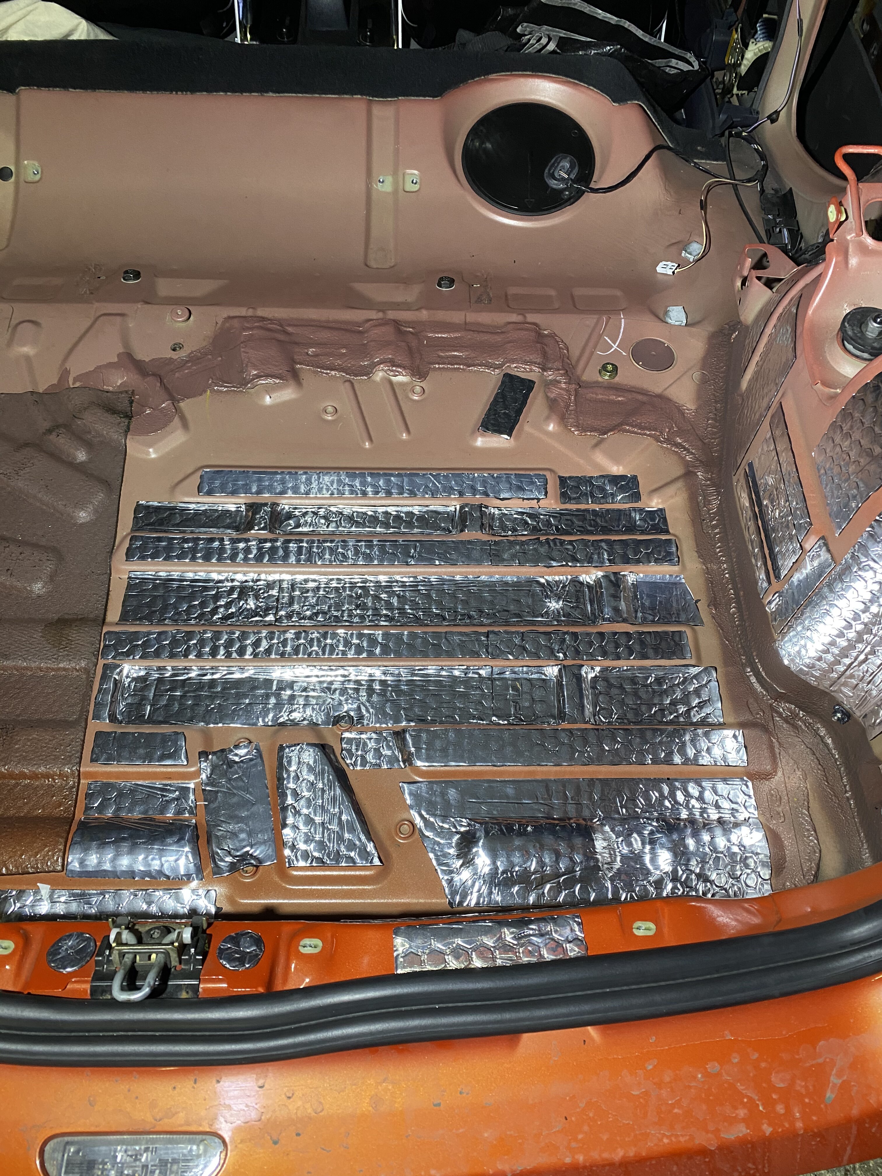

First impressions:
I've driven the car to work today still in its semi-stripped state, just the boot carpet has been put back in.
Bare in mind I've only so far done the tailgate, back panel, arches and rear qtrs with mass loaded sheet and the rear qtrs and tubs have been foam lined. Already the car feels noticeably more solid inside. Reduced road noise and hum.
However, one of the catalysts for this exercise is i have had a buzzing from the rear of the car that i have been convinced was the tailgate. I've tried all sorts to shut the trim up which i suspected was the culprit. At approx. 3krpm i get a buzz from the rear of the car and since adding the deadening, it almost seems like its more pronounced as the rest of the cars ambient noise is less.
As i was parking up this morning the buzz was significant, as its still dark when i arrive at work i could see a flickering of light in through the back panel of the car.
With the rear trim not in place i can see the cabin vents vibrating and causing this buzz that ive been chasing for over a year!! b******s!!
So I'll be adding some mass loaded material to those to stop any movement but still allow them to function.
First impressions of the rest has certainly made me eager to progress the project and make the car a significantly nicer environment to spend time in.

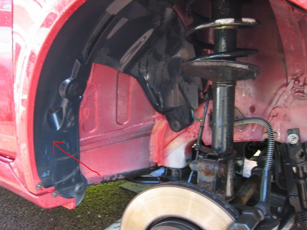

Having the swirl pot in the wheel well on the R26, means it was very, very noisy, so I used some self adhesive sticky pads. I removed the standard carpet, ( With the quite heavy wooden part.) and used a flat plastic tray that I found in the garage, glued carpet to it, to cover the wheel well, fitted some sound deadening, from wheel well to behind front seats, and around the roll cage, then covered with a KTEC mat. As will be going from N/E Scotland, to SPA in mid July 1200 miles, peace and quiet is very welcome. The whole lot weigh only a couple of KG more than the original one, well worth it.

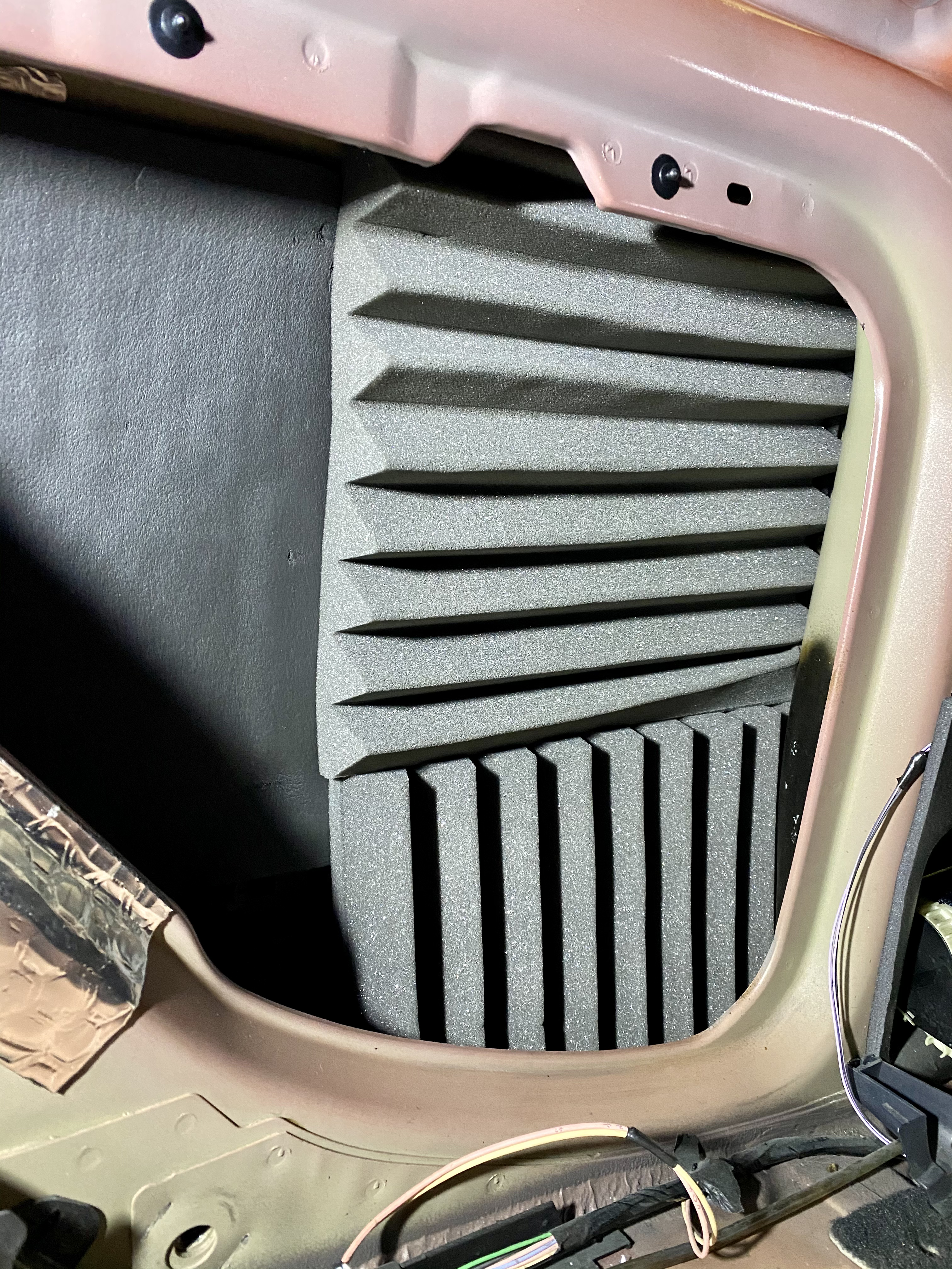

Got another hour on it tonight so did a bit more. I need to remove the rear bumper to modify the cabin vents. So that will happen another day. Carried on with the boot floor and also started playing with placement of the 35mm acoustic trap foam tiles. Managed to acquire a few of these and I think they will also help the sound from the rear speakers. They’re not fixed yet as I may not fit the tile below the rubbing strip as I do not want the chance of it holding moisture. So that lower tile I may fix to the back of the doorcard directly.
  Clio Sport
View attachment 1523642View attachment 1523643View attachment 1523644
If you are stopping the sound from outside they're the wrong way round..😂
frayz
I read yesterday for some time regarding orientation and sound direction. I just wanted to see if they made any difference. Hence why i said they're wedged in and not fixed just yet. They actually work both ways but are more efficient facing the direction of sound you're wishing to diffuse.
Plus they look cool this way for now :D
