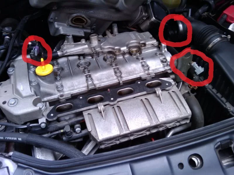

Is it just these three(circled in picture),Pull leads out of coil pack and Manifold bolts????
Will i need a new seal?
