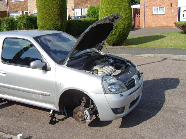

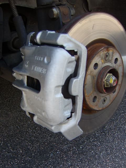

Here's mine whilst i was doing them:
Just did mine the same colour ^^
