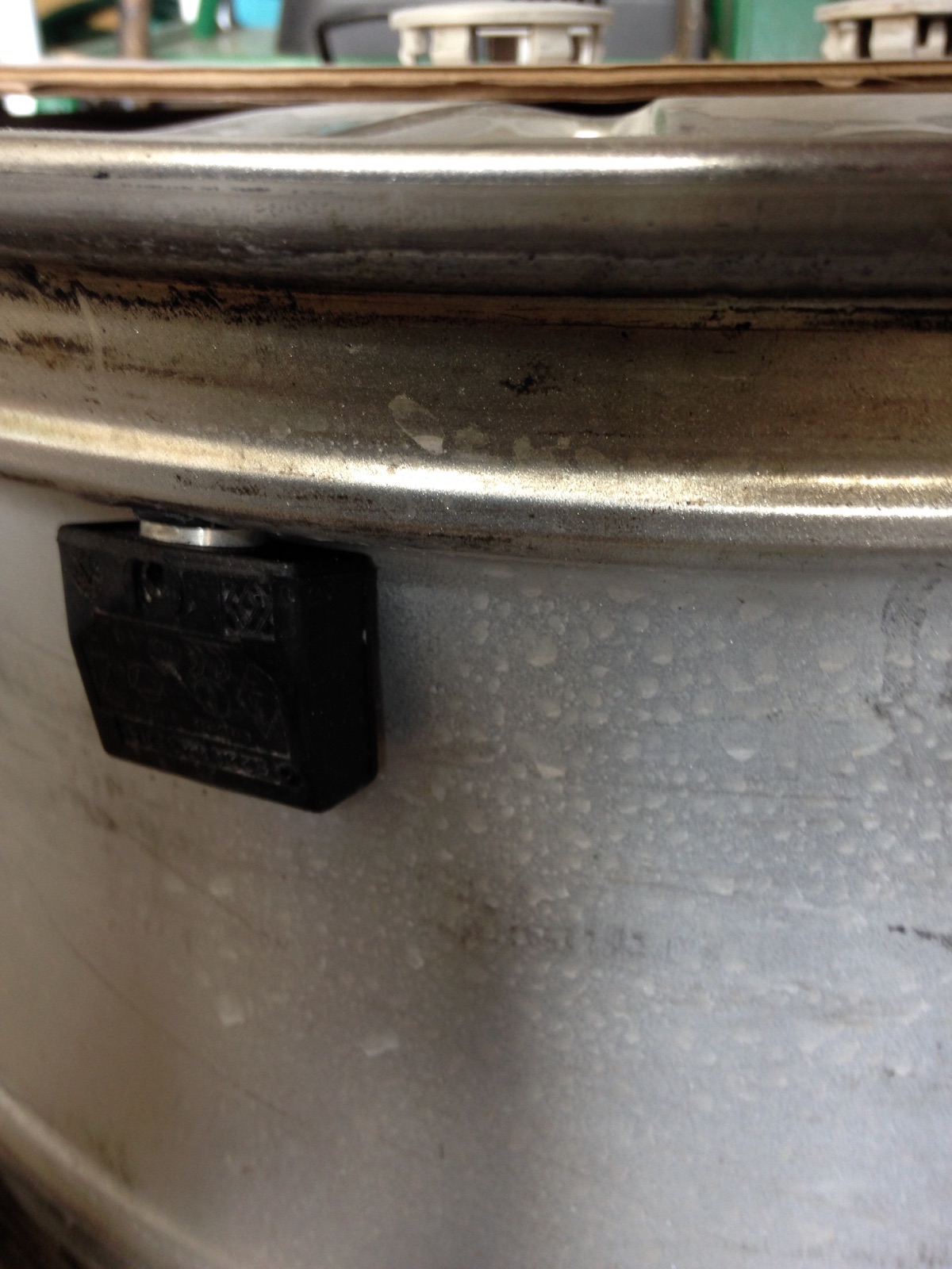

does anyone know how to remove tyre pressure sensors from laguna wheels? are they worth anything once they are out?

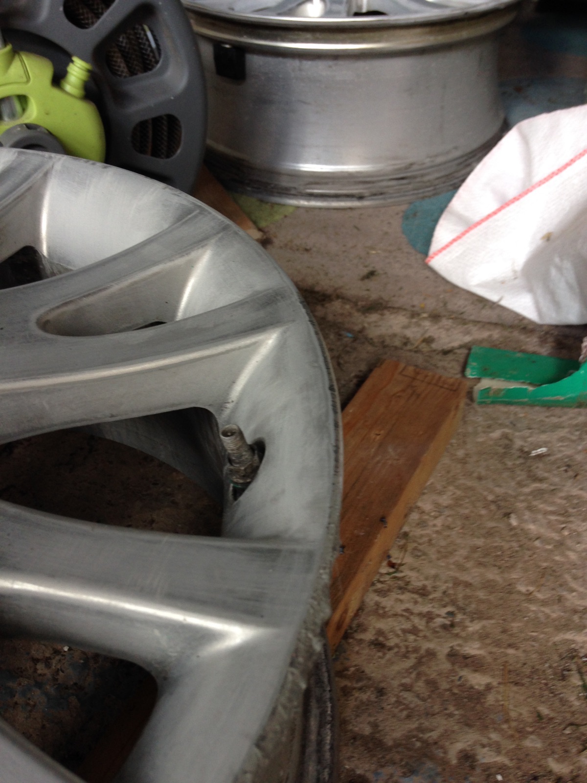

I have the tyres off and I am just taking them off a spare set I am refurbishing I don't have a tyre pressure monitoring system on my car just need the valves out

I have attached the images in

I'm surprised you have to ask how that comes off with that glaring nut staring at you!

Ok just an update on these I got 2, of them out with a knife, piece of wood and a hammer. There was a kind of resin/silicone holding them in got most of it out with the knife and then knocked them out. The 3rs one was much different as is seemed to be glued above and below to seal it on. Long and short of it I drilled it out. All the nuts were glued.
