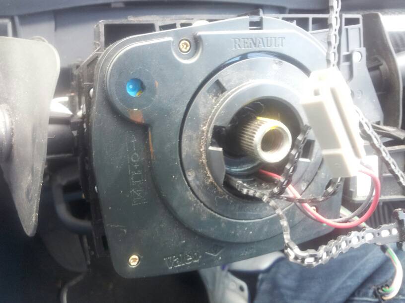

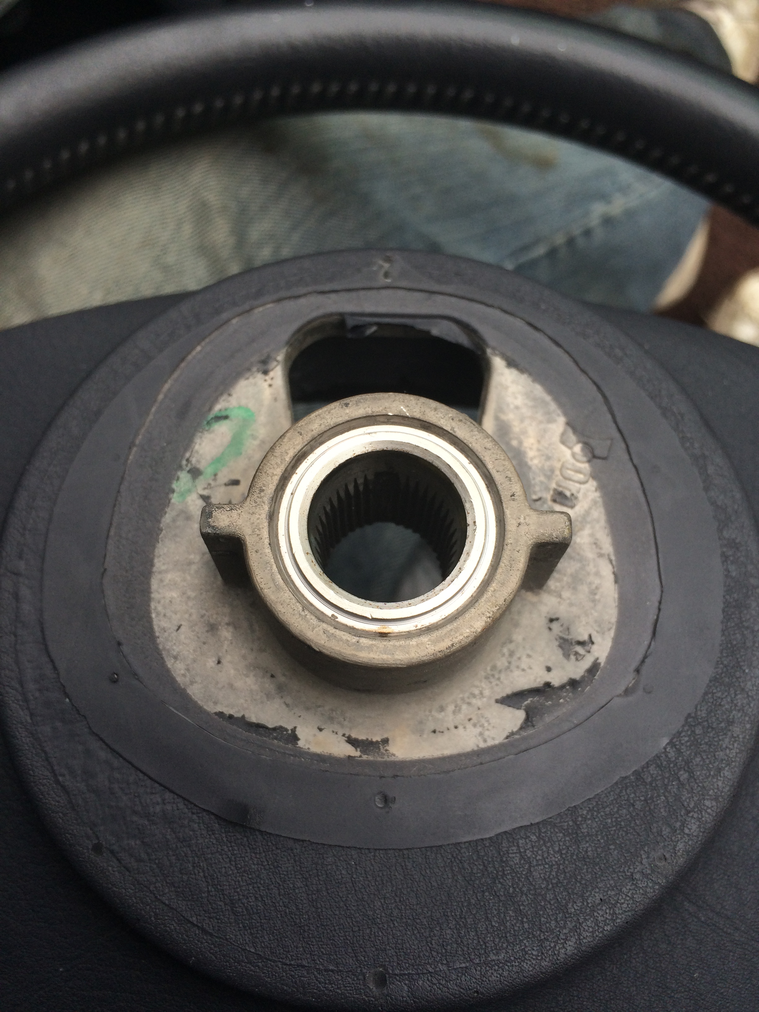

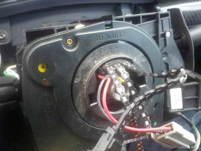

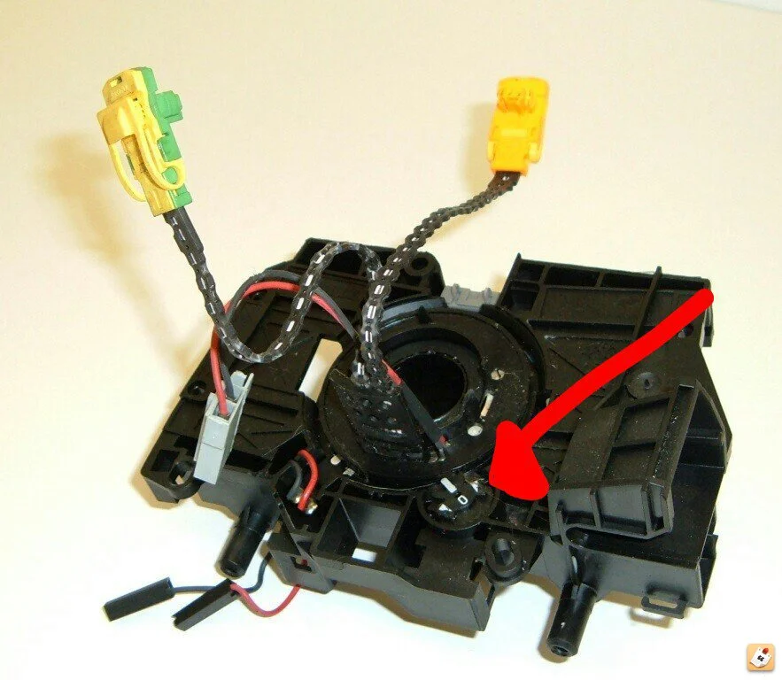

Take the steering wheel off and boss off. the black plastic squib thingy on the front has what looks like a spirit level bubble thing on the top left hand corner. Simply turn the centre part until the yellow patch moves back into the window.

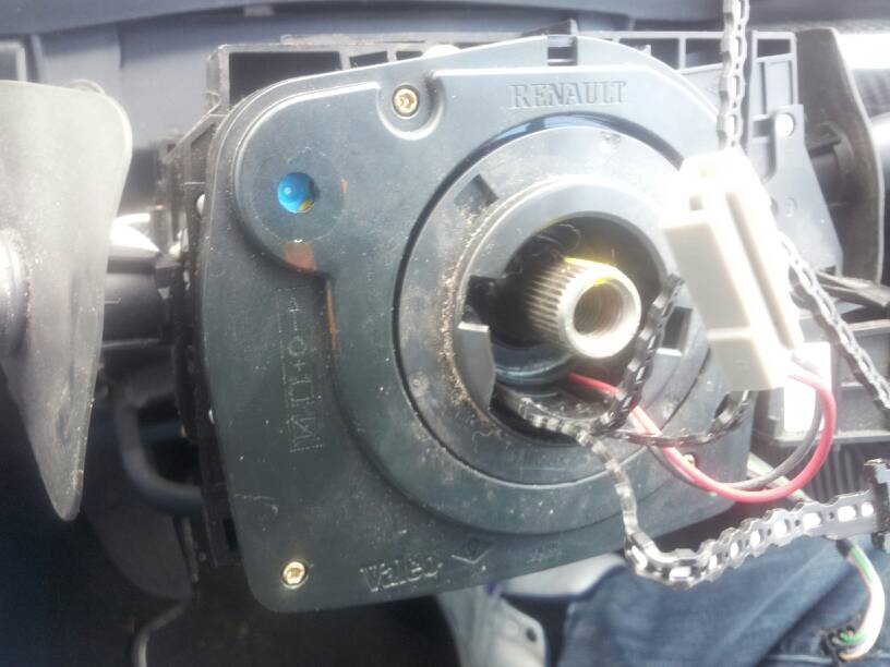

reset the steering sensor today by setting the yellow "0" mark to the center of the window (the yellow mark stays for 1 full turn so once the window goes from blue to yellow then go half a turn more and that is the zero point) has cancelled all the fault lights now so im happy.
At this point it changes from blue to yellow so as OP was saying do a half turn clockwise or anticlockwise dependant on which way you rotated it from.
Then the indicator stays yellow at the squib connections are central and no more errors or lights on dash.

So it has to indicate yellow in the left corner

Do the indicators cancel but not at the right? As this could be caused by the squib not being aligned properly.
Sometimes when the squib isn't aligned properly can rip the airbag wires from the squib and cause the airbag light to light

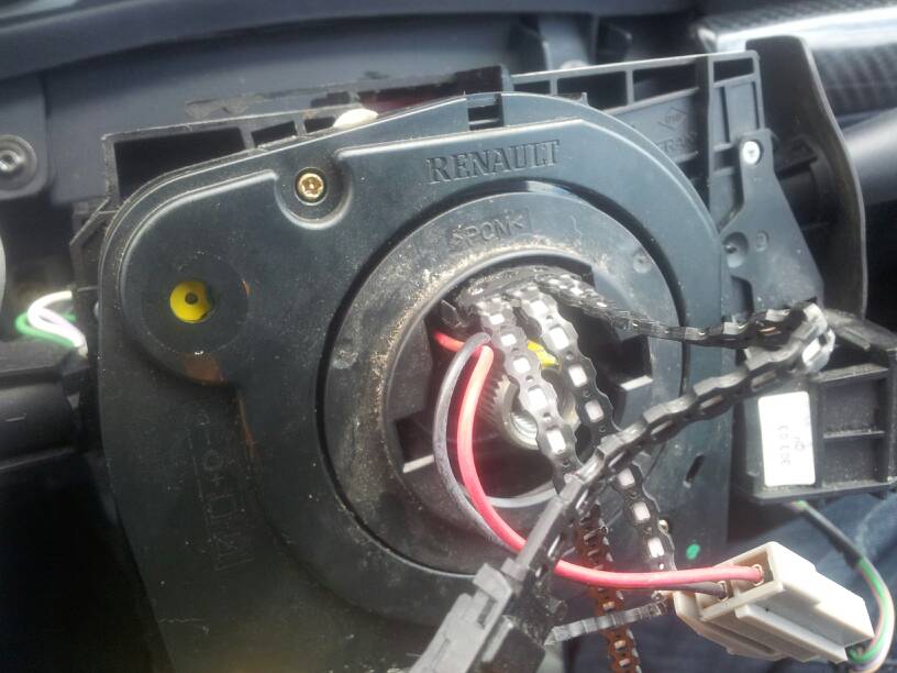

If the indicators don't self cancel at all you may need a new squib. I'll find a picture of the self cancelling part so you can compare.

This is the part that cancels the indicators.

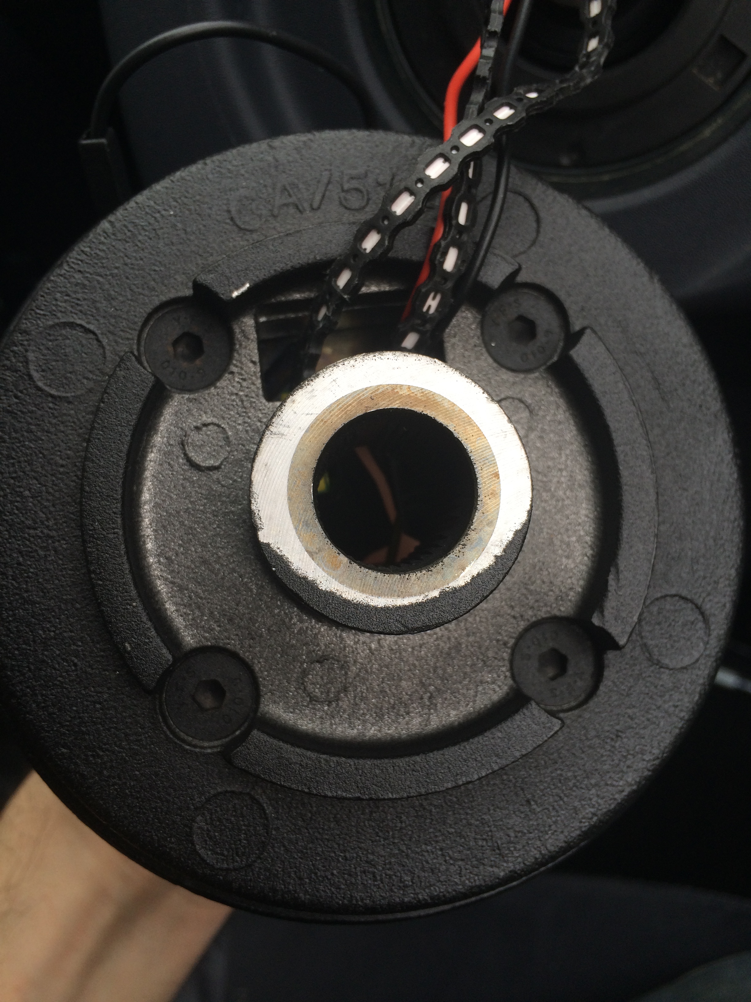

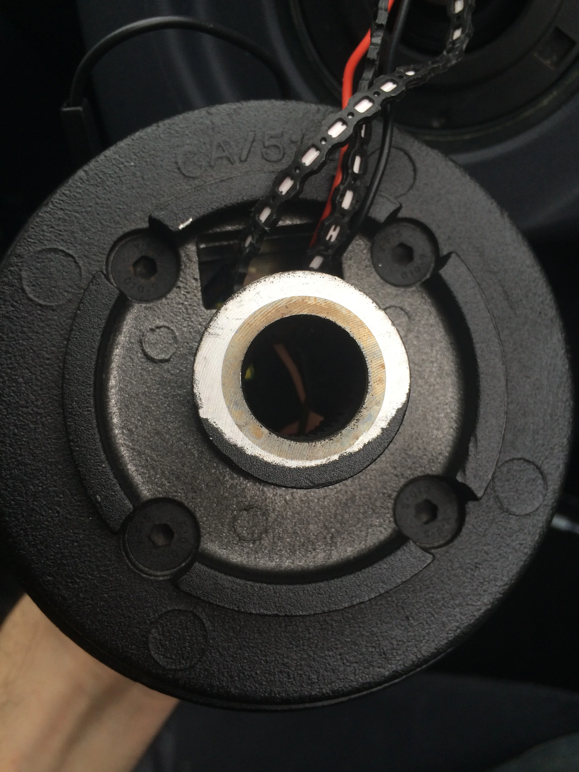

hi guys, hope someone can help, been spending a lot of time reading through all the different posts and still a little stuck.
Bought a OMP boss - pic attached
fitted with no problems, sensor still showing yellow and not moved. Drive down the road and traction control / service error appears.
Put the standard wheel back on, error goes.
Anyone got any ideas how i get this to work or have i just been sent the wrong boss? There is not lugs on this like the standard steering wheel.
Thanks

To fix this
Thanks
, if remembered correctly you need two resistors of 3.9ohms and plug them into the two airbag wires you remove from the original steering wheel (yellow connectors) and this should fix the problem straight away after about 30 seconds of being plugged in no need for a drive.
My bad
That will only fux the airbag lights, the esp light is coming on because of the steeringwheel position sensor
My bad I'm sure one of the ones we had in at work had the same problem when he fitted an aftermarket wheel and the owner said that is what he did to stop the ESP and Serv lights illuminating. Could have been talking about the airbag mind.
Does someone know if i can turn the sensorring as many turns as i will without any damage? or is it limitated same like the Airbag Ring?
It's limited to around 3 turns, count how many then set it in the middle not just when it turns yellow. Other wise it could be set +/- 180 degrees out.

I've recently had the same problem switching over my steering wheel and boss. First off I had the wrong boss as it had no tabs like the stock wheel along with a small hole to feed the plugs through. Removed this but in doing so it came off so quickly It ripped the plug ends off. New squib it was then. I then made the mistake of moving the steering angle sensor when removing from the squib. Unbeknown to me as you found out, it then unaligned. I then had the serv, esp and abs lights come on. Without trying to guess it, I bit the bullet and paid for an auto electrician to plug in and alter it for me. It's quicker and easier that chasing your tail. I hate lights on the dash so this is the easiest fix but at a cost obviously. Now I have a light free dash.
Anyone know if when recalibrating the sensor (by moving so you have the yellow in the bubble), whether or not you need to unplug the sensor cable first?
I’ve tried a few times with the battery disconnected but with the steering angle sensor still connected, connect the battery back when happy with yellow bubble and the ABS and ESP lights remain on...
