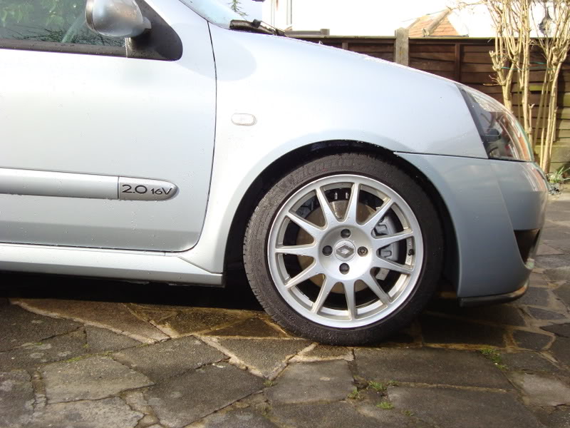

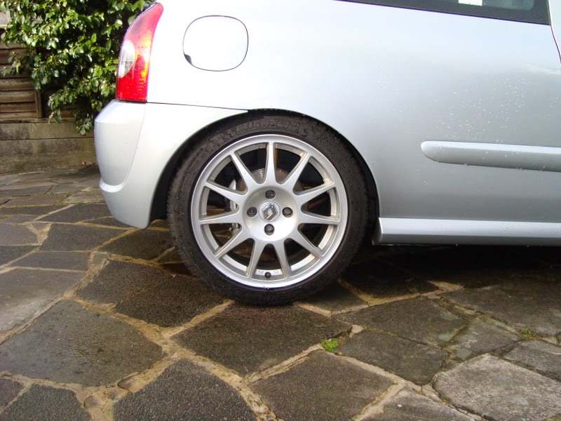

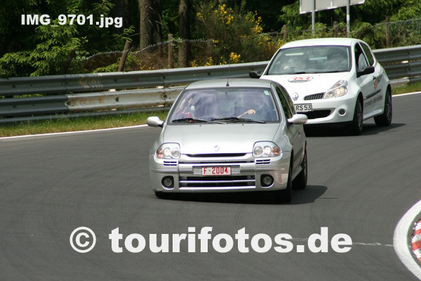

Does this look like a lot of bodyroll?
photo of the car with its current drop of -35mm front and -30mm at the rear:

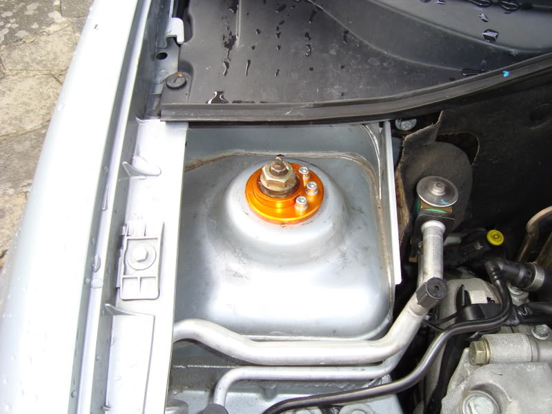

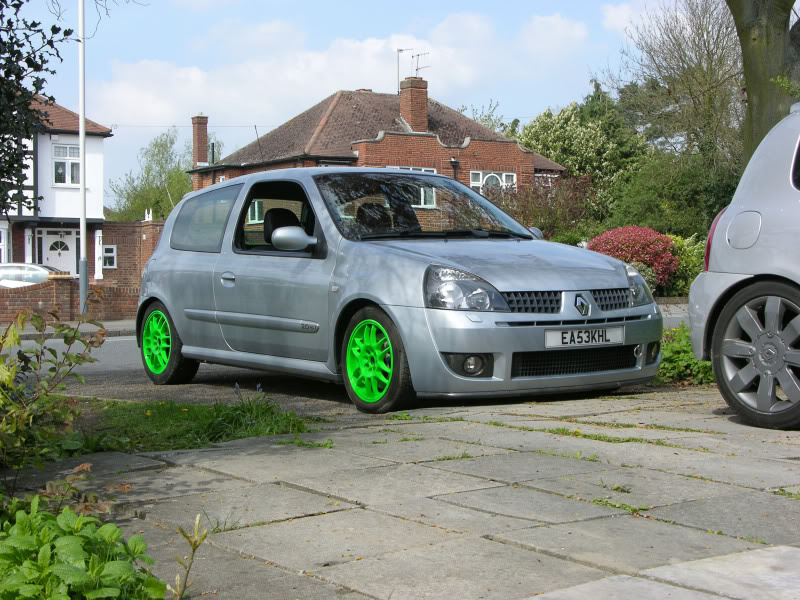

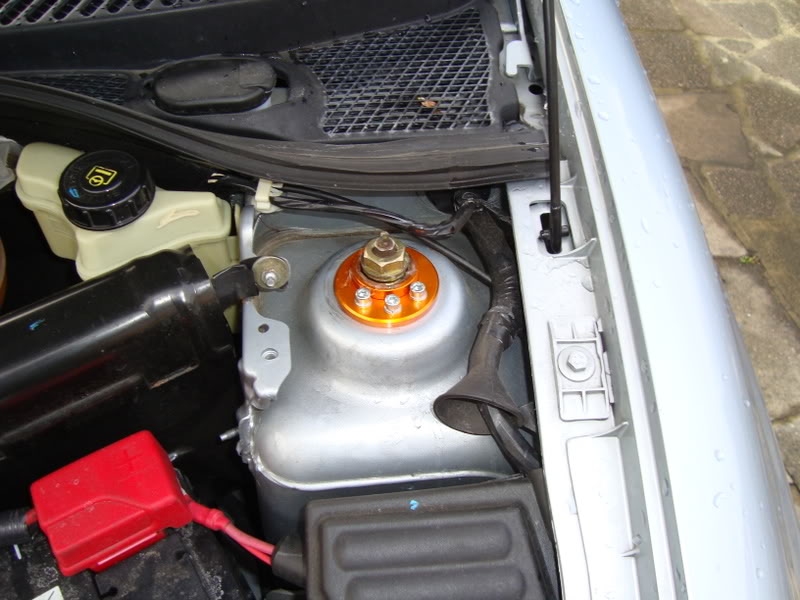

I have KW V2's on my Cup, Not sure how much its been dropped by at the front but the rear I have removed the "Adjuster" rings and just have it sat on the springs.
Mine is a Daily driver with odd track day, and as I am lazy I just have the damping set to hardest setting. Did RAF Marham with this set up and it handled well and seemed to be very neutral.
On my 15" Track wheels -
On my daily wheels -

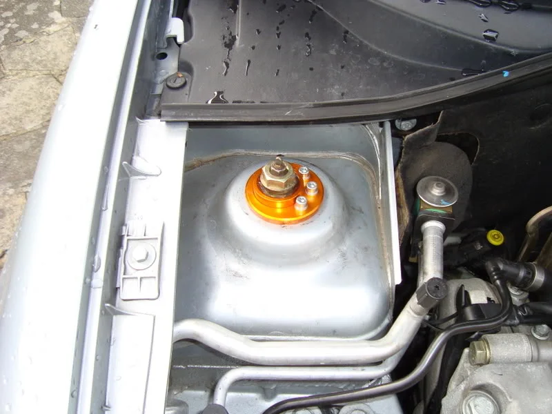

Need to get them re-set up as Daz pointed out the company who set mine up cocked up with the camber Bolts and Top mounts so my camber is a bit unbalanced.
  106 GTI
The top mounts facing like that wont matter, by all accounts each side can run a slight difference in camber so it seems they are set like that to be even

Looking at your pix it does seem like my front is too low relative to the rear, as I suspected (front seemed too bouncy) :)
With my ride height a bit higher I probably have a softer spring rate so I probably need a slightly softer damping too?
