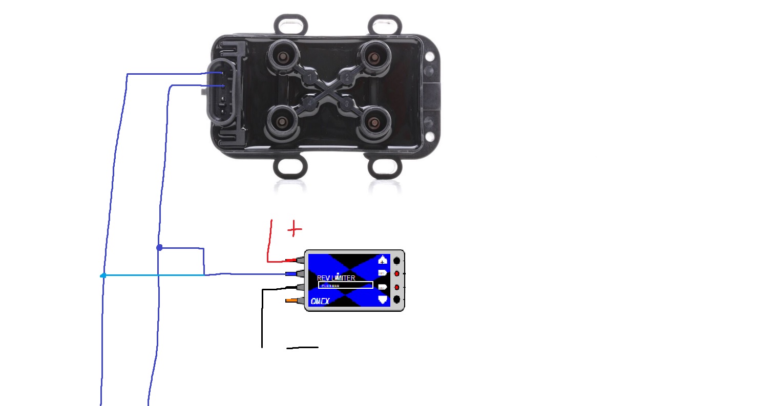

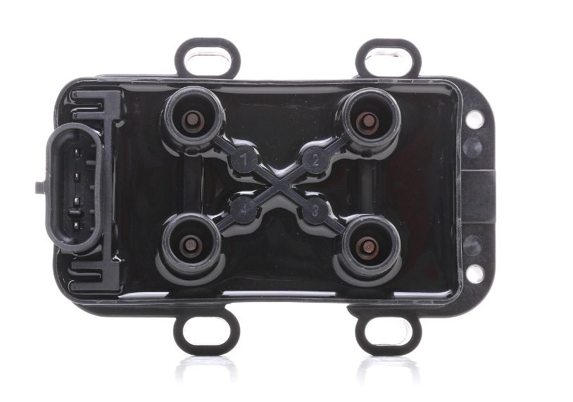

Hello all,
For this engine, do I need the single or twin coil version?
My coil pack has a 4 pin plug. Which one do I have to connect to the Omex?
Any help will be appreciated!
Thanks in advance.

[SOLVED]
It's the twin coil version.
Works perfectly fine and the sound is amazing! :D
Diagram attached.
(I solved this last year, but forgot to post here).
