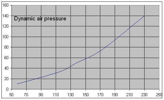

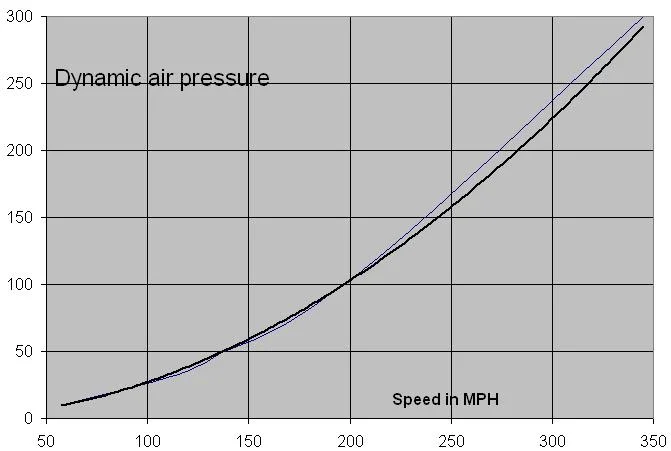

To find out the drag multiply this equivalent frontal drag by the dynamic air pressure at the speed since the faster you go the more the more the drag this dynamic air pressure isn't constant.
At 57.5mph = 10
At 115mph = 33
At 138mph = 50
At 172.5mph = 75
At 230mph = 140
(See this and this for a spreadsheet graph to get accurate value for the dynamic pressure over a bigger range)
