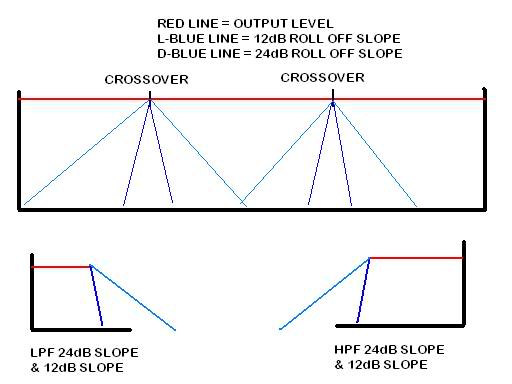

A low pass filter only outputs frequencies below the set level.
A high pass filter only outputs frequencies above the set level.
Filters are used to limit frequencies any given speaker will play....
You use the LPF to set the upper frequency you want your speaker to play...
You use the HPF to set the lower frequency you want your speaker to play...
These filters don't simply cut off frequencies, they have a gradual effect which is termed the 'Roll Off Slope'....The most common slopes used are 12dB and 24dB...
A LPF set at say 80Hz will still allow higher frequencies through, but as the frequency increases the output level diminishes....
This is why when initially setting amplifiers you opt for a LPF set at 80Hz and the HPF set at 100Hz. The missing frequencies will still be played, but by both speakers, which in theory will allow a seamless transition from mid driver to sub....
This is only a brief explanation, if your considering running active then a more detailed description of exactly whats what will be required.....
