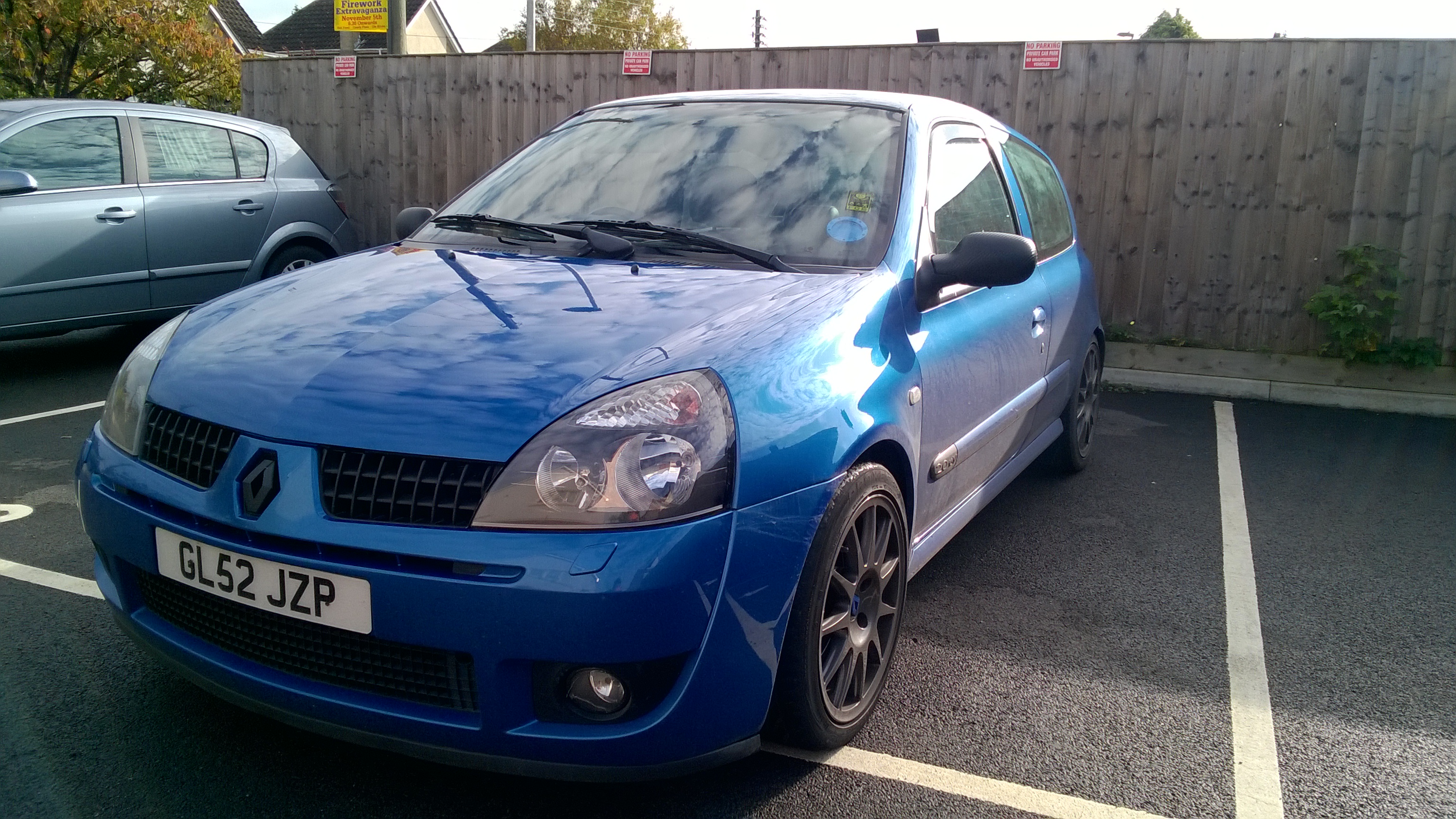

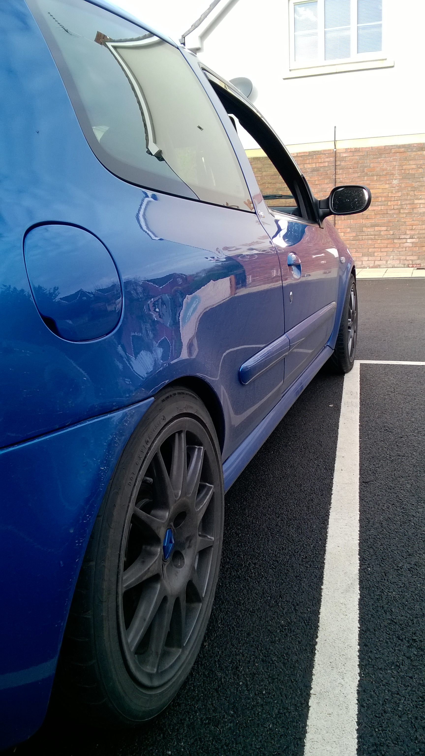

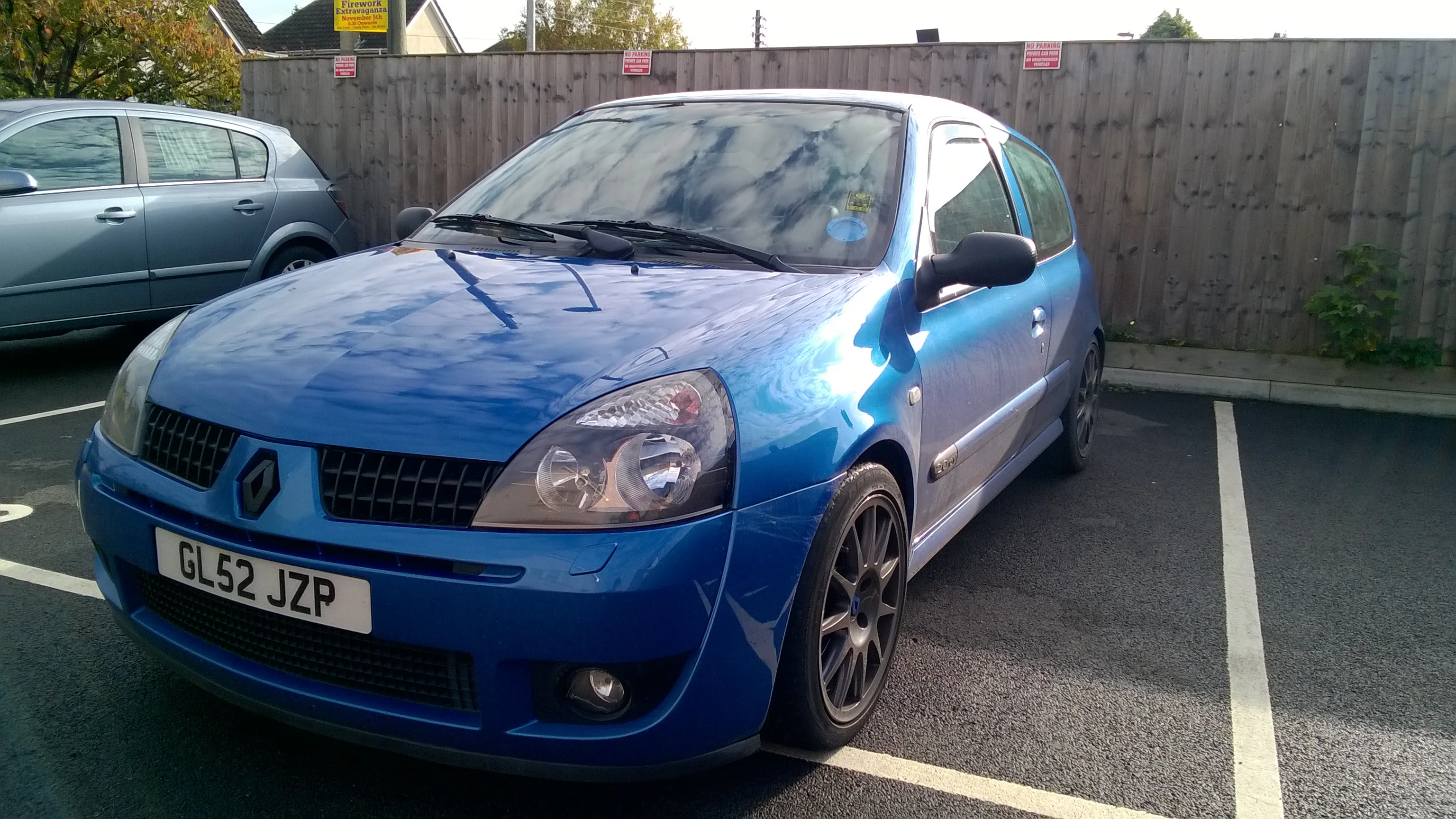

I've just fitted spacers yesterday after some playing about. The fronts were no problem because there is loads of clearance. The rears took a little longer to sort. I have a 172 cup lowered on eibach sportlines by 35mm. The only spacers that would clear the arches were 10mm non hubcentrics. Tried 25mm first and 15mm second. Both times had bad tyre scrub. The 10's being non hubcentric isn't a problem as the wheel sits on the spigot off the the rear disc thereby offering some support rather than just using the wheel bolts which you don't want! Don't forget you'll need longer bolts for non hubcentrics. The standard length(smirk) is 26mm iirc plus your spacer width. 60 degree fixed head as well. I have 25mm hubcentrics on the front. Here's some pics and yes I know it could do with a clean...
