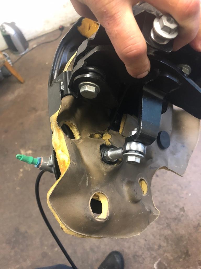

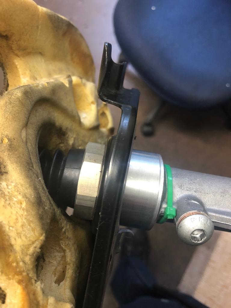

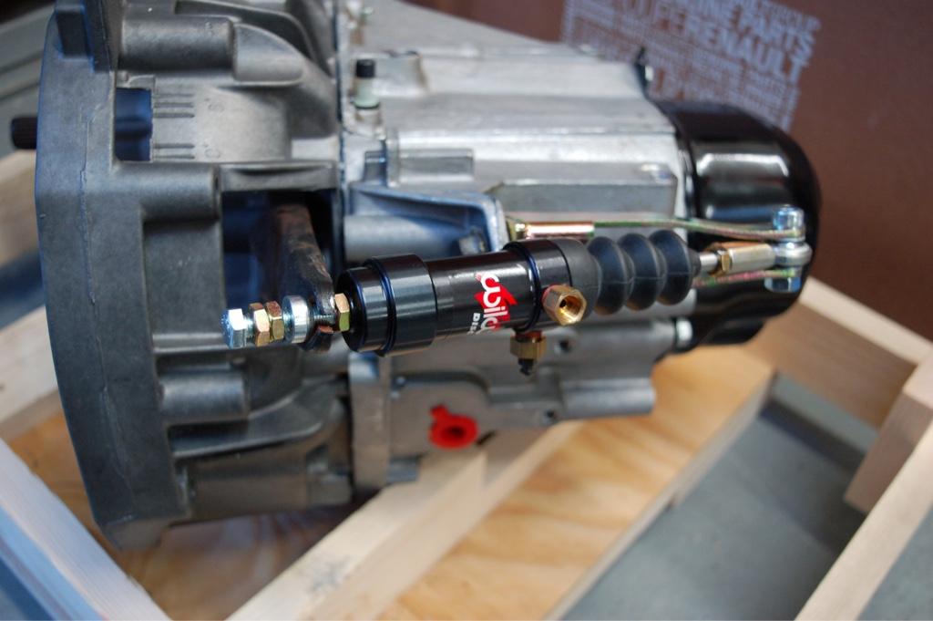

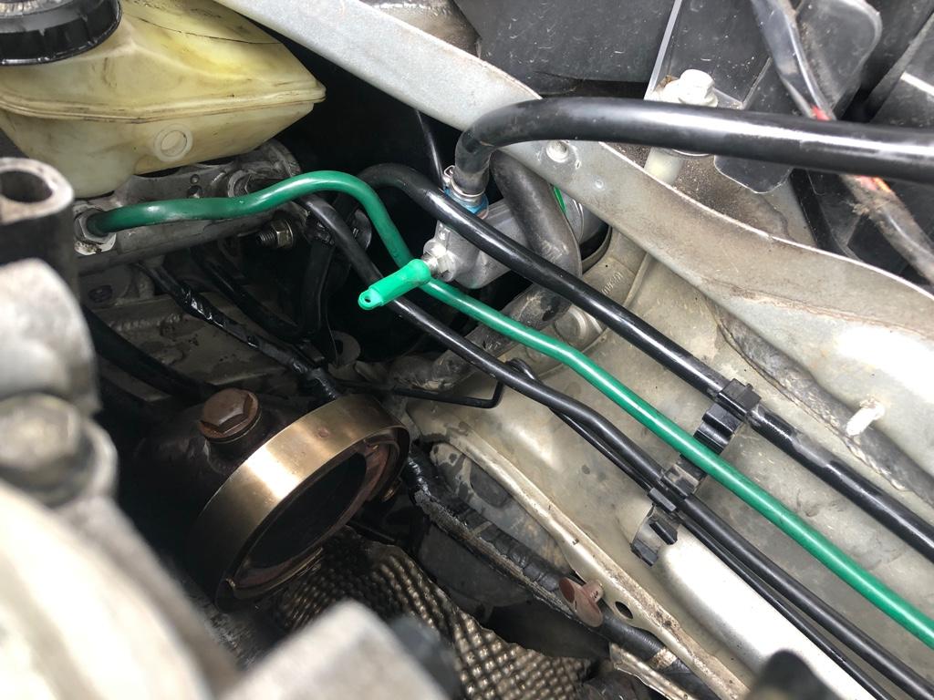

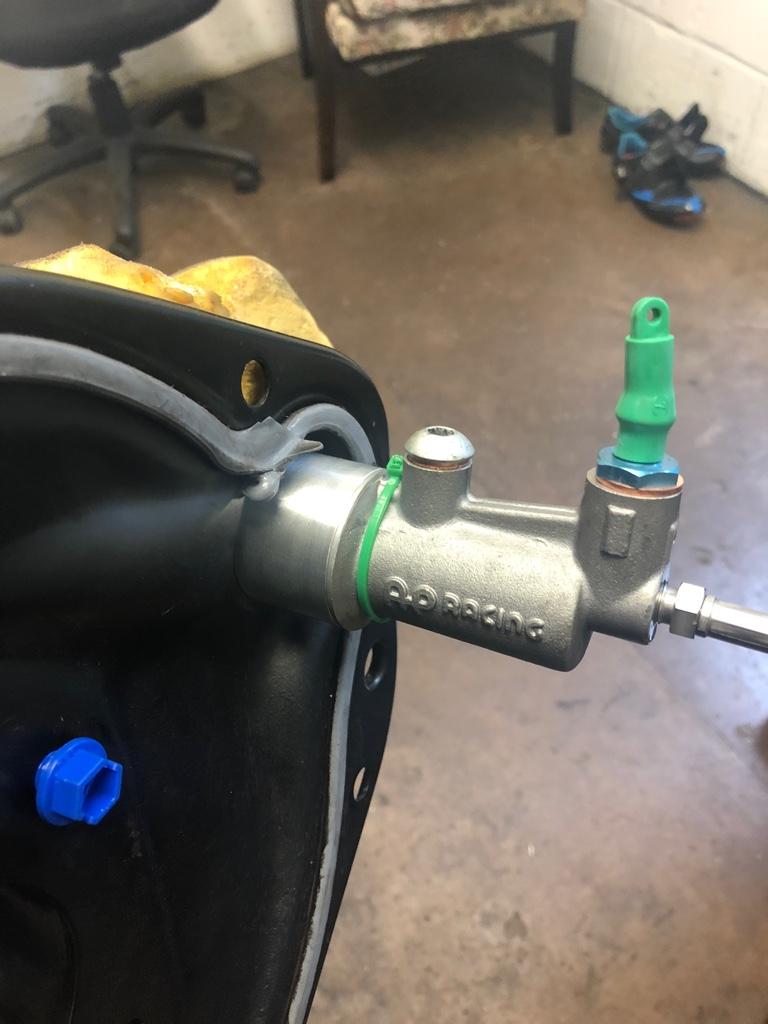

Hi mate, I used the pure motorsport Wilwood pull type slave cylinder and bracket.. I used a dci clio hydraulic pedal box with an AP racing bulkhead master cylinder with custom fixings to the pedal and to fit the pedal box.. also a custom line. It’s not the lightest clutch but I run the Sachs performance clutch so that doesn’t help.
