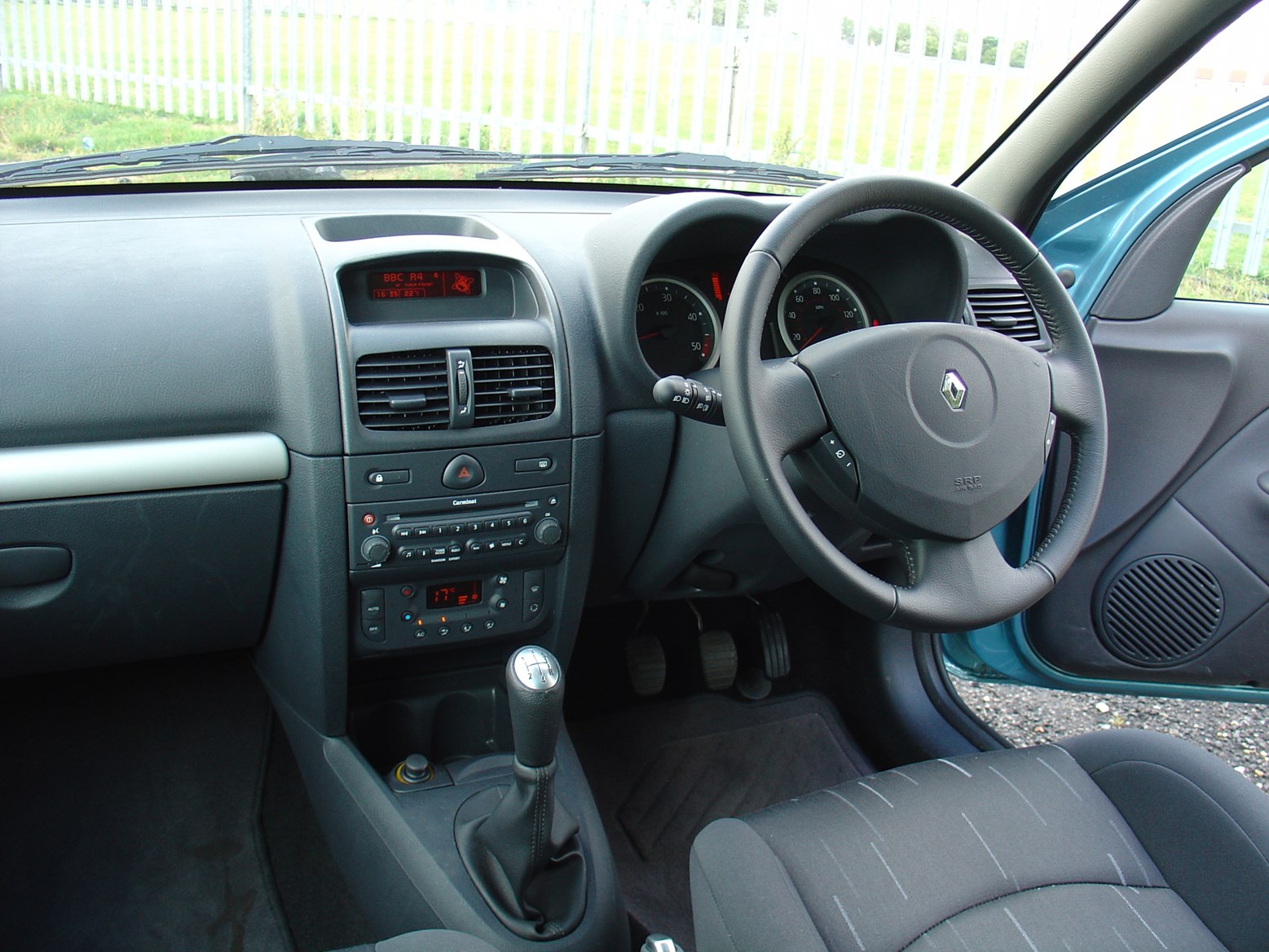

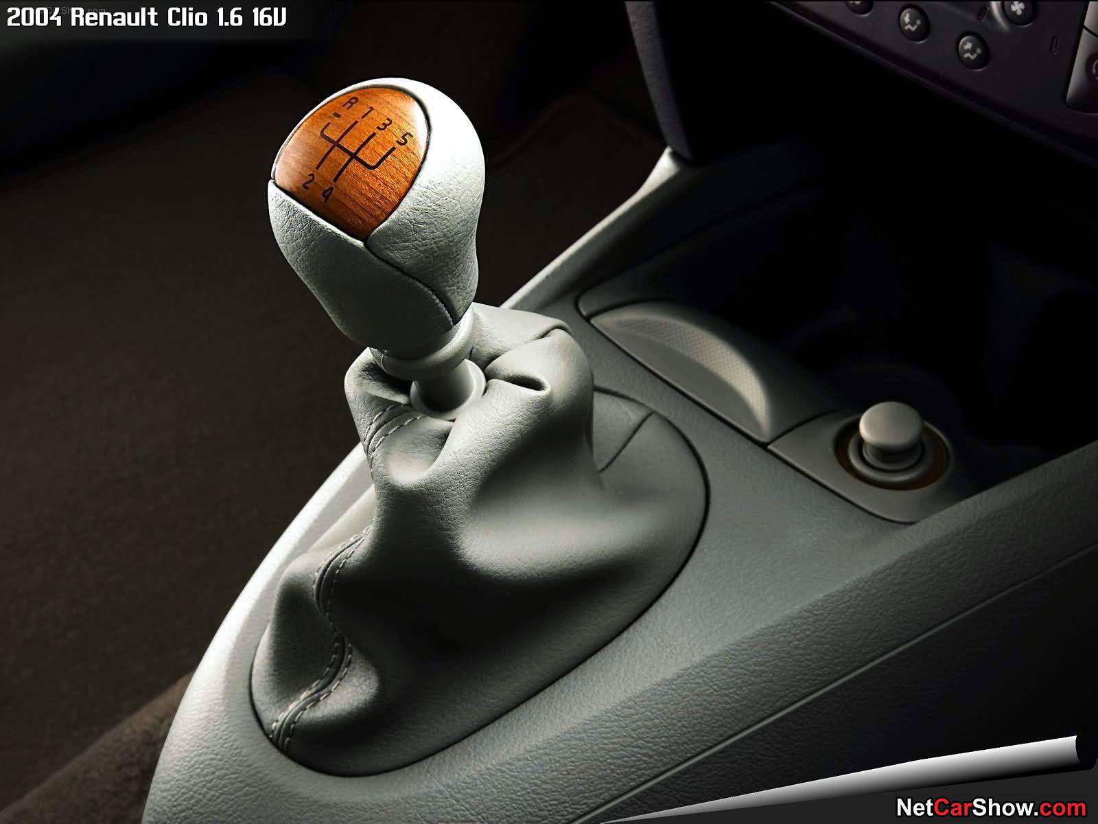

The DCI 100 had a hydraulic clutch and the later DCI 68's (mostly vans) had them too.
If it has this shape gear knob its a cable clutch:
And this shape is a Hydraulic clutch:

Tank you Martin, gear knob shape difference is a nice hint making finding the right model way easier!! Thank you a lot!

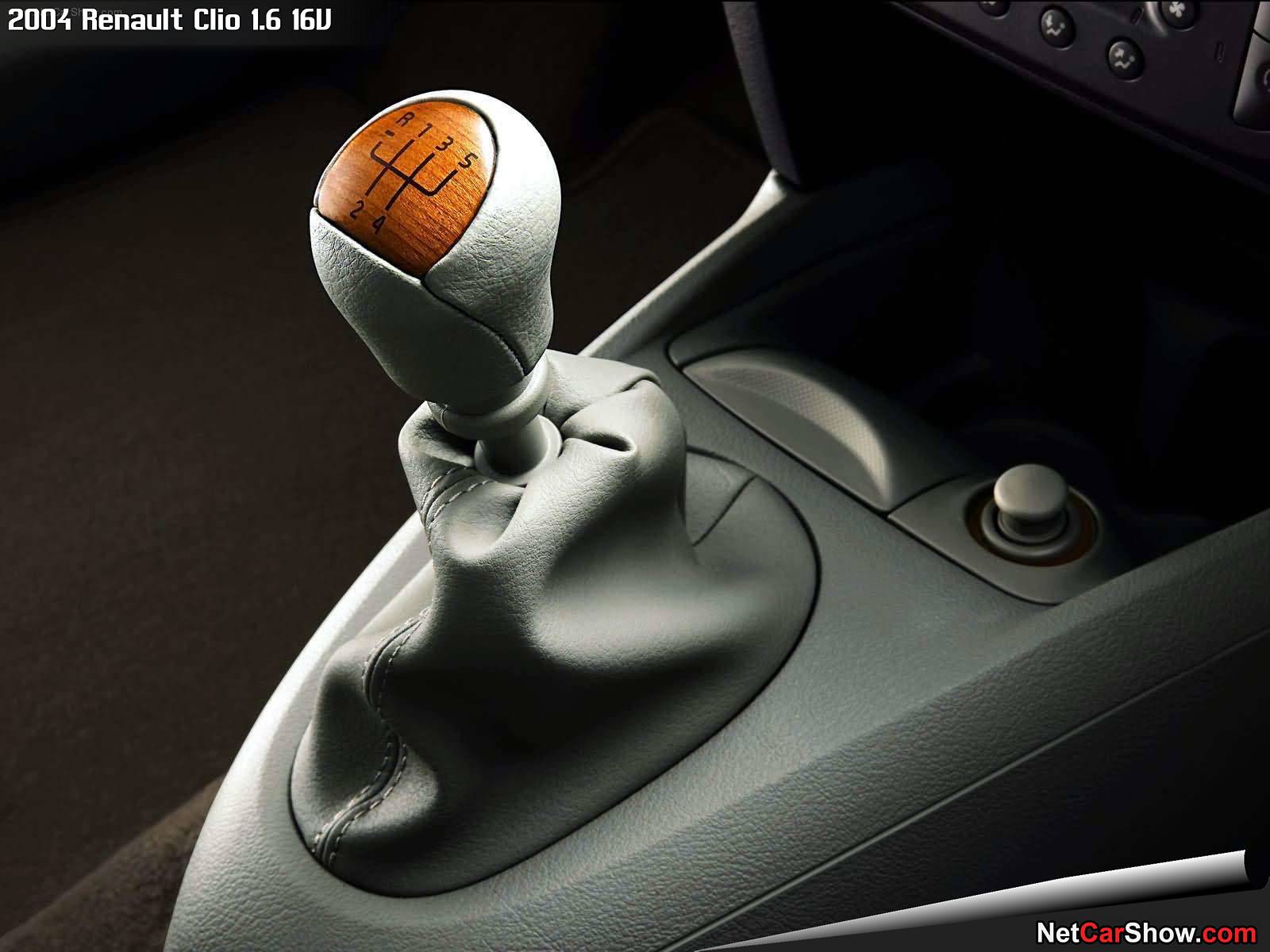

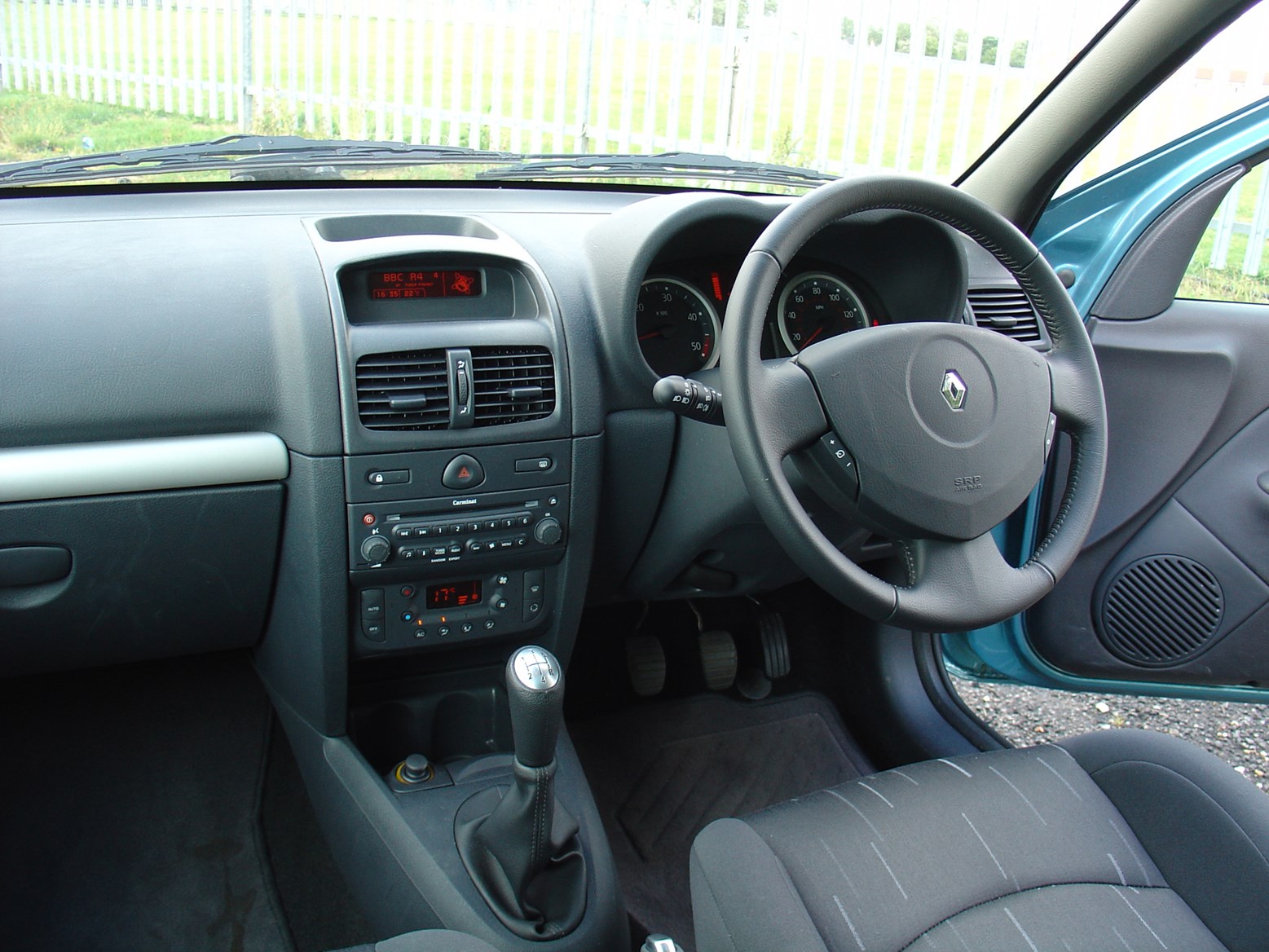

Twingo mk2 with the 1.2 TCE (GT/Gordini) also uses the same gearbox and clutch so parts from that MAY fit and be easier to find
