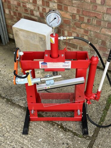

I have this one, and it’ll put Renault Clio 182 cup ones in fine.
Getting them out you’ll need to get creative… I had to run welds on the bearing races before chucking it in the press and the bearings exploded out.
I’ve seen someone use this one before and eventually modded it, welded all the joints up, added some bracing and chucked in a bigger bottle Jack.
I’d go bigger than a 20t if you can, but it’ll do some work, if you have access to a welder and heat to get you past the stubborn ones.

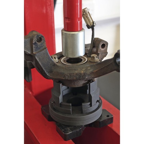

The cheap cup sets you can buy are very handy and a support plate like this looks dead useful
I don't have one of those but keep meaning to but one as some hubs are twatish.
