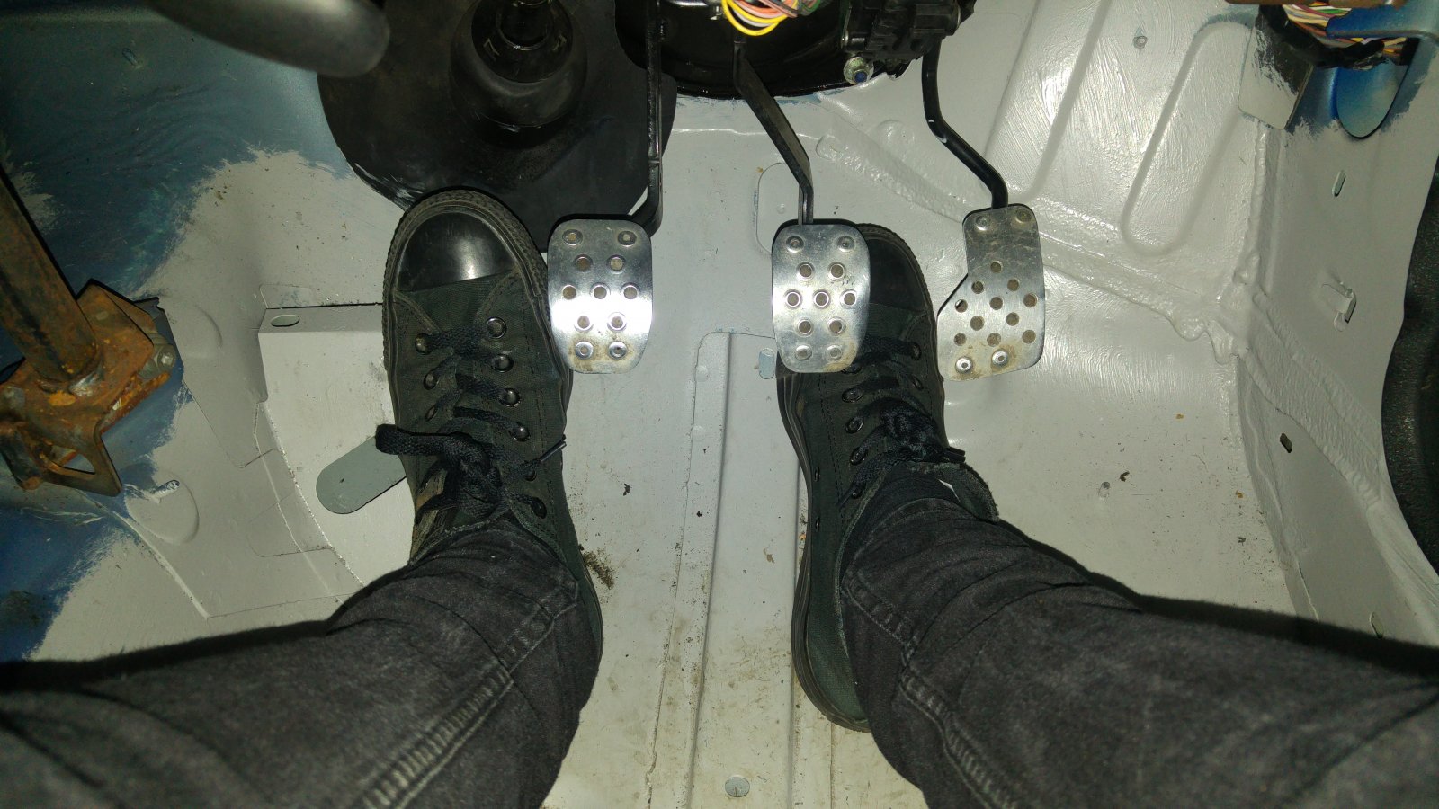

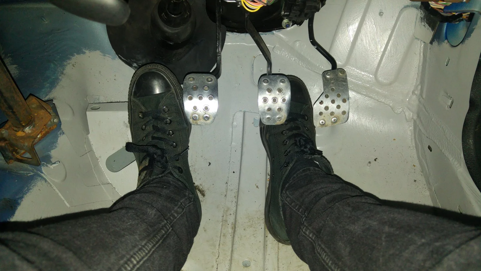

This shows where my feet are lovely and comfortable. Imagine left foot is clutch. Right foot is acc pedal.
Your photo (with description) makes it all clear. The standard brake lever is very much bent to the right - as made by Renault. Straightening it will move it to the left and reduce the side leverage and increase stiffness (the opposite to what you were fearing above). The other pedals have much lower forces applied, so you can bend them to wherever you want.
