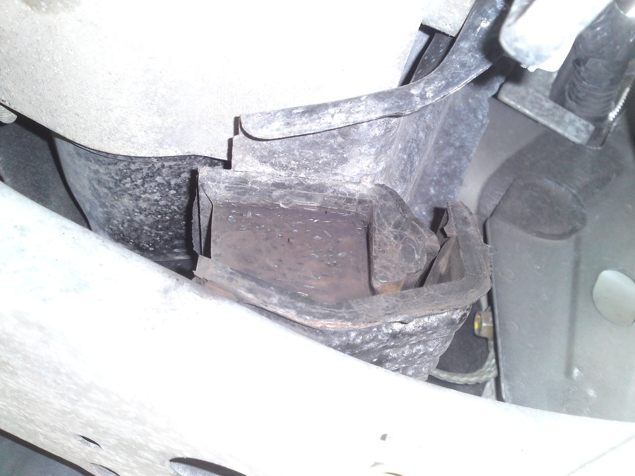

4.yes common upgrade, i beleive later ones had them as standard anyway, although it still has gearstick rock, the best mod to cure this is the 4th subframe to gearbox mount at the n/s, subframe needs a hole drilled.
Martin_172
@Martin_172 thank you mate. :)
Do you have a picture of this 4th mount?
http://www.ebay.co.uk/itm/Clio-spor...329?pt=LH_DefaultDomain_3&hash=item5b0c852529
it sandwiches between the gearbox and the subframe

yep thats the one, ive got one for mine but yet to fit it, ive got 3 brand new genuine mounts on it and it still rocks!, all dat torque!!!

That forth mount is a good addition Dan. Pics in my thread somewhere.

  Clio 182
I bought my car 182 had a look underneath and saw an extra mount, i though it was weird.. But now i know
When i bought my 182 it came with this little mount! Is it normal on 182 or is it an upgrade
