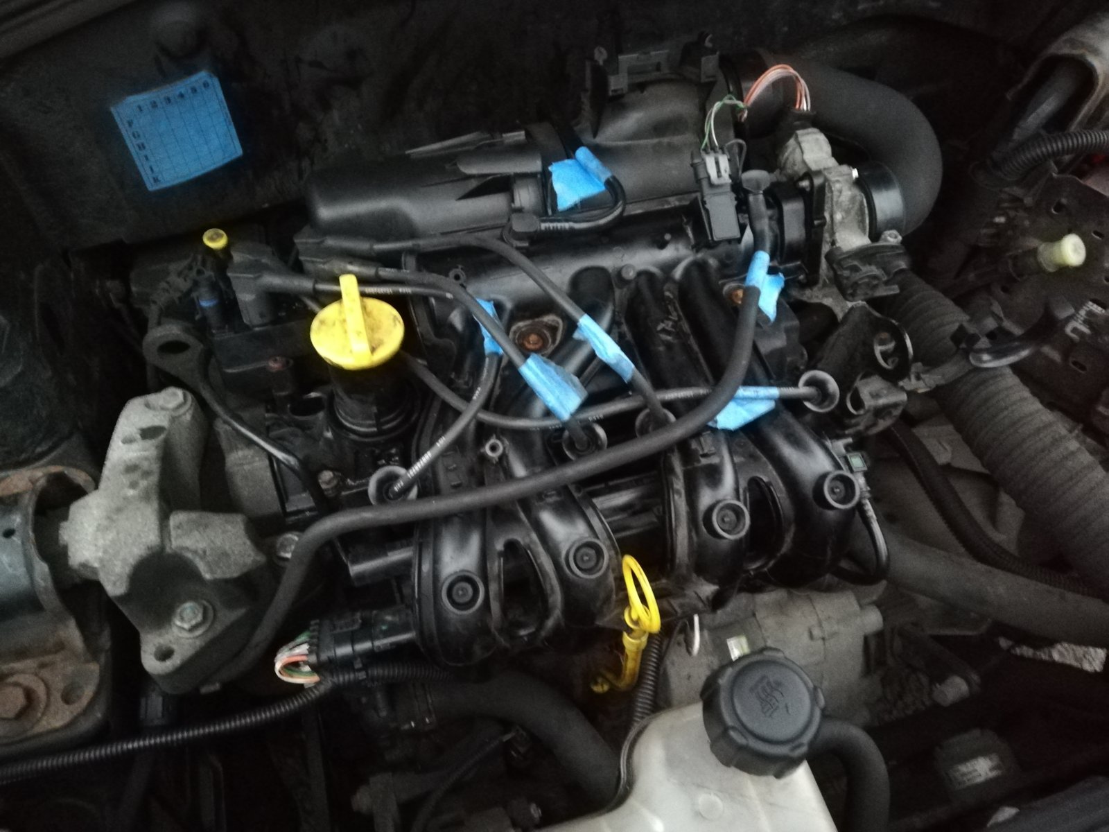

So.... My precious little 1.2 Reno Clio Campus started revving low on idle last week.
After a look around i decided it must be the MAF/MAP sensor... give it a little clean, maybe replace it. no biggie this car has been amazing over the 10.5 years I've owned it little senor here or there nothing to worry about.

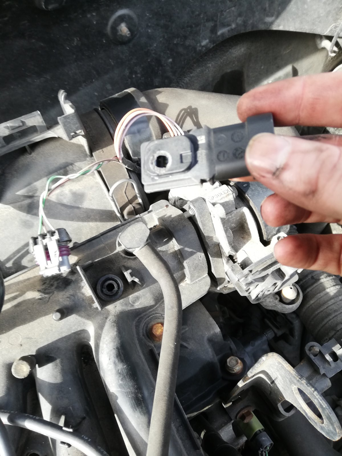

So i gets my carb cleaning spray and i have a go... except the top sensor wont budge, "odd" i think to myself, because in the YouTube videos it comes away easily, maybe I'm not doing it right...
So i give it a wiggle, and most of the sensor comes away- the probe end is stuck in the top of the engine- it snapped.
"No problem" I say I'll just get a pliers, pull the last bit out and pop a new one in....
So as i look at the probe end with my pliers, it just magically falls out.... into the air intake!
Now I've tried fishing it out with a wire coat hanger, I've tried enticing it out with a bacon sarnie (didn't work) and I've tried prayer... so i ask you my lovely forumites....
How do i get the top of the manifold off?

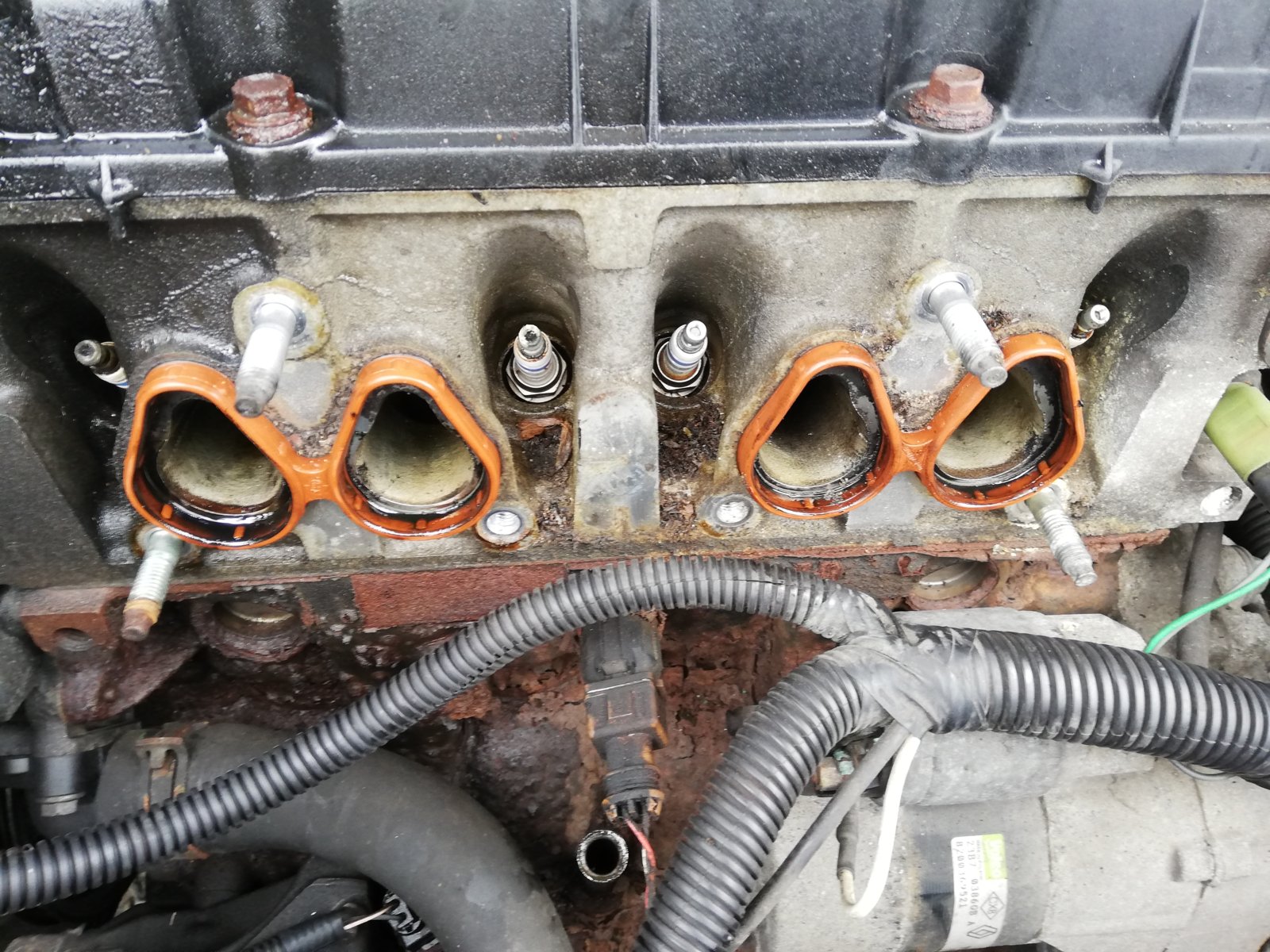

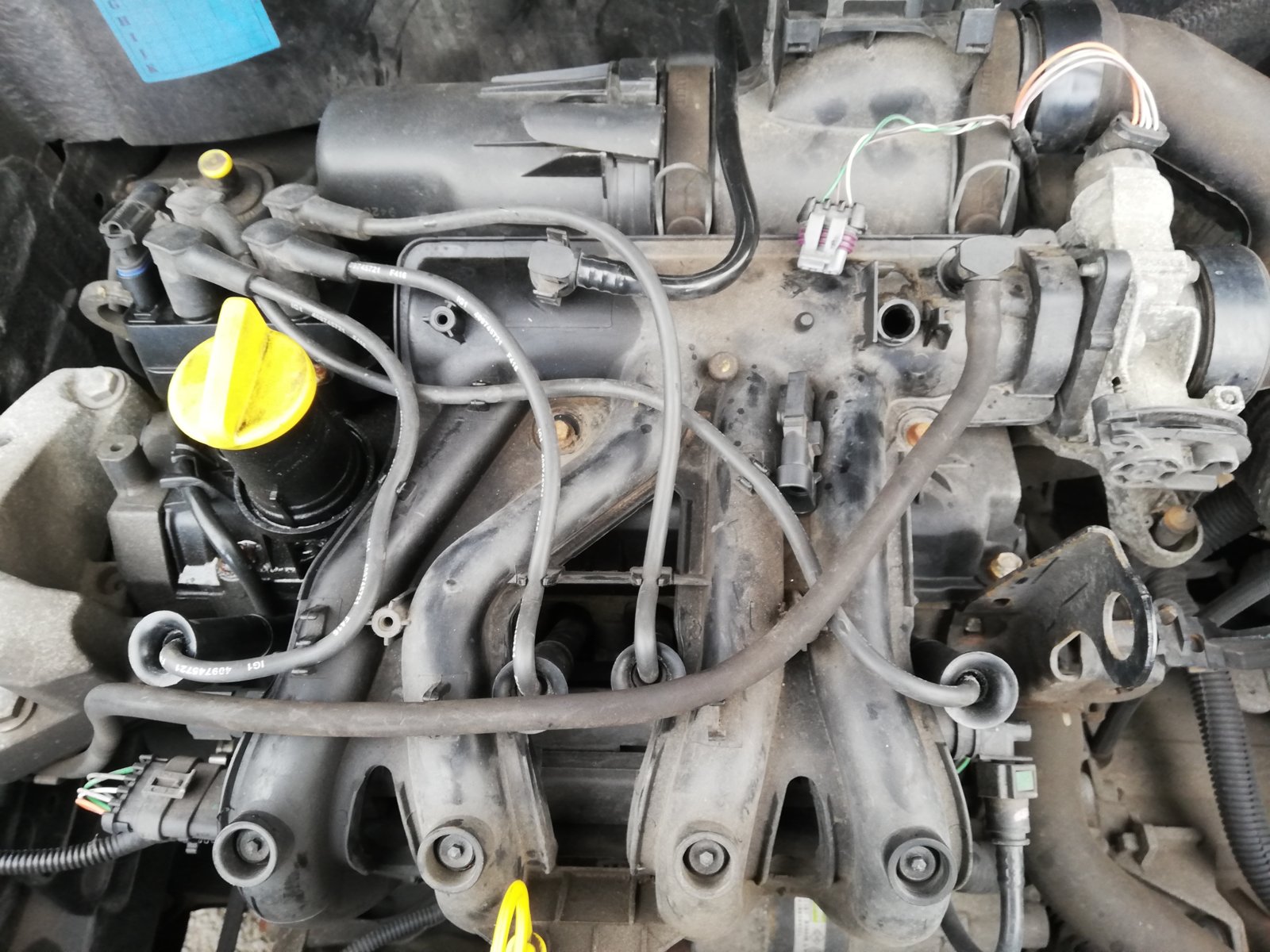

Unclip the airbox and just follow the 10mm bolts around the manifold and i cant remember how many there is but there is a good few of them 10+ maybe.
Its a totally doable job dont let it beat you.
Once youve found all the bolts the manifold will come away with no effort. If you pull and it doesnt come away its 100% because there is a 10mm you have missed.
  • Like
Reactions: Gus

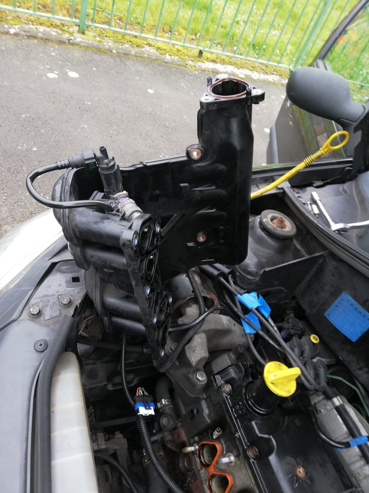

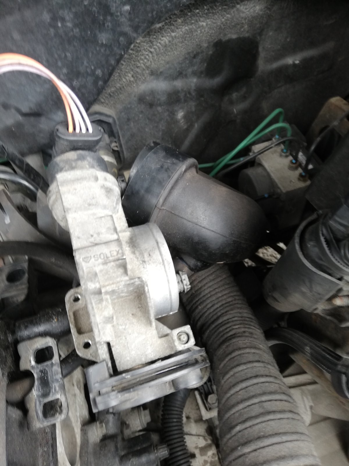

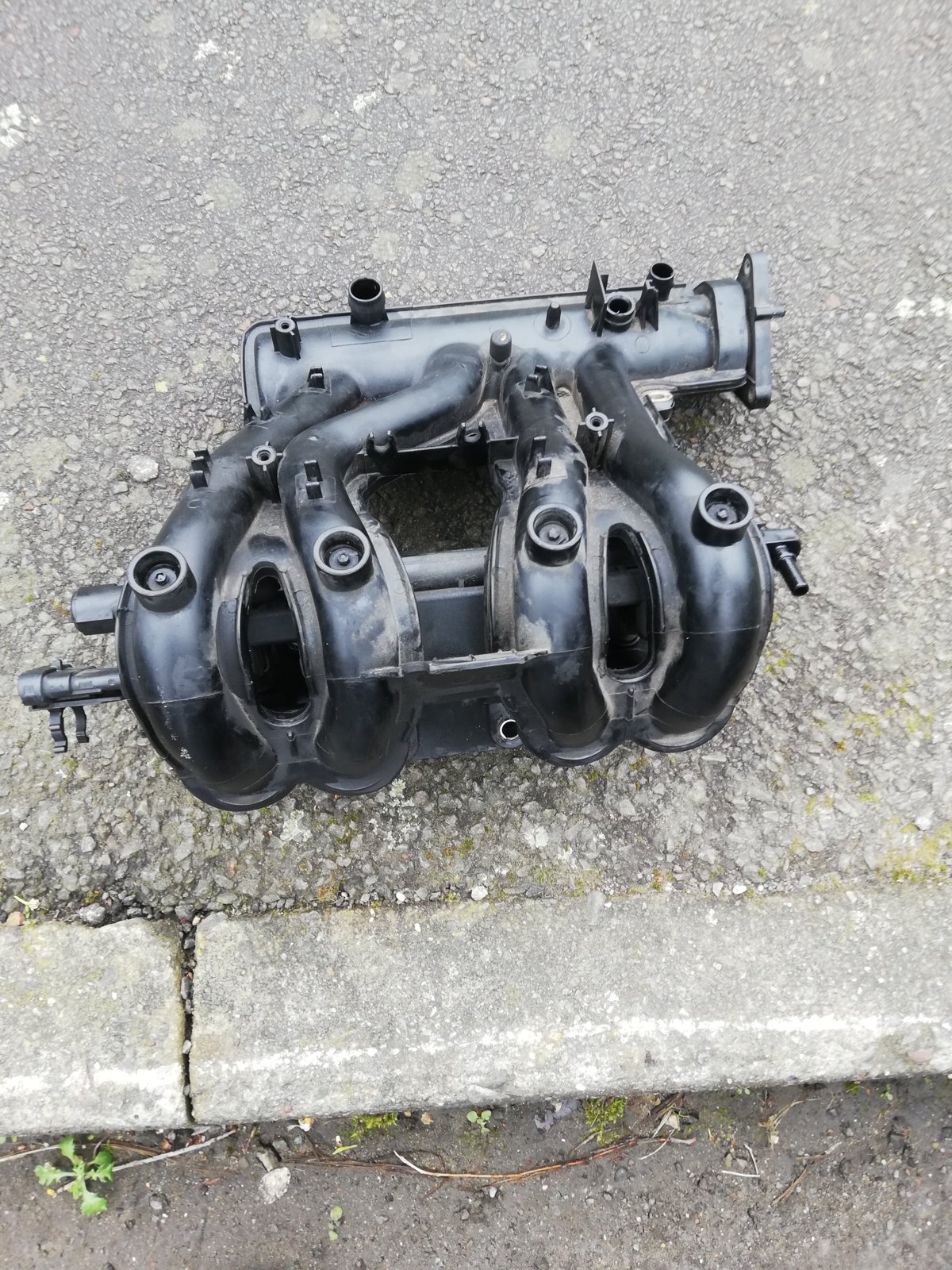

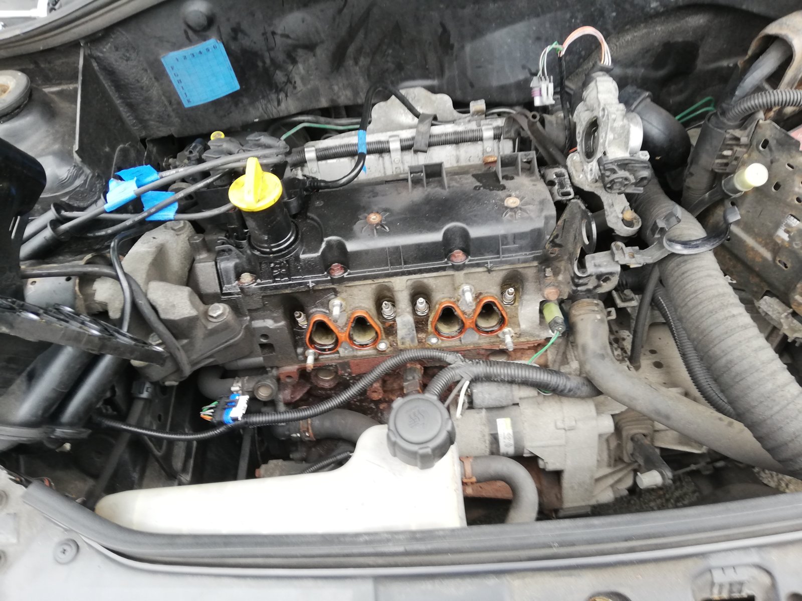

Riiiight so as per the pics, I've got the manifold off...
No sign of the sensor probe!
It didn't go into the throttle.
It's not in the cylinders and I've had a look and they are mostly in the "up position".../
It's not in the main tube, that's empty and I've pushed a long usb down each of the branching tubes... no resistance or snagging... where the hell did it go?

Hoover in the cylinders, it can only be there if not stuck in the inlet
It worked... SHE'S ALIVE.
ALIVE I TELL YOU...
MWHAHAHAHA, THEY SAID I WAS MAD! ME??? MAD?!?!?? I'LL SHOW THEM MAD, I'LL SHOW THEM ALLLLLLLL GHAAAAHAHAHAHAHA!
But seriously, thank you for the advice and assistance. It is truly appreciated.
