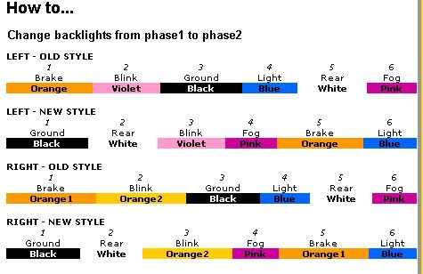

lol I just bought a brand new pair of phase 2 lights including bulbs and bulb holders for £27 including postage off ebay.
Brand new from Renault they cost £47 per light!
Pretty chuffed, fitting them next weekend

How did u get them to fit? We tried to put them on my mates clio but they didnt fit properly!
  SLK 350
They fitted fine on my old MK1, just require some small manipulation to ensure the boot closes correctly. The wiring is another matter though, its a b**ch.
  A slow one :-(
ah we took the bulb holders out of his old lights and put them into the new ones. I dont think Ill try the change seeing as Im colour blind. Prob wont be able to tell the difference between the 2 orange ones and the blue and pink ones!

Pheonixy on here tried to rewire the old holders in and nearly had to call an Ambulance.
