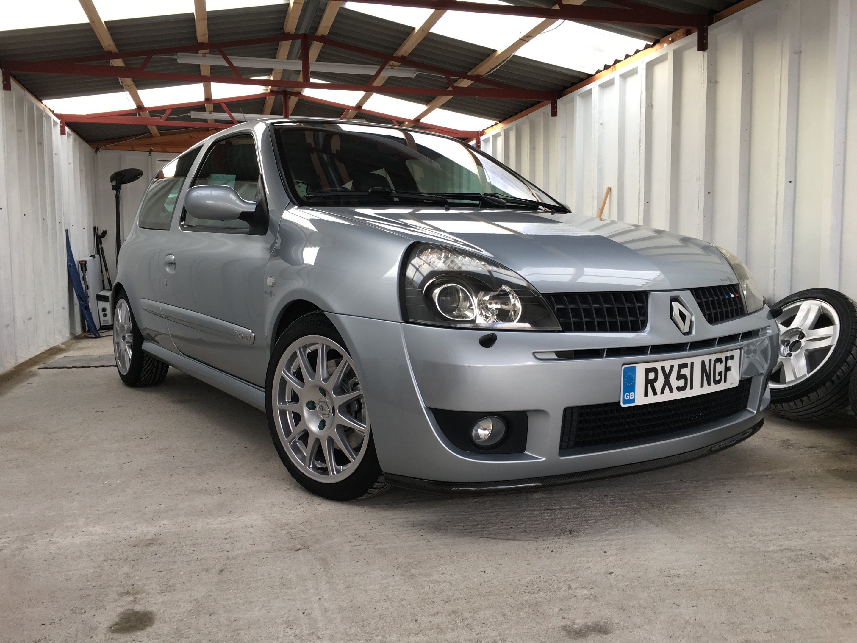

So happy with the overall work I've done to the car, I have a few more bits yet to do however this little beast is very very mechanically sound!
Just a quick pic of the dirty biatch posing its new stance!
I'll be using the next few nights to bed everything in but first on the list is tracking booked for the morning.

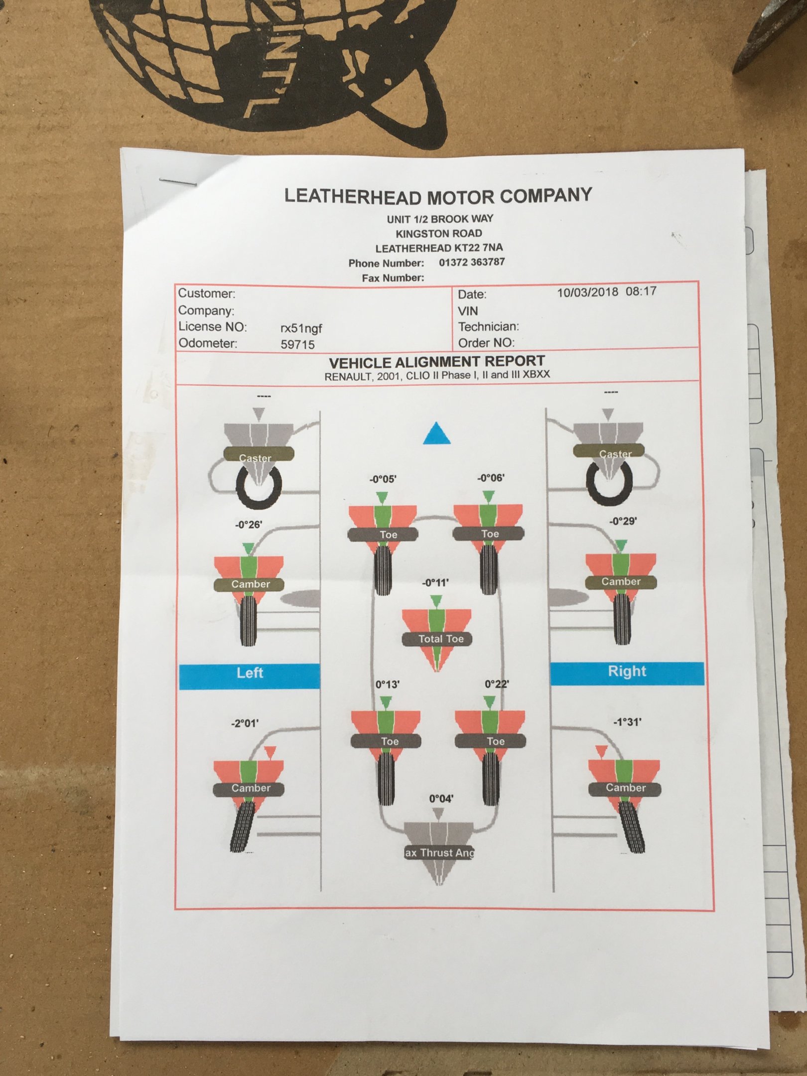

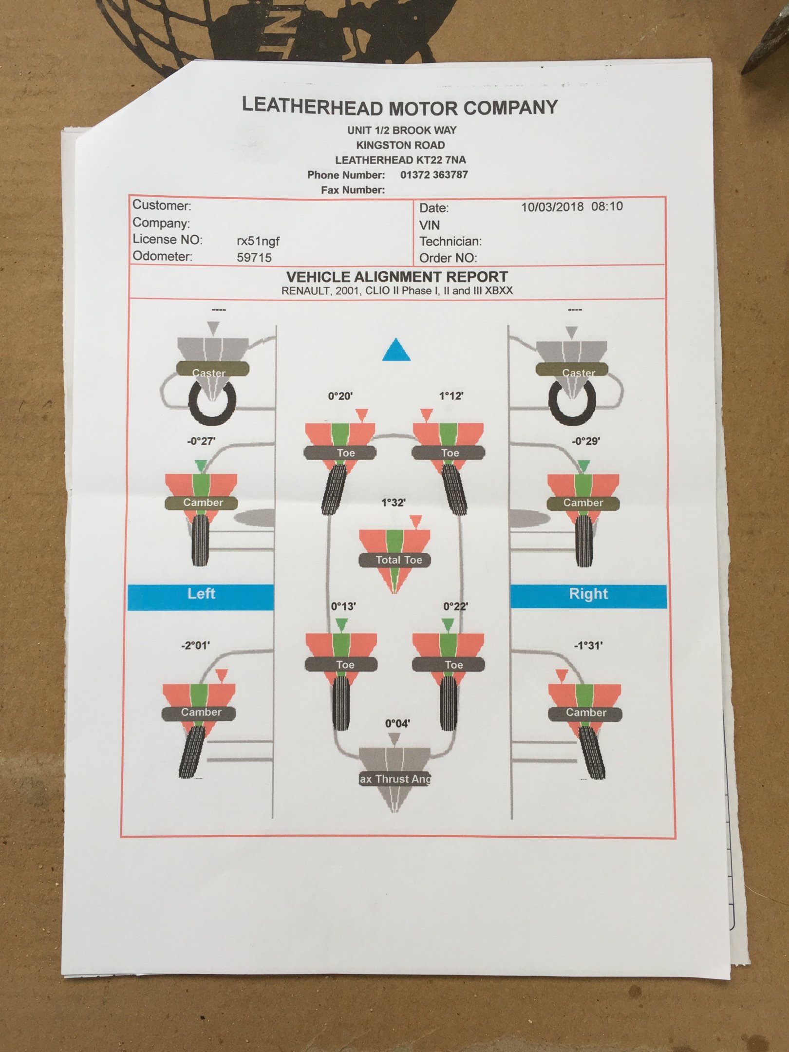

Started this morning off bright and early taking the car to get it tracking done.
Here's a before
The garage was pretty impressed considering I've had the front end apart however as you can see it still needs some correcting...
So this is after!

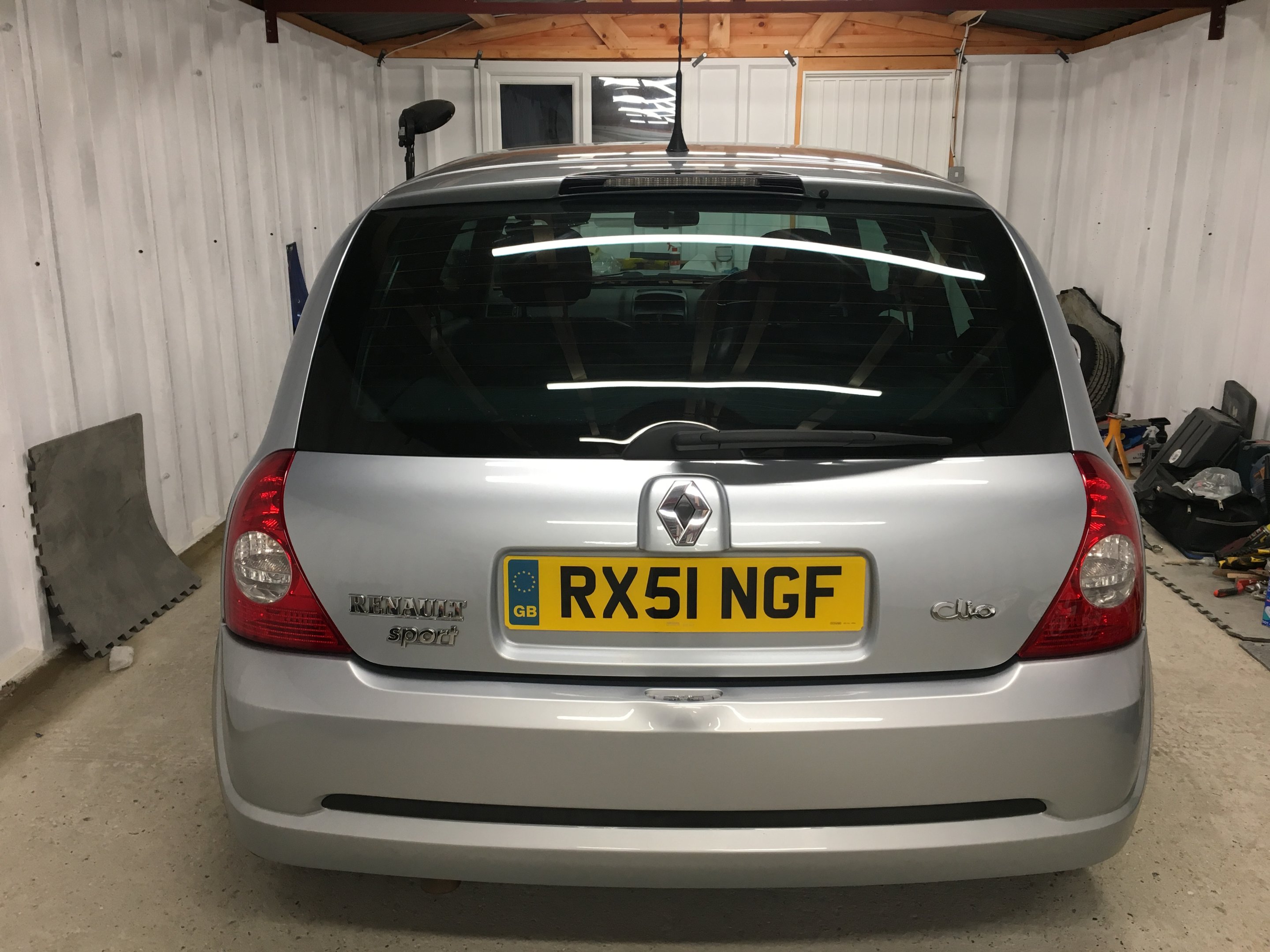

As you can also see the rear now has a slight camber which I'm guessing is due to the cooksports. Can someone confirm or advise on this? Would shims bring that back out or should I not bother?

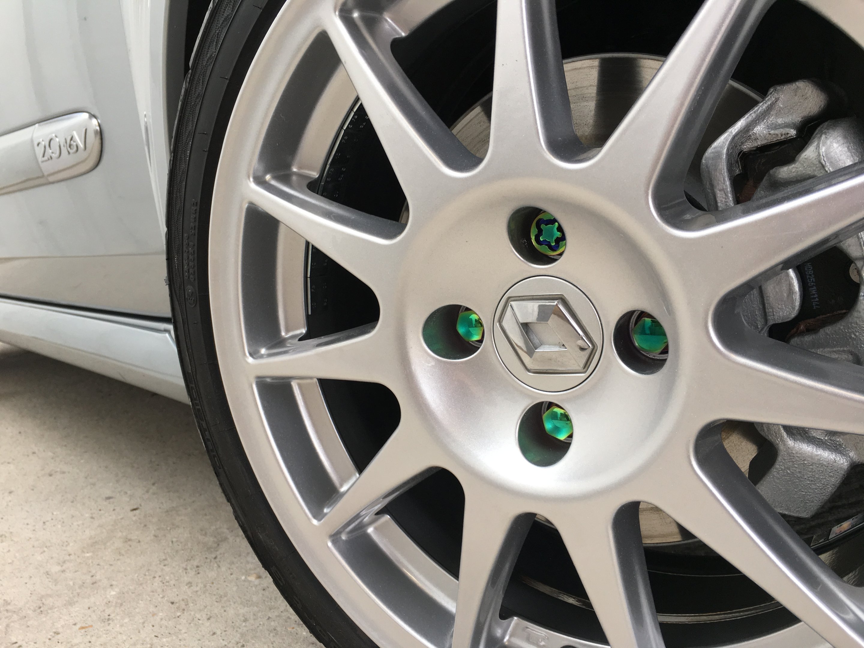

On the drive home the car felt so much tighter and handles like a dream! I did notice some swquealing from the front brakes however and this was doing my head in. Back home and the father in law came over to help re-grease the calipers which help to stop this!

I was wondering if anyone could advise one the following.
After the brake rebuild I have kept the shims in place could this be causing them to squeal? I have tried re greasing twice now.

Would anyone also be able to help on what shims I would need on the back to bring the camber back?
Sorry for the double/triple post can anyone advise on the above before I remove the brakes. Would anyone also be able to help on what shims I would need on the back to bring the camber back?
Personally I would not bother with shims on the rear. How many miles have you done on the front brakes? Might be worth running around and letting them bed in a bit before removing again.

Ah ok, I will give them some time to bed in.
I have noticed once warm the squeal reduces, I have done around 60 -75 miles so far.

I would give it at least 200 miles unless its really bad. I actually quite like the original spoilers as the brake light is the same as the one in the trophy spoiler and looks more modern.
