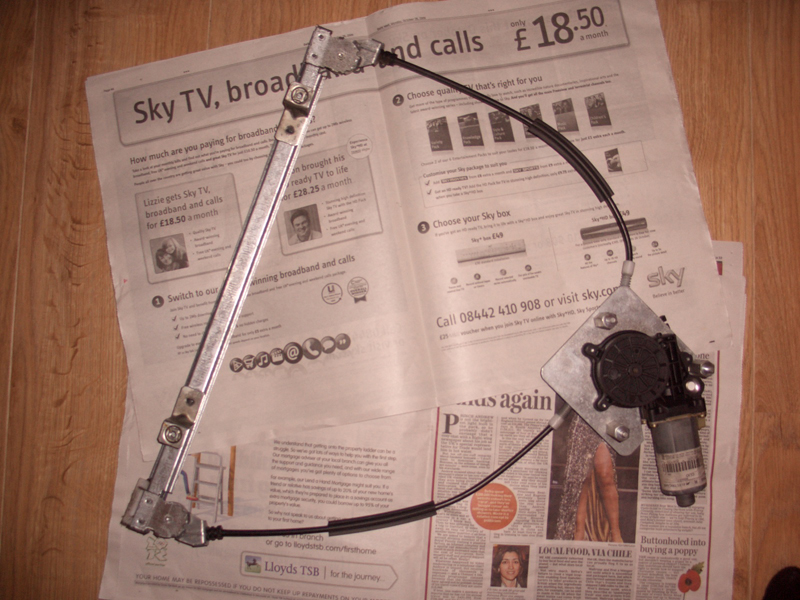

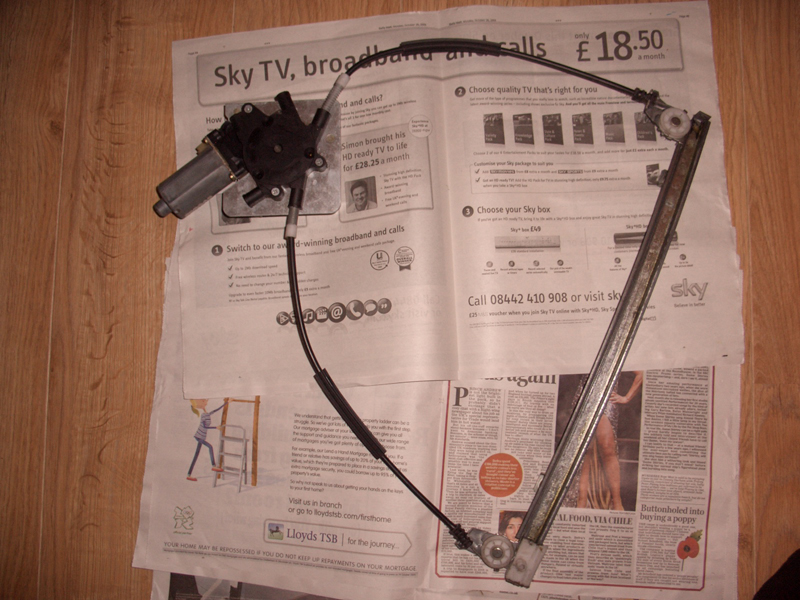

Identify this window motor and mech
Rob
Can you??
It has come out of my mk2 ph1, but I believe it to be a mk1 motor and mechanism as it works on changing polarity.
Many thanks to those who help

I've got it out, now gotta try and attatch my motor to this mech, LOL!
hmm, the motor looks like the mk2 one to me
I thought it could be but the thing that makes me doubt it is the following diagram in the electric window guide:
attachment.php
Btw the guide explains how the motor works.... (my mech had no crossing of the cables...)
In some way.... if i can get the cables onto my new motor, great, if not i'm going to go and get the two motors out of the rear of the scenic, and be VERY careful to get them out in one piece. They'll be free, so its not a problem if they dont work.
Gonna have a crack at it now, wish me luck.
P.s Would someone confirm if this motor is a mk1 one? PWEASE
Fail, massive one. everything would have been so easy its untrue but then i struck two different problems.
If i could solve either I would have no problem.
The cable from my motors is too thick, meaning it doesnt fit into the new motor, f**kING JOKE.
There are very slight differences in the top parts of the motor that mean I can't just swap the electircal part over.
Two easy fixes, neither can work. I'm gonna pop to the scrappy saturday day it looks like, and pick up the rear motors with cables and runner.
OH.... and now since taking the motors apart I can't get the back together? I can't figure this out in the slightest. Its as if somehow the metal parts of the motor have grown since taking them apart....
