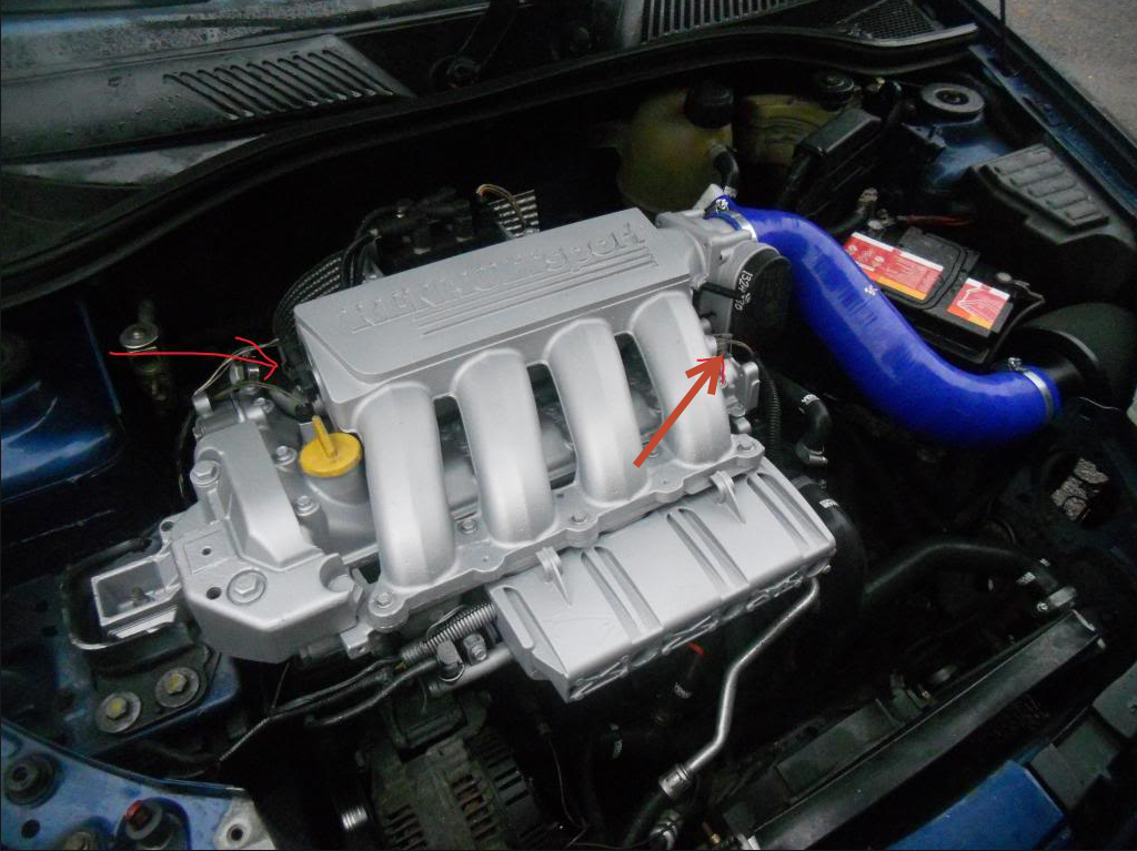

Hmm I think so yes...
IAT = Intake Air Temp sensor. The small thingy on the right side of the intake manifold. Give it a good clean with brake cleaner.
Bit strange no errors are logged :(
