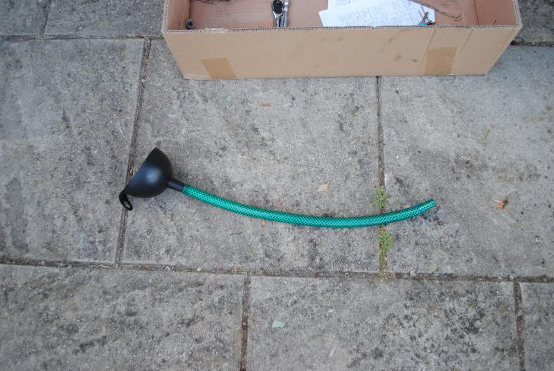

Tried using a hose it just took literally hours and didn't really go into the hole? Isn't there just an easy quick way to fill it back up again? Giving up for now and getting a lift home but seriously annoyed at myself :/ Can't seem to get the oil into the hole? Using a hose and funnel takes literally hours...
Hours? You just need to put a 2 inch slit in the hose then fold it in on itself so its small enough to go in the fill hole. I used a cable tie to keep the hose shape smaller.
Should literally be a case of unscrew the cap, put the hose in and start filling.
  1.6 Astra Sporthatch
Ah I was using a smaller bit of hose than that! Some from the fish tank, didn't think of putting the cut in the end of the hose. Thanks for that! Ill have to come back and have another go in the morning now really, just out of interest how often is a gearbox change even meant to be done?

There's a filler on the box, it's a hand screw, you can't miss it. A hose in that hole and a funnel on the hose should fill it properly. If no oil is going in, remove the hose and stick your little finger in bending it "down". If you hit oil, it's not empty and you've done gone know what.
