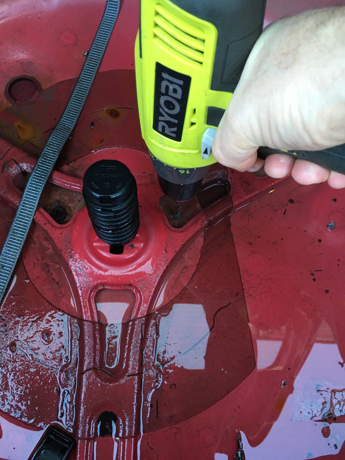

Fixed the water leak into the boot.

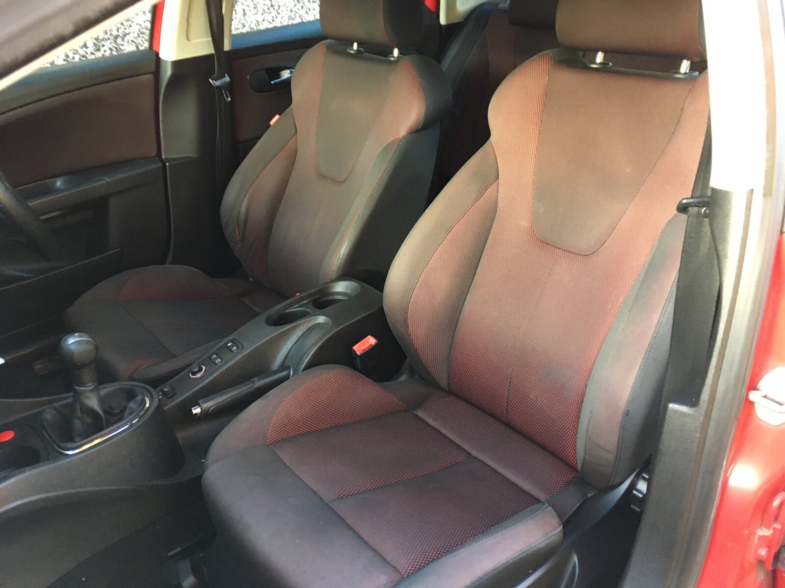

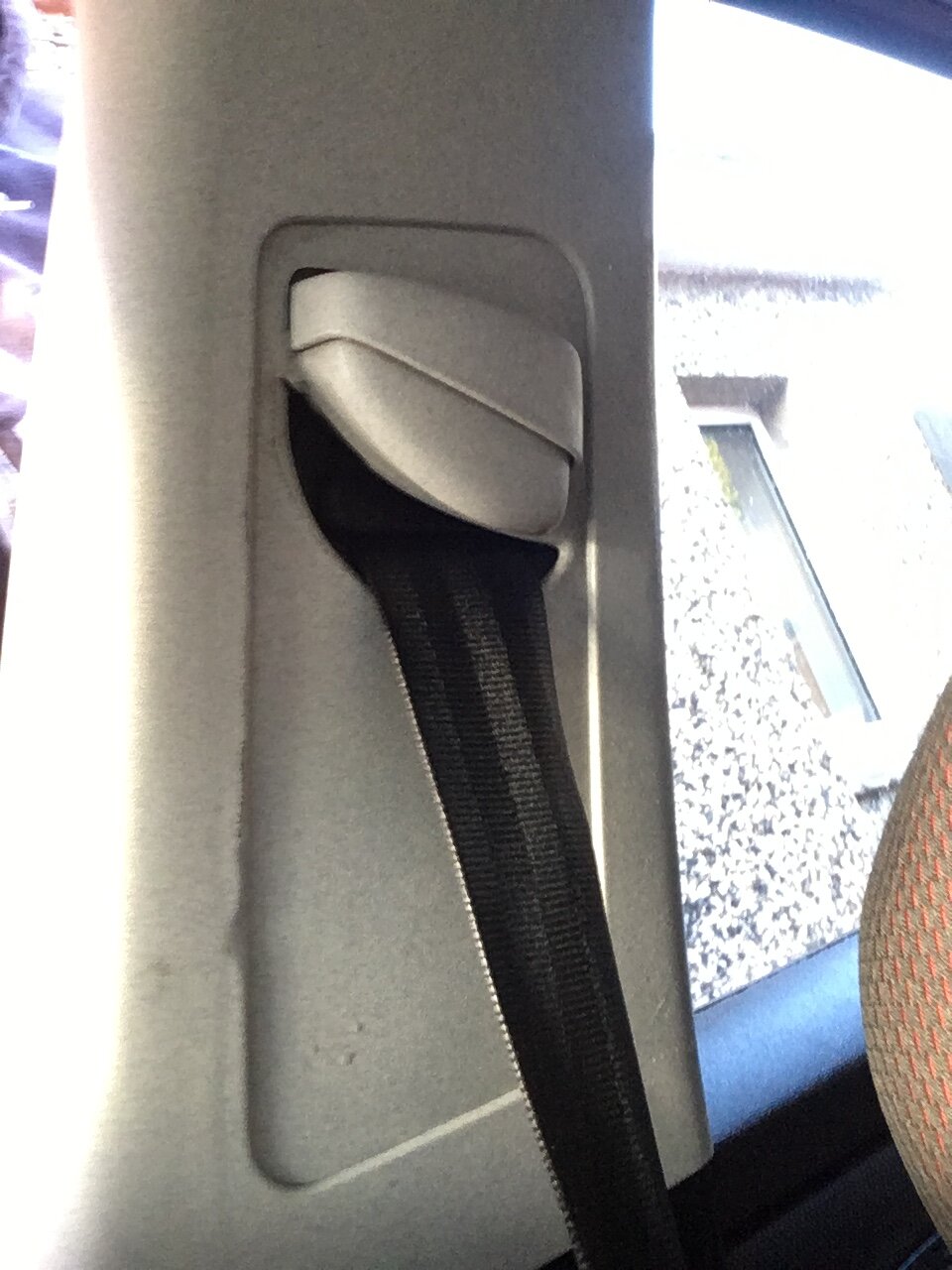

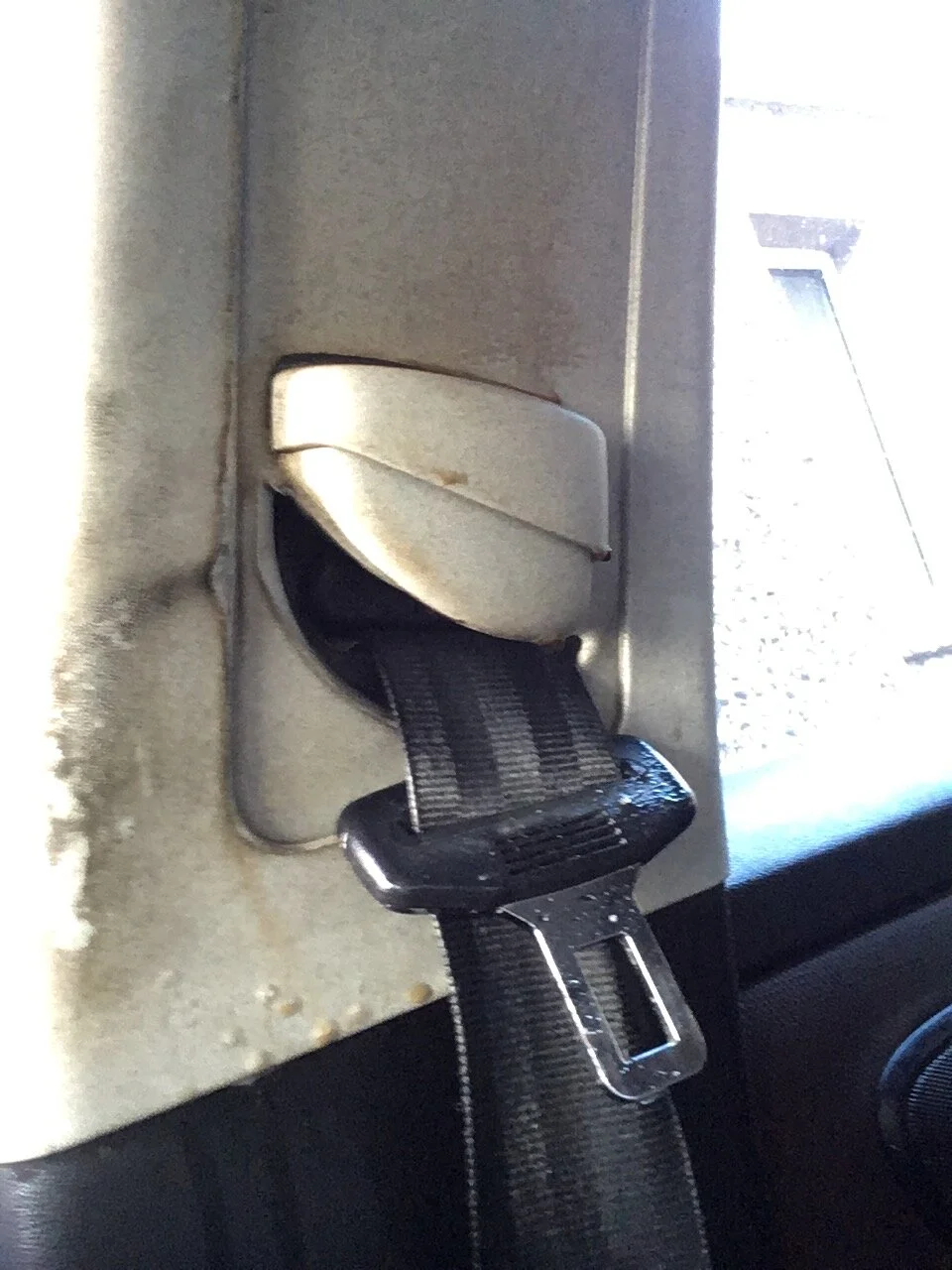

And cleaned the interior, for 169,000 miles the inside of it's actually good, doesn't match the outside at all 😂 also removed the stereo since all it did was go on or off, nothing else at all.

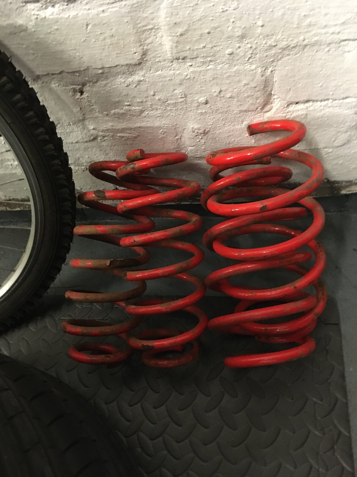

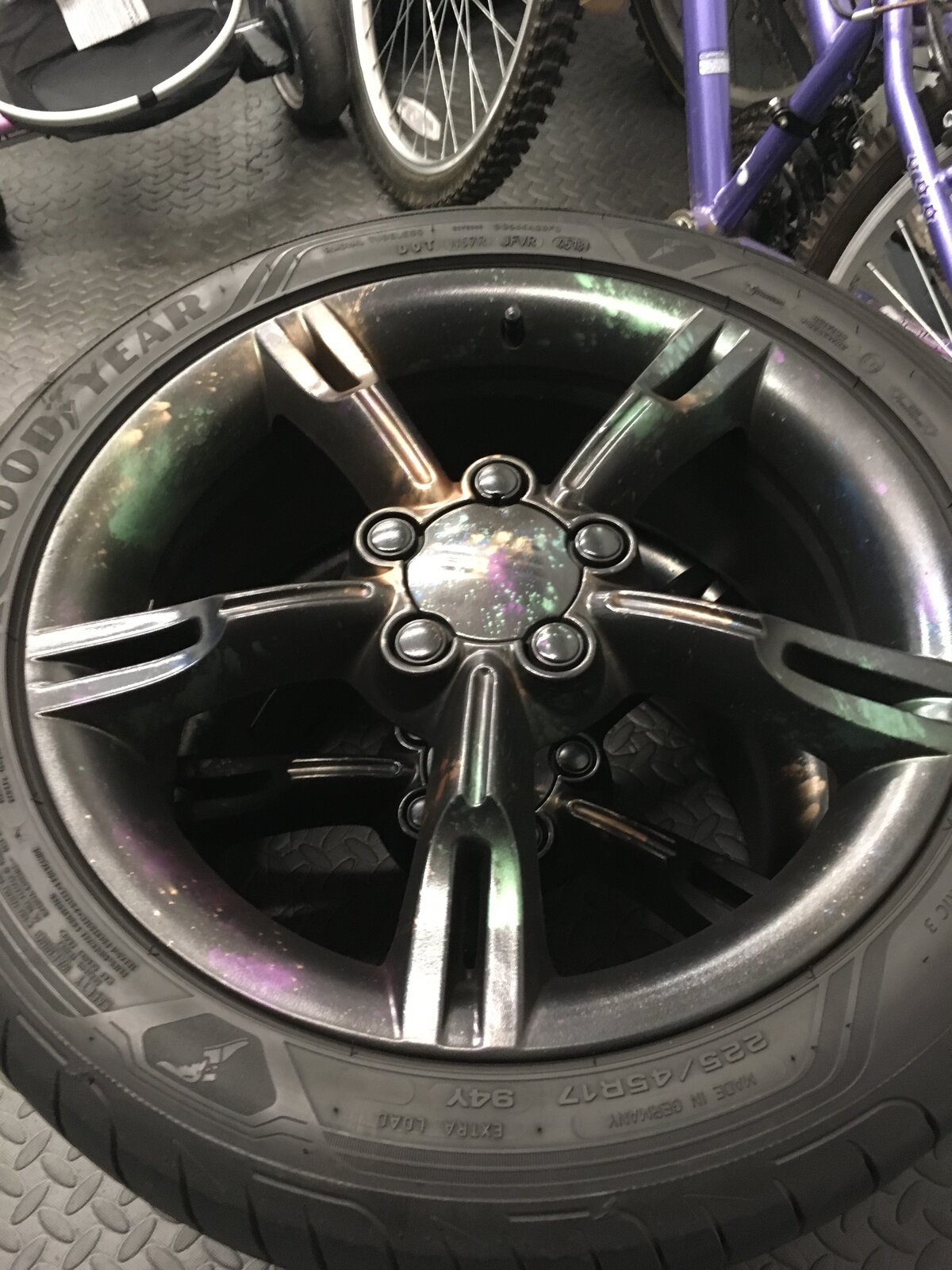

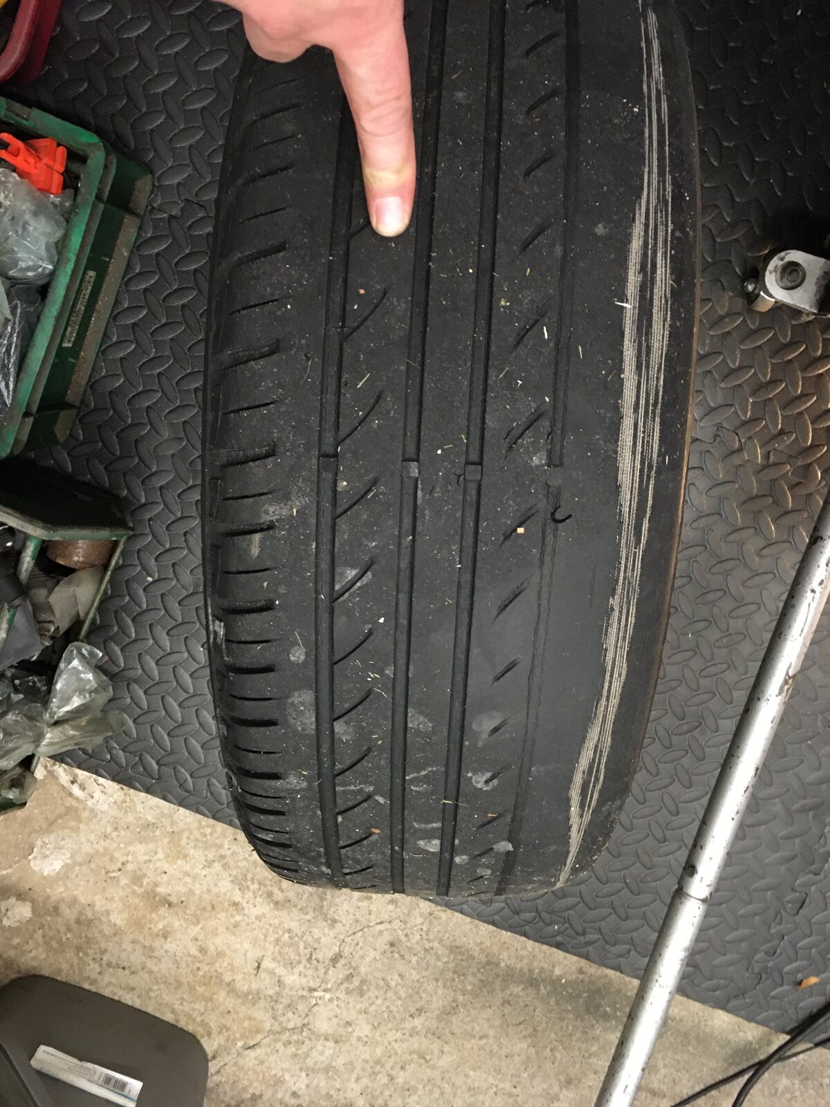

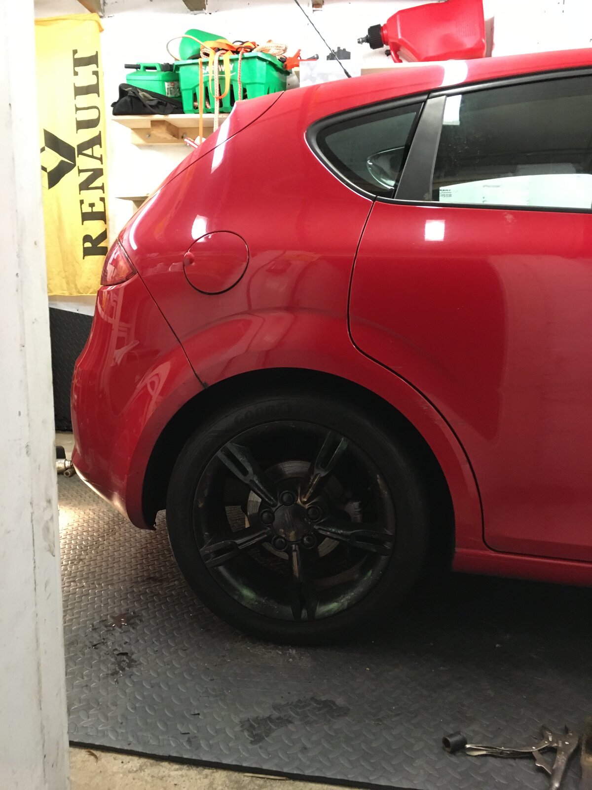

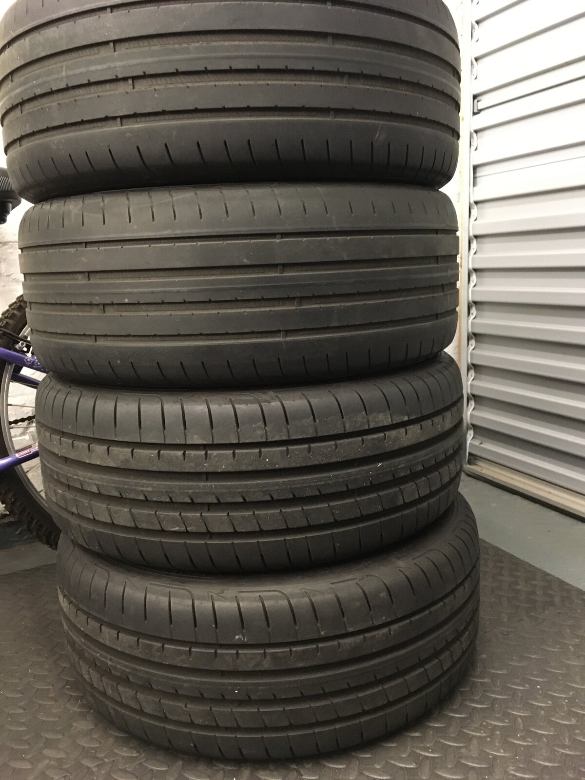

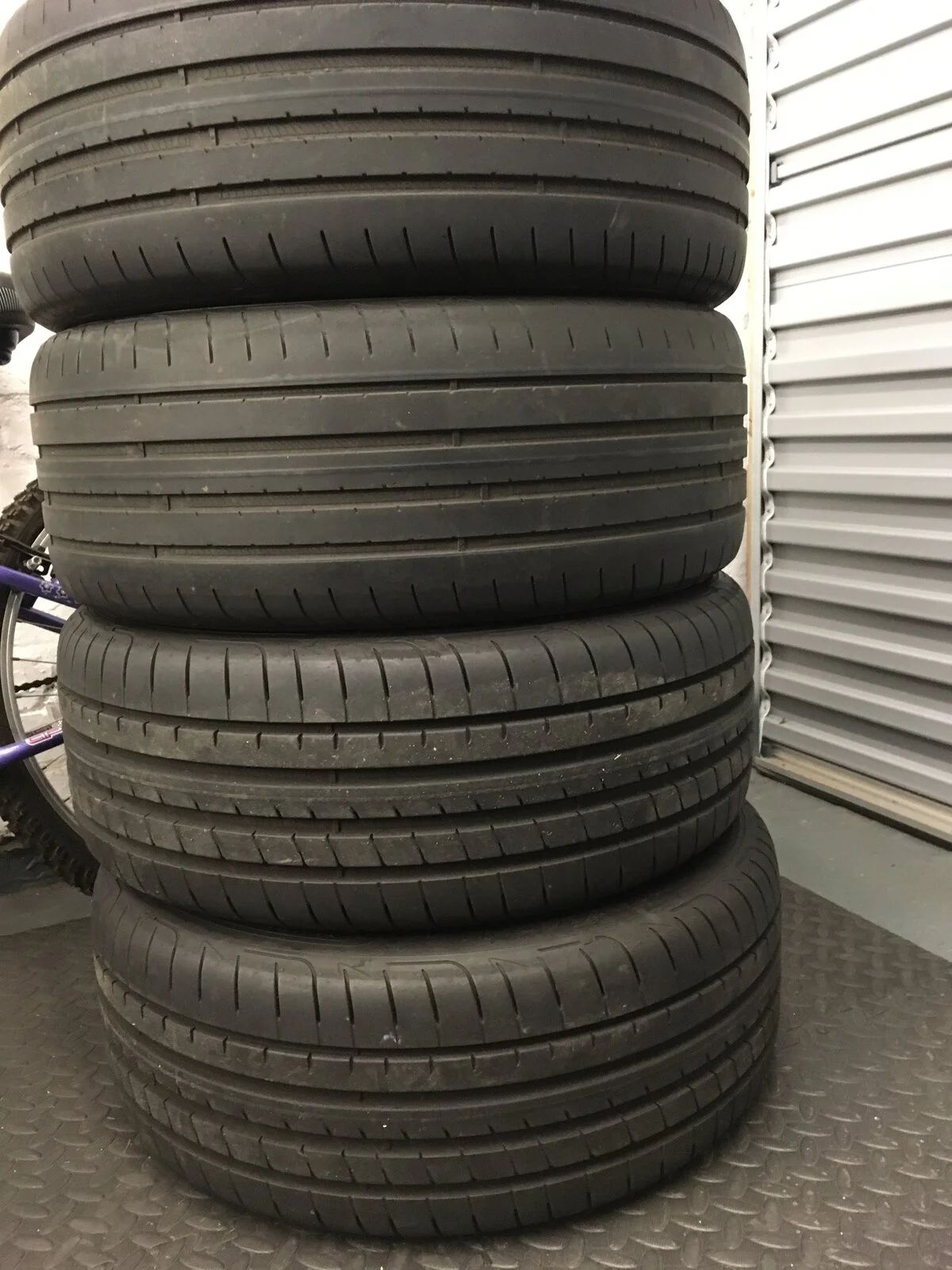

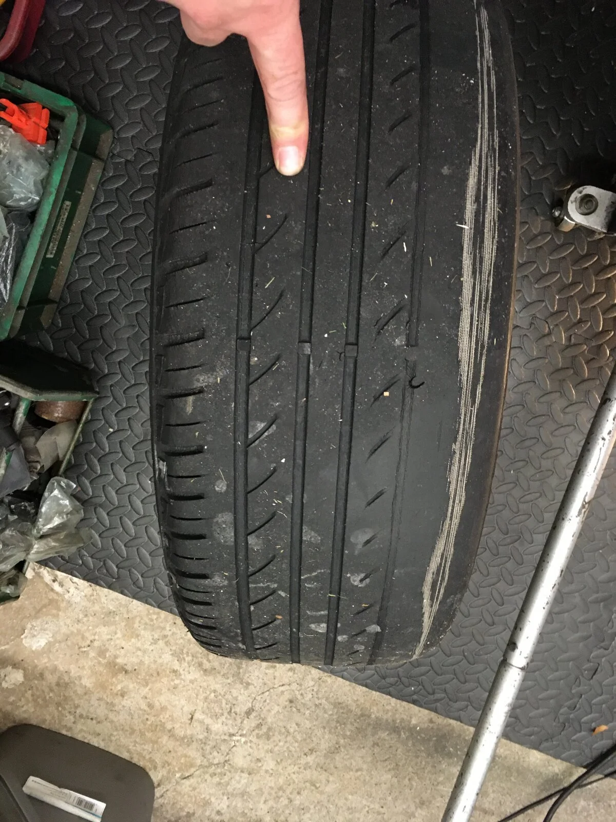

Never seen a rear tyre like this on a fwd car.

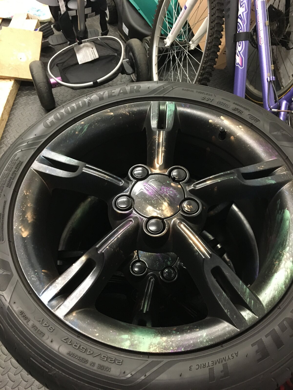

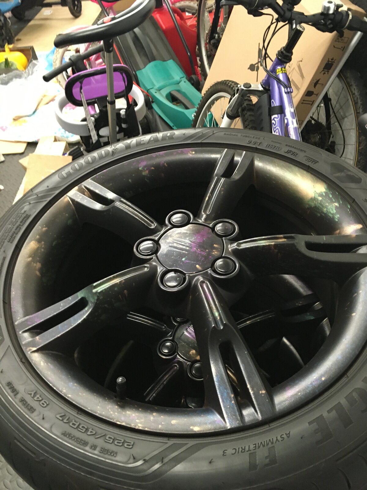

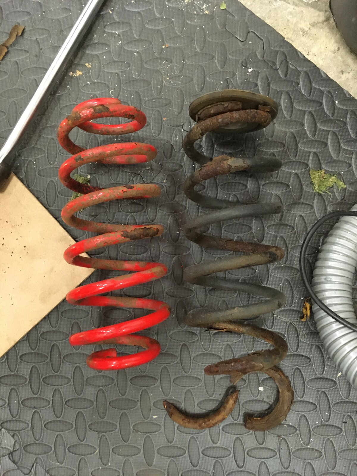

new wheels and lowering springs which are probably higher thanks to the olds ones being very broken.

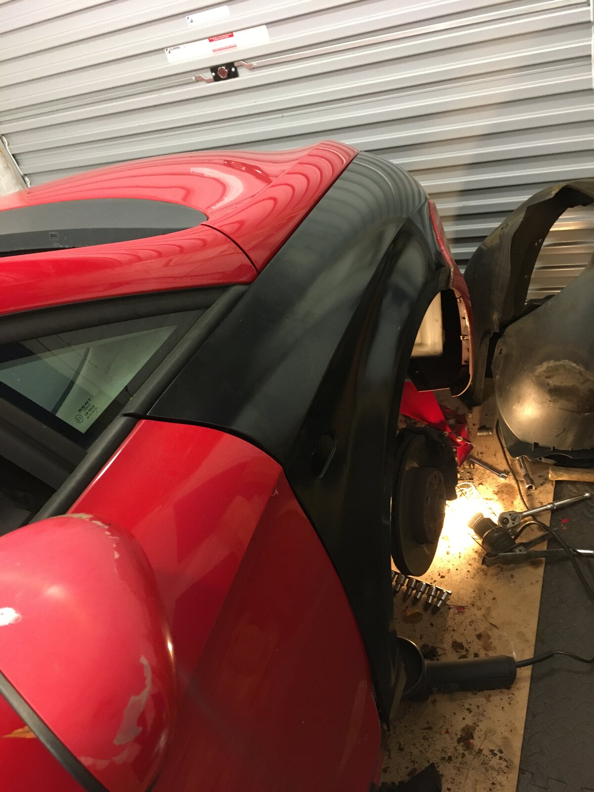

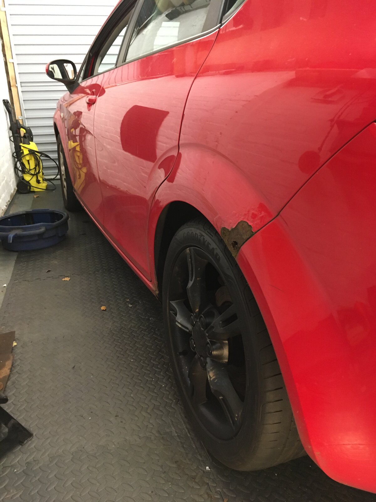

And then breathed on the old wing which fell off and put the replacement on. I'll need to figure a way to secure the bottom of it as the sill is quite far from where it should be 😂😂

R3k1355
The rear tyres are fucked because your rear alignment is massively out, usually because the alignment bolts are seized.
You'll have a sound like a worn wheel bearing while driving and obviously you'll ruin the new tyres pretty quick.
Djw John
Scotland - South
Ah right, I guess with it being too low thanks to the fucked springs that'll have exaggerated the camber?
I reckon I'll use it for 2-4 weeks so hopefully they'll last that long
R3k1355
If they're rubbed the outside edge to f**k it's not camber it's got mega toe-in, which is common when the alignment is borked.
R3k1355
Na it's the inside. For some reason that photo is upside down!
Same problem, different bolts.
From my experience it's not something you can easily fix, even on a ramp it's perilously close to the fuel tank to be waving a gas axe around.
Basically you end up dropping the rear subframe and replacing all the rear arms.
If you're only gunna keep it a few weeks then ignore it, new tyres have gone on already so no worries.
