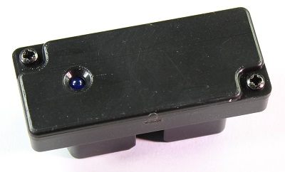

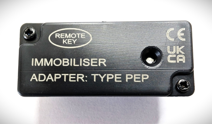

I haven't used one but bookmarked it just incase I ever did need it
Many thanks for this. Very much appreciated. I'll certainly investigate if it's available for a 2002 car. Cheers!
Bought myself one of these for a phase 1 last week, still not working even after 4 days of trouble shooting with the company - may well be the wrong code written in my key but these normally work easily
Aye you'll need the correct key, if it's still an issue buy a second hand full lock kit with uch etc, people breaking them sellkits on facebook if no one on here
Get the ph1 ecu de immobilised by Efiparts miles better
