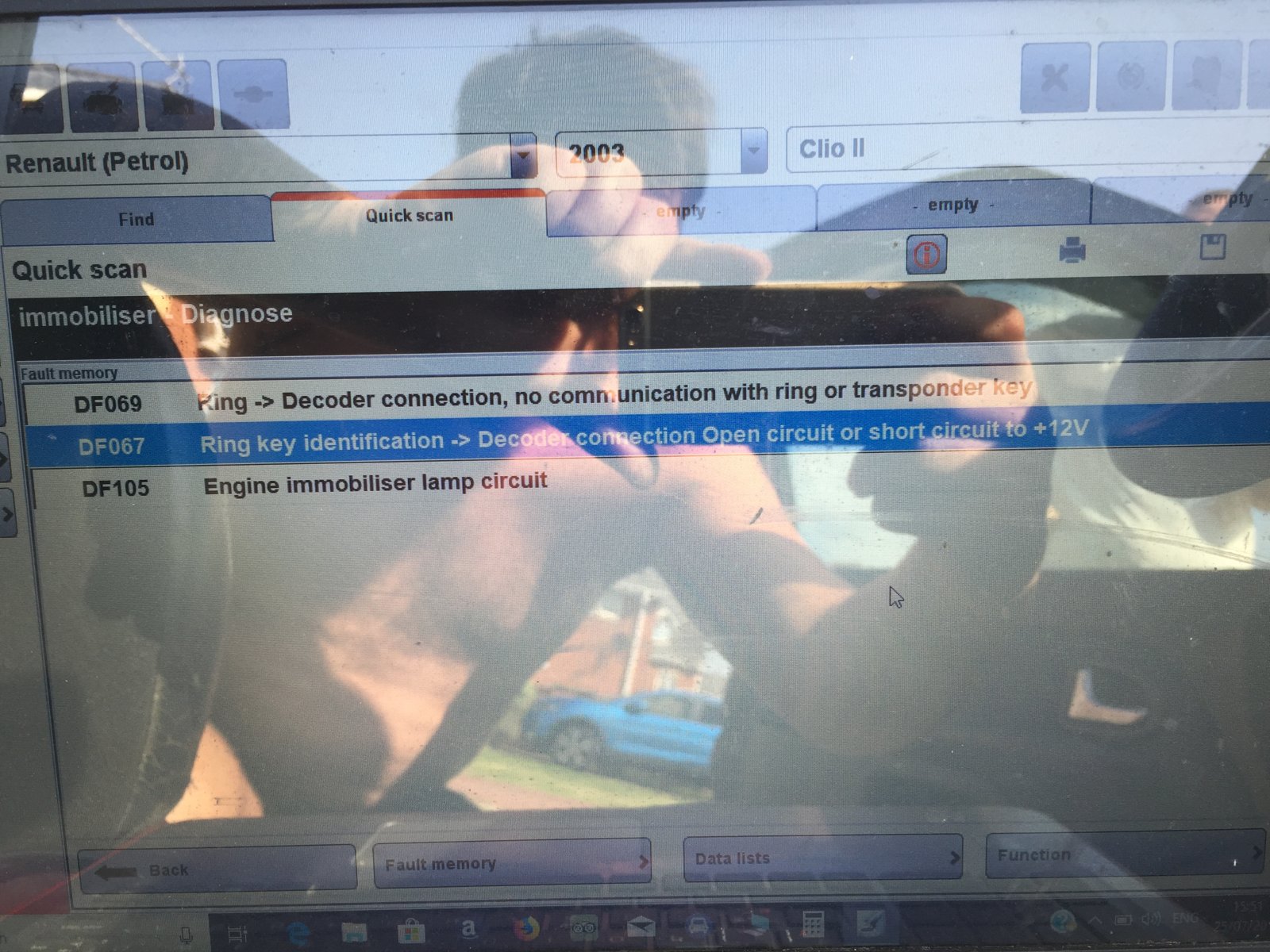

Haven’t tried that out I’ve had it plugged in and it came up with this..

I had exact same thing a couple of months ago. Tried my spare key and it starts first time. The key I was normally using locks and unlocks on the remote but when put key in light flashes quickly and won't start. Spare works fine so tells me wiring is fine must be the key. Anyone know what can do about that?

Even my spare key doesn’t work :/ I’m gonna have to flick through the loom somewhere and see what’s going on, I’ve got a spare loom if needs be so I can put that in and try again. It’s a pain in the arse now
