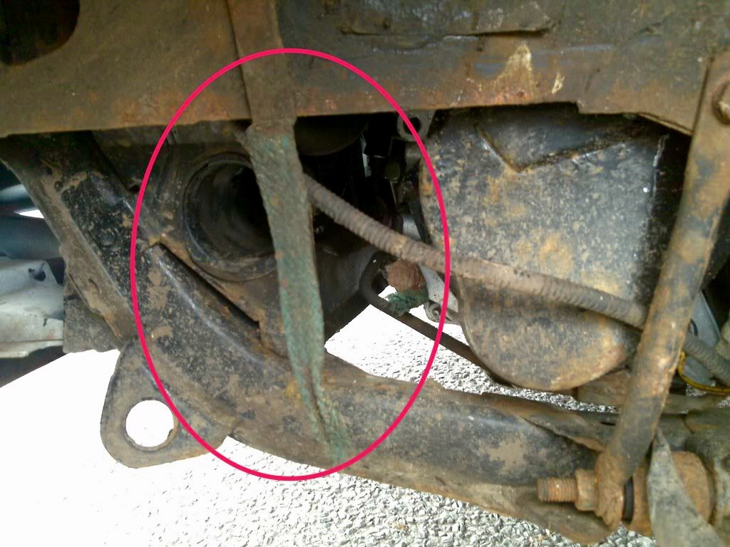

Check the earth strap under the passenger front arch liner from gbox to chassis.
Thanks will have a look tomorrow after work. What exactly am I looking for? Just that it's connected?

Im not sure about immobiliser reset, but the earth strap will be a green strap that should be connected to your gearbox to chassis, they corrode and when they do the car wont start, this is the strap, it shouldnt be hanging like that lol.
You could try putting a jump lead from your negative battery terminal to the engine, somewhere metal thats clean and unpainted, the car should start then if its an earthing problem.
