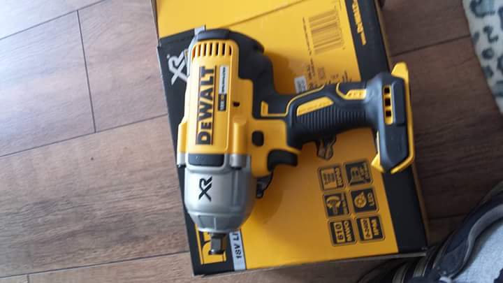

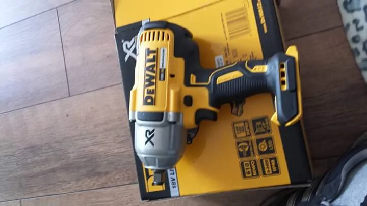

I got a DeWalt cordless one for Christmas, it's epic. Best tool I have

When I was looking the DeWalt range were good value for the amount of torque they produced, around 1000nm for a £150 i seem to remember, but you need the batteries/charger etc which is why I didn't go for it as I already had Makita bits for other tools.
Think i was around 120 all in for gun,battery & charger
3 settings for how much power you want

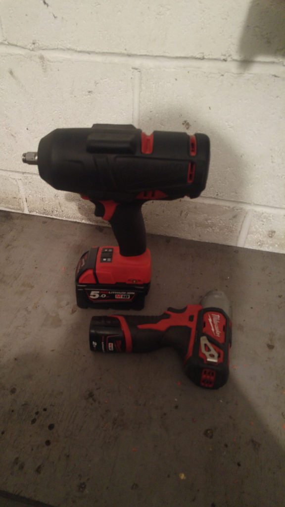

I'm currently repping this awesome combination. Opted for the high torque impact gun for the big bolts. I decided that if I was spending some dollar on an impact gun I may aswell do something that isn't going to get beaten by anything. I'd be massively disappointed if I spent a few £100 on something and it got defeated so spent a bit more. Then got the smaller 3/8 jobby for little jobs, it's lovely and light so makes it a breeze to use. Most likely going to get the 3/8 milwaukee ratchet soon as it looks really handy.
