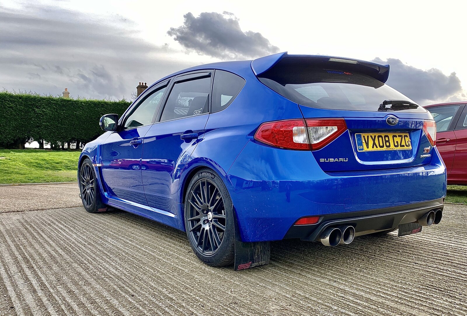

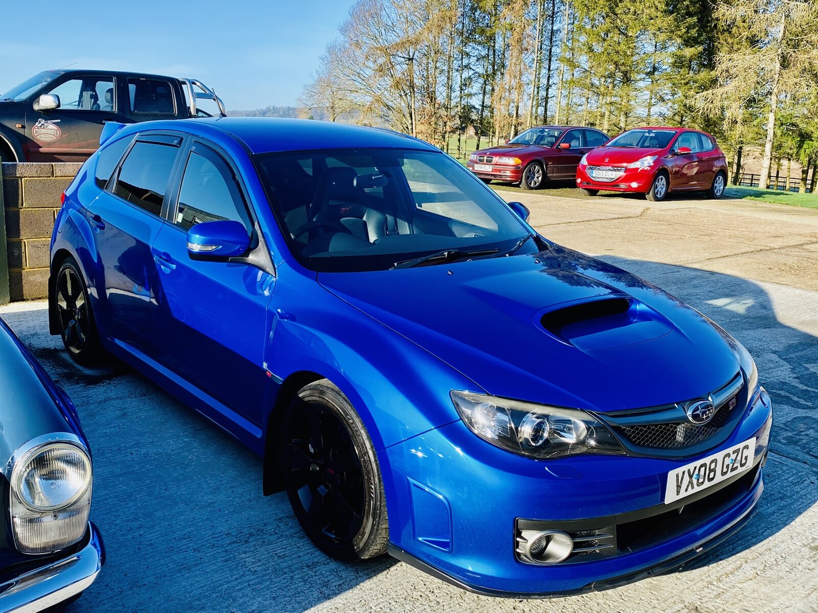

So went and had a proper look over the car and took it out for a couple hours today. Drives flawlessly, the low down punch really catches you out as a passenger, feels a lot more aggressive than most cars I’ve driven with that sort of power. Probably a trait of the 2.5.
Sadly found some rust on the near side rear door and door seal which I didn’t spot initially, but the condition is remarkably ok for the age, minimal peppering. Will leave for now although I always end up fixing things I shouldn’t

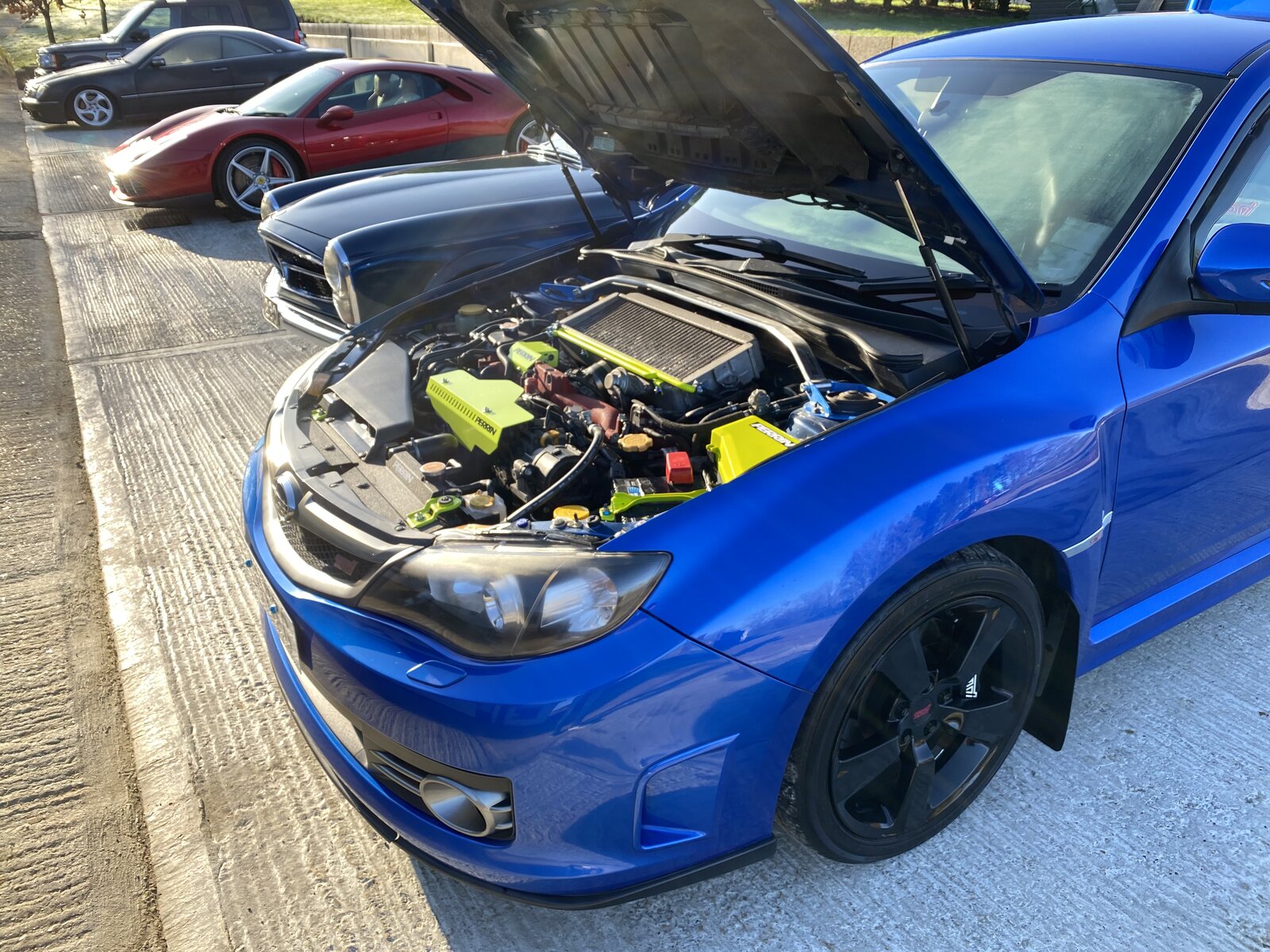

Degreased the engine bay whilst I was there. SMD Friday for belts and full service.

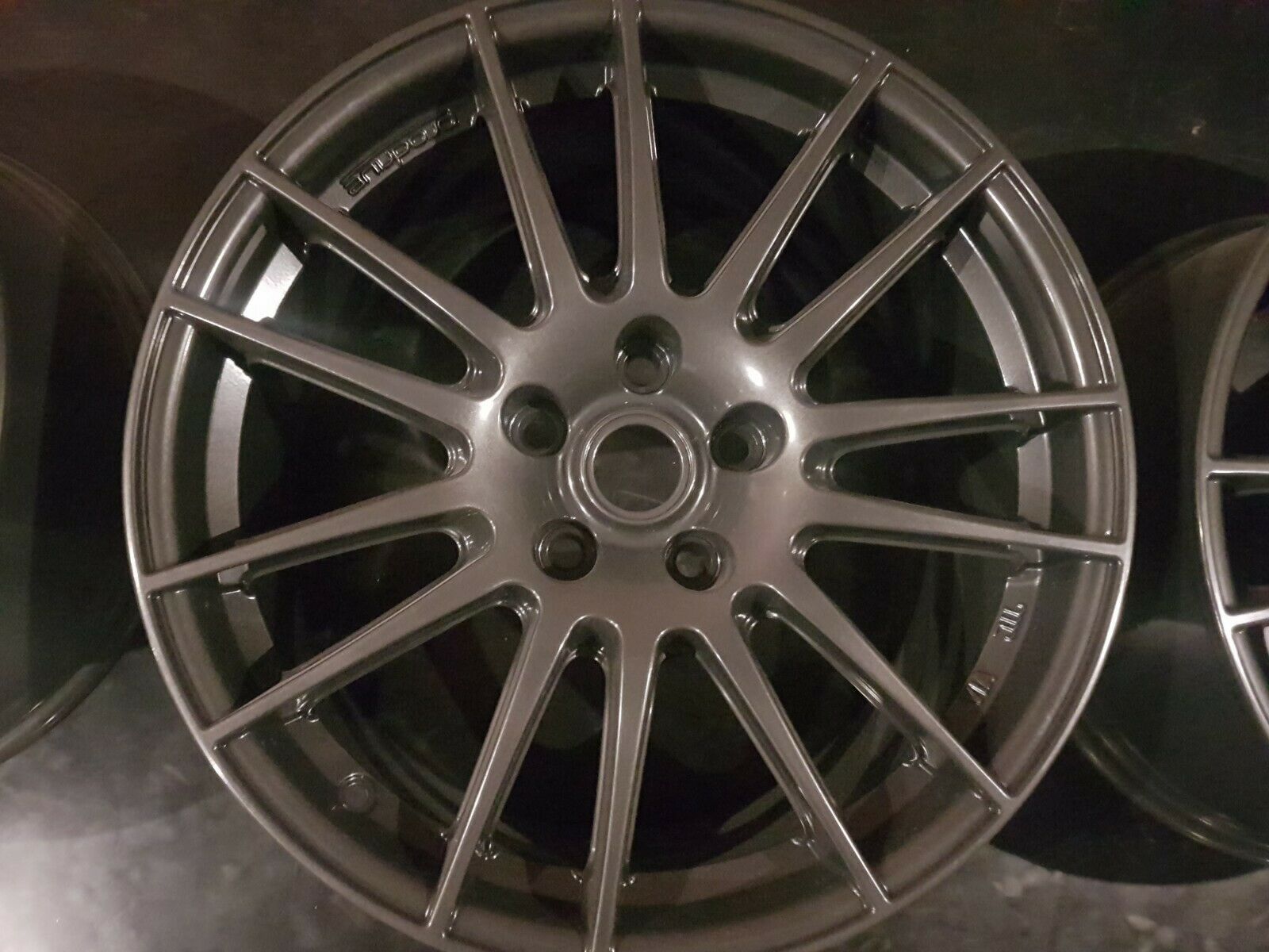

- Those Prodrive wheels look much nicer.

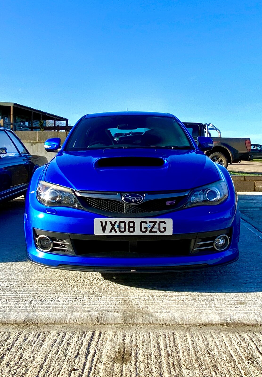

Car left with SMD till tomorrow morning for belts/water pump/ oil change
Pretty reasonable news, all in all. Minor things. ARB bushes will need changing, pin missing from balljoint which is easily fixed. Bigger-ish jobs was one of the top mounts needs replacing, and the heatshield (turbo and mani need to come off so it's a bit of a pig).
All in all not bad - he said it was one of the better newer scoobs he's driven. Will likely take the car back. Plan on replacing all the OE suspension out with freshness.

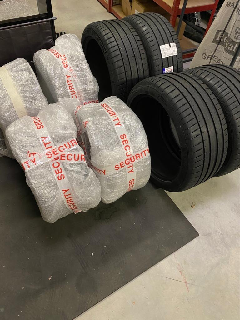

I also picked up 4x Pilot Sport 4's on the way home today for the new feet.

I agree with the wheels, they're gash. Interested to see what you do with it.

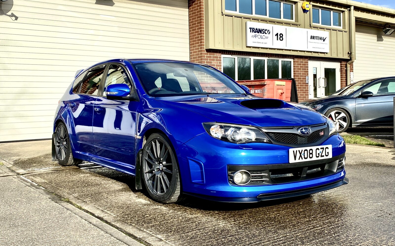

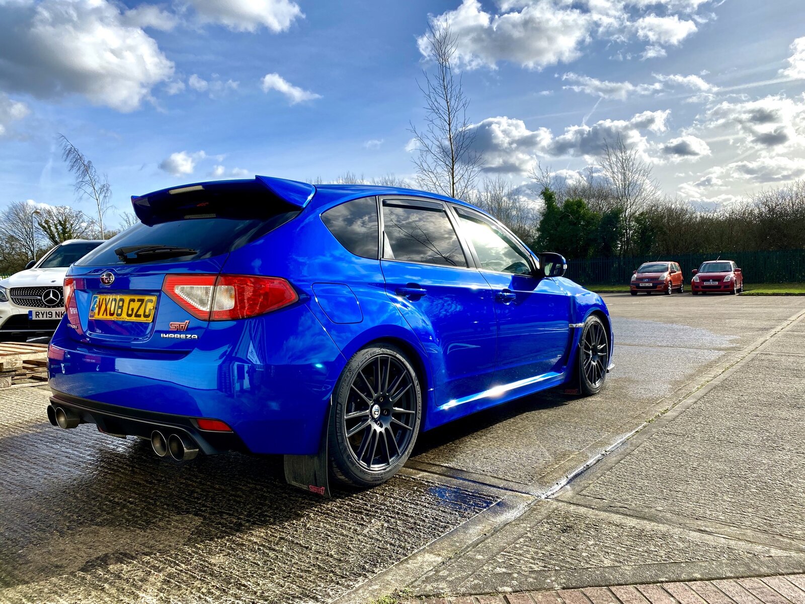

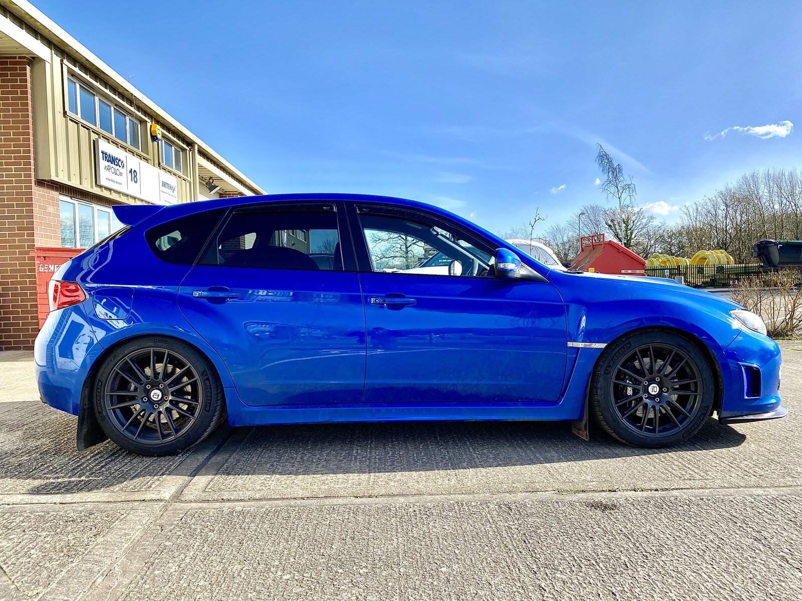

Picked the car up from SMD today. Looking a lot better, and the new plugs have gotten rid of a hesitation at 3k. Quite impressed with the new suspension thus far. Really comfortable ride on the road, and not crashy at all. The only complaint was the car was stuck on the ramp for a couple days, as they sent the wrong part twice.
All ready for Summer, just want to get paint sorted next.
Had a major service inc Cosworth Kevlar belt, tensioners, water pump etc
MeisterR coilovers and full geo. (15mm drop)
Prodrive GT1s fitted along with PS4s.
  Evo 5 RS
What a difference..
The wheels look a little bit of a weak offset for those arches mind.
They’re almost identical to the 330s wheels, so it’s weird as to why. Camber doesn’t help. Lol, not sure if I can be bothered to spacer it
