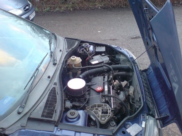

What they have done here is fitted a universal air filter to the cold air feed into the air box and then removed the warm air feed from the top of the manifold leaving a big hole into the original airbox letting unfiltered air in. Now unless they have left the air filter inside the original box that isn't a good thing to let the air in unfiltered, and if they have left the original filter in there...well, double filtration for extra filtered air! Haha.

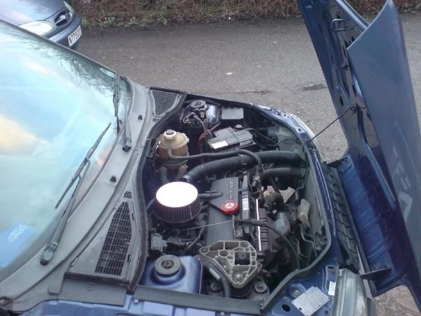

You need a kit filter for this engine. I had one years ago for my 1.2 mk1 Clio oasis, K&N removed the whole airbox set up and fitted a nice filter that sounded class at the time. No performance gains to be had from it though. Should look like the attached photo if you get the right kit!

It sounds like its already in top shape from what you have said. My advice would be leave it well alone and just enjoy driving a low mileage tidy little Clio! :) If its really as good as it sounds and you really want to play about with it, don't "bodge" the induction kit, save the money and get a proper one like I have posted. The picture in the link above you posted isn't healthy. The car theoretically has two air box's fitted and this will be restricting the air flow.
