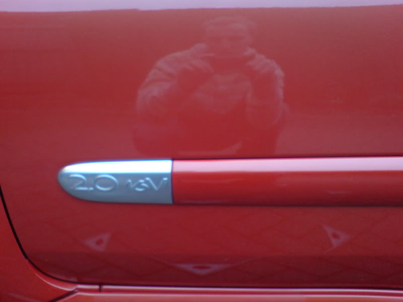

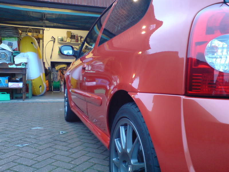

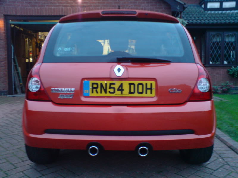

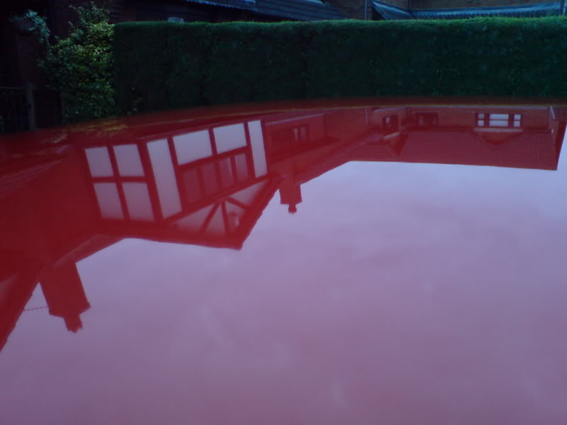

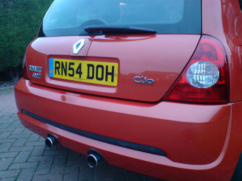

Claying it did the most good, the amount of sh*t that came off the car was unreal now beautifully smooth.
Due to daylight and closer inspection of paint it didn't warrant using an SFX2 for swirl removal, I'll wait until next time for that. Just wanted to get her cleaned up properly to make the job easier next time.

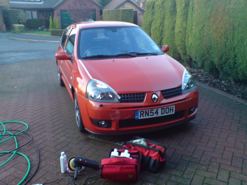

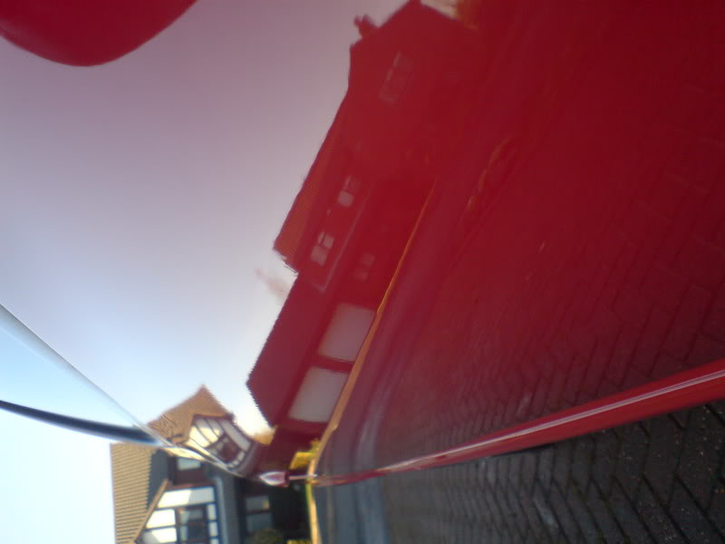

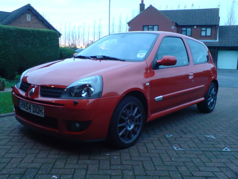

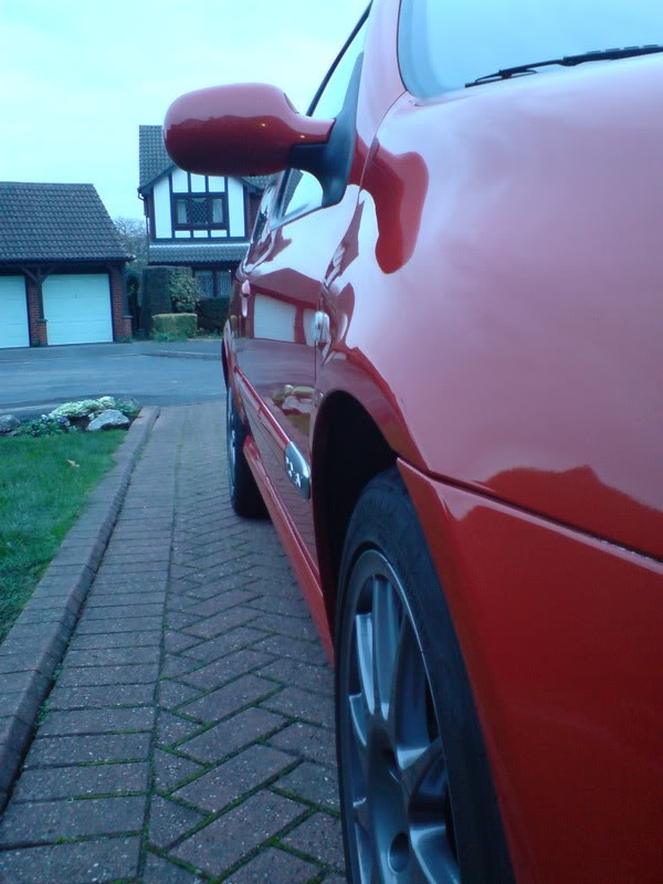

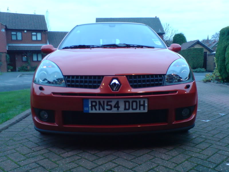

Anyway some pics:
Yesterdays groundwork:
Nothing special, but in the flesh (and with a decent) camera it looks infinitely better for it.
My hands have now regained their colour...
