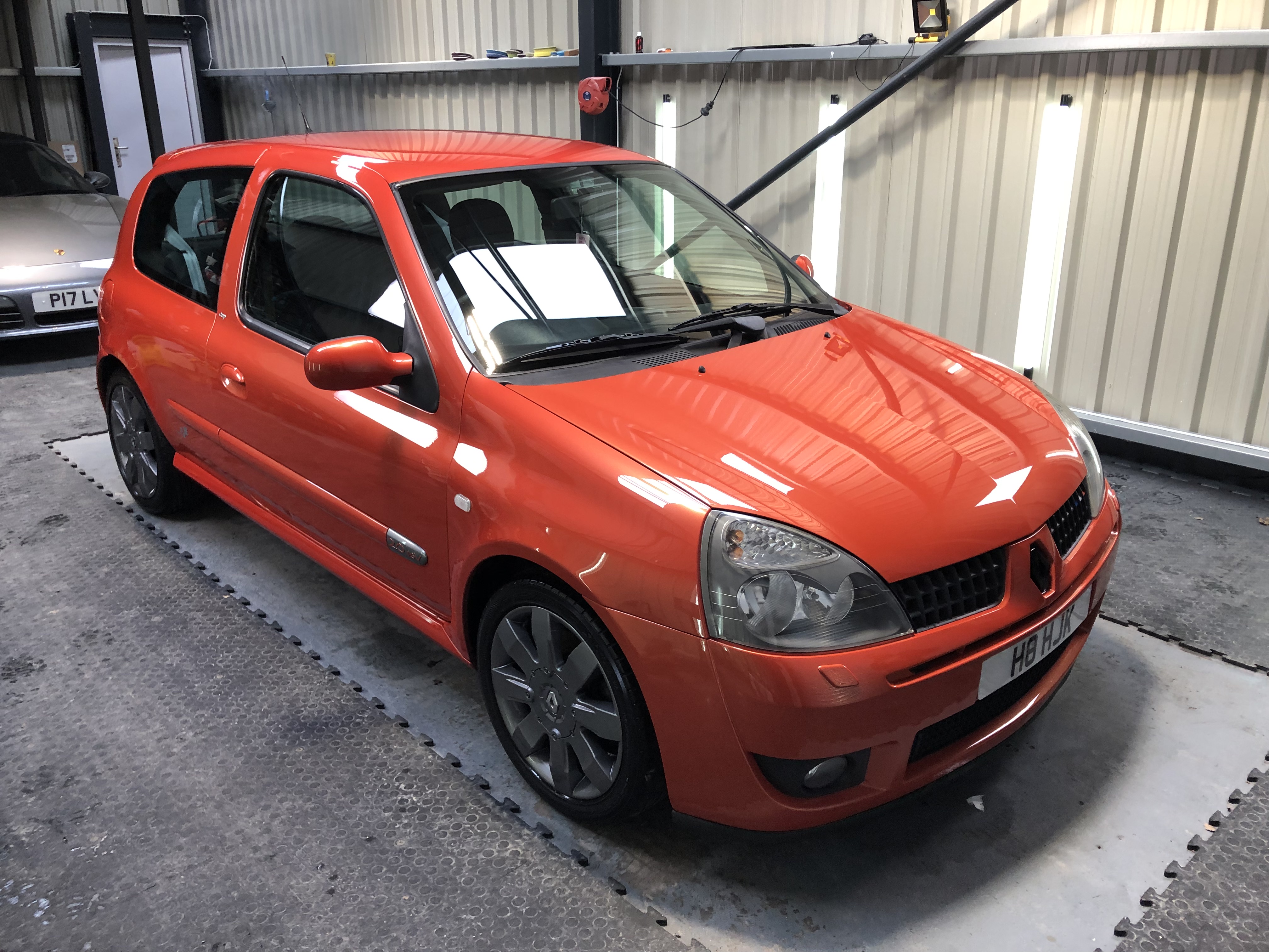

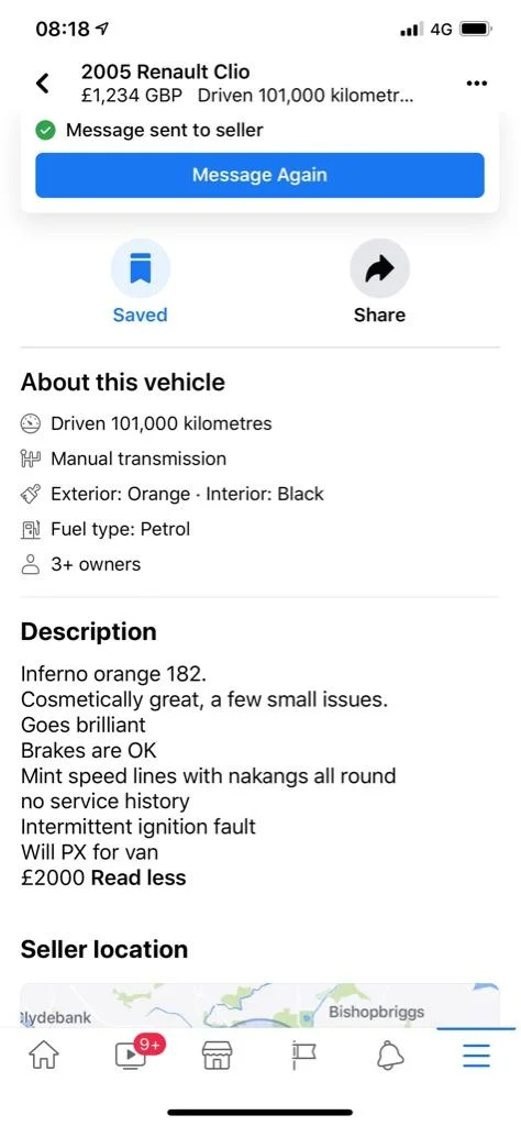

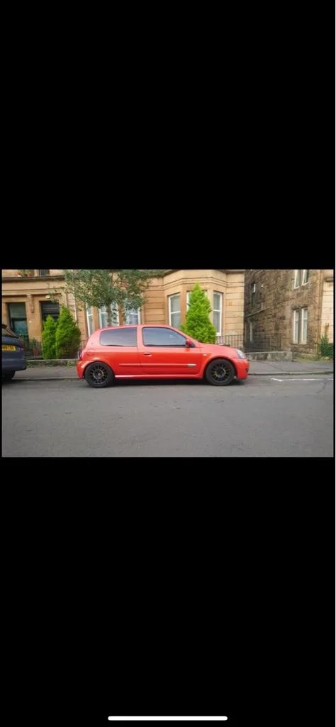

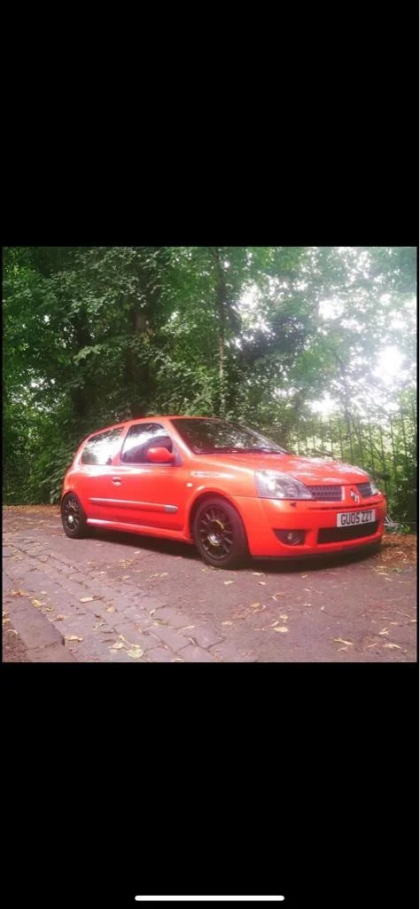

Then a few days later a poorly advertised inferno came up in Glasgow. Listed at £2000 but it had some nice wheels and I was sure I seen it advertised before so maybe I could get it cheap. Here is the photos and advert.
100% the worst sale of a car I’ve experienced but I wasn’t bothered.
Asked for photos of the interior: “I don’t have any but it’s mint mate”.
Turned up to view it and the seller had to pop out just before so I had to wait about. I was with the wife and 2 daughters and there was a play park so we hung about there for a bit. Then I got to see the car. I knew it had a new starter the week before to try and resolve the starting fault but it wouldn’t start.
Here is my translation of the ad:
Cosmetically great. (It’s got a cracked front bumper)
Brakes are ok (they work, but the pedal jumps about
like an ABS fault all the time).
Ignition fault. I think he meant starting fault. But it bump started fine.
That’s the bad bits.
But there is some potential and some good bits.
1) goes brilliant. (Well actually it does go quite well. Engine feels healthy. Clean oil. Gearbox is perfect. Clutch feels ok as well.
2) interior is actually ok. Needs a good clean, standard steering wheel and gear knob insert.
3) it was cheap. The guy was keen to get rid so I got it for £1400 with the speedline wheels I would consider that a decent buy.
4) wheels are in good condition. I’ve put theee up for sale already. I’ll prob put the car back to standard.
So deal done I drive the car 30 miles home without issue.

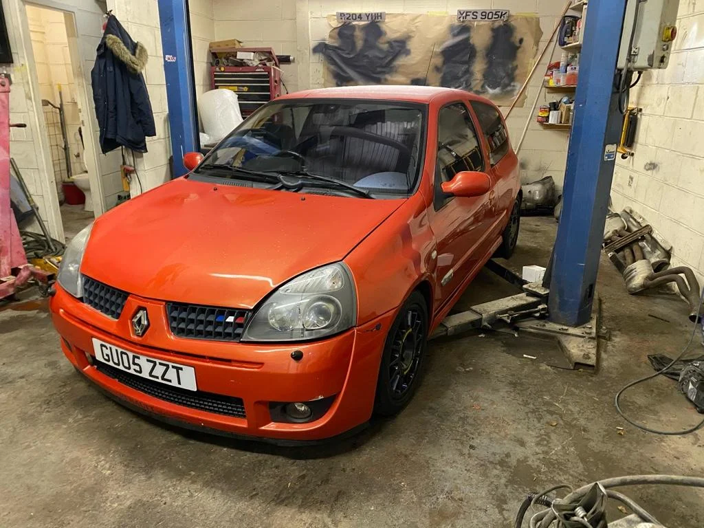

So on to the plan. I got the car back Saturday and just Parked it up at my unit. I had a busy weekend and it had already taken half a day to buy the bloody thing.

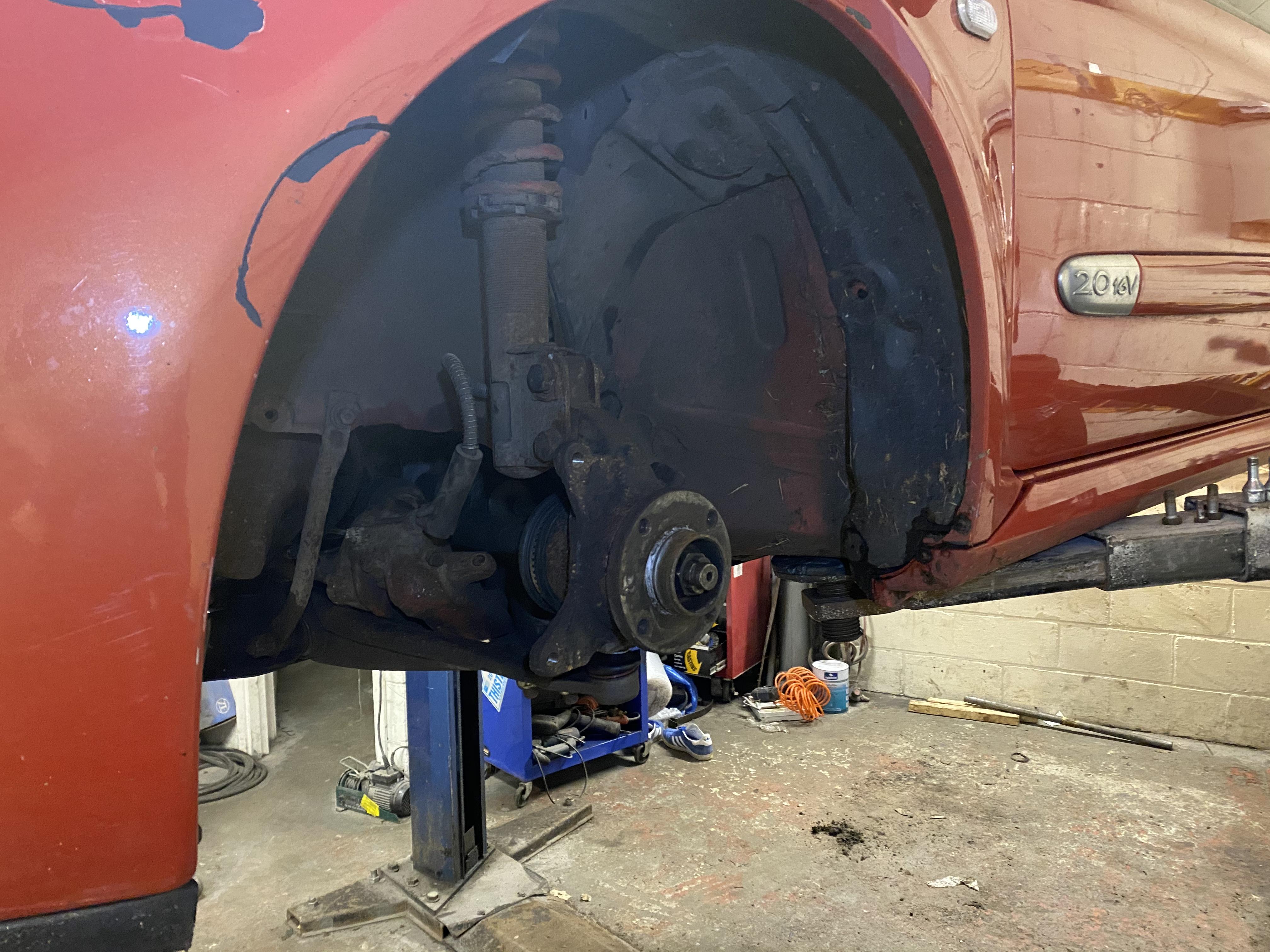

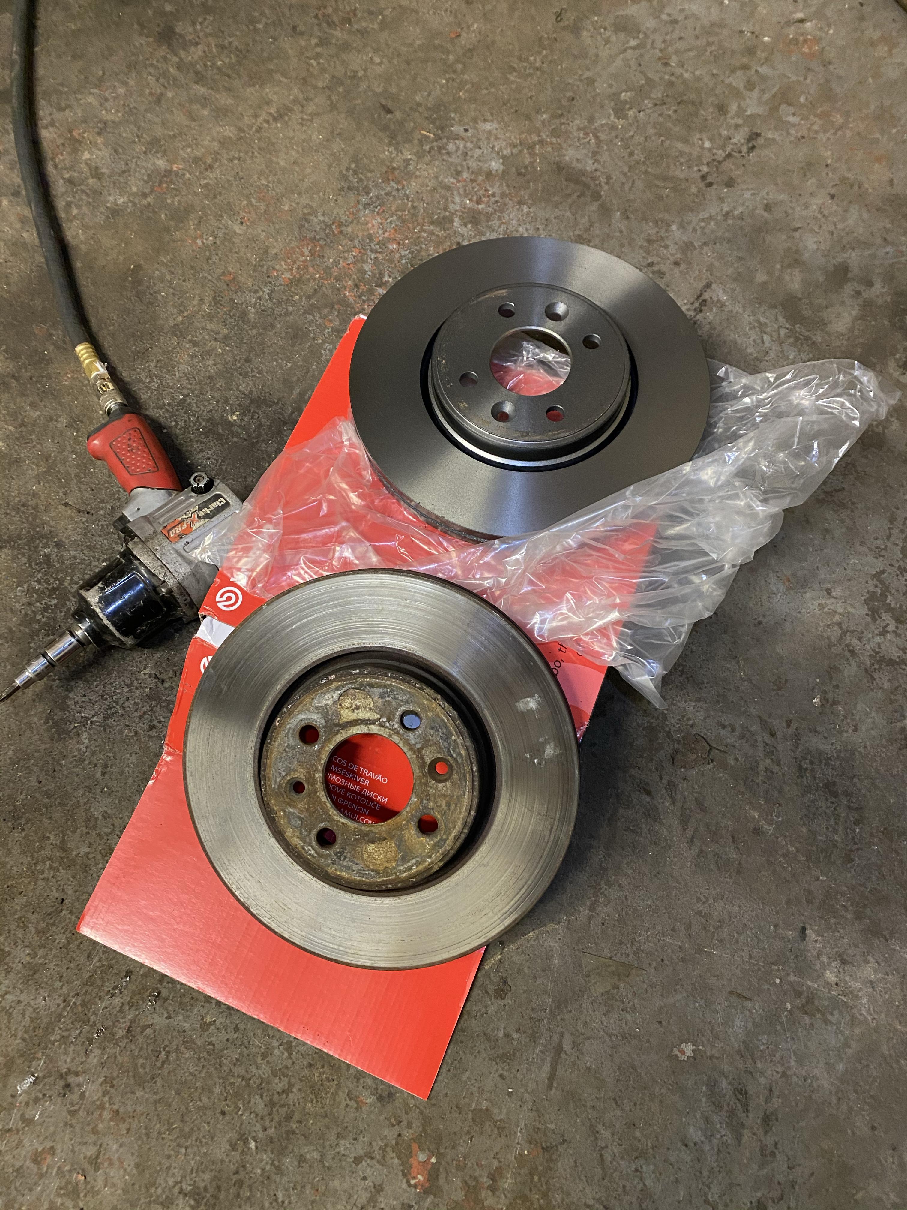

I got a good look at it last night. I took the wheels off and had a look at the brakes.
Having gave it a look around I’m pretty happy. I think the brakes are just a warped disc. They all look in ok condition and I recon maybe only 10k miles on them looking at the MOT history but I’ll check with a DTI and see if that’s the issue. There are no abs lights so don’t think it’s that. The rear drivers side callipers is tight as well so this might be the cause.
I’ll update the plan as I go along. Still undecided but a cheap standard inferno is the aim.

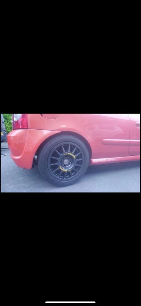

Wonder what people’s opinions are on the route the car shout go. It’s got some cheap static damping coilovers on it, an aftermarket air filter, scorpion exhaust and the speed lines obviously. But it’s standard otherwise. It’s also a non cup pack car.
Do I go standard including suspension and wheels?
Give it a cup appearance pack (I’ve got a spare spoiler I could paint). Maybe even grey wheels, I think they suit it better.
Or keep it slightly modified?
That is a real bargain! Especially with the Speedline wheels. Cup shocks with eibach sportlines or similar, set of 182 wheels or Turinis, Cup spoiler, although I quite like the standard ones and all the usual maintenance stuff. I am a bit bias though...
That is a real bargain! Especially with the Speedline wheels. Cup shocks with eibach sportlines or similar, set of 182 wheels or Turinis, Cup spoiler, although I quite like the standard ones and all the usual maintenance stuff. I am a bit bias though... View attachment 1503170
Yeah I’ll have a think on it.
I think if I was going standard I would still go with dark grey 182 wheels. Don’t think inferno suits the silver wheels.
I actually really like the standard 182 wheels in Anthracite. Seem to suit the 182.

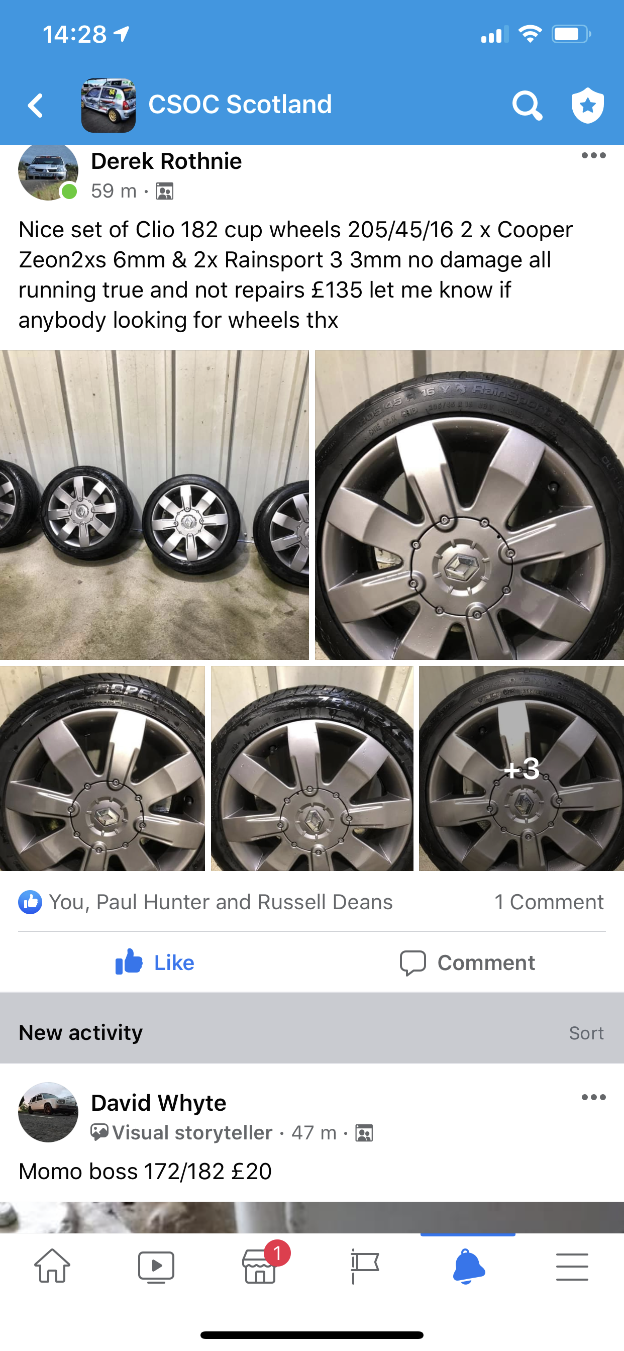

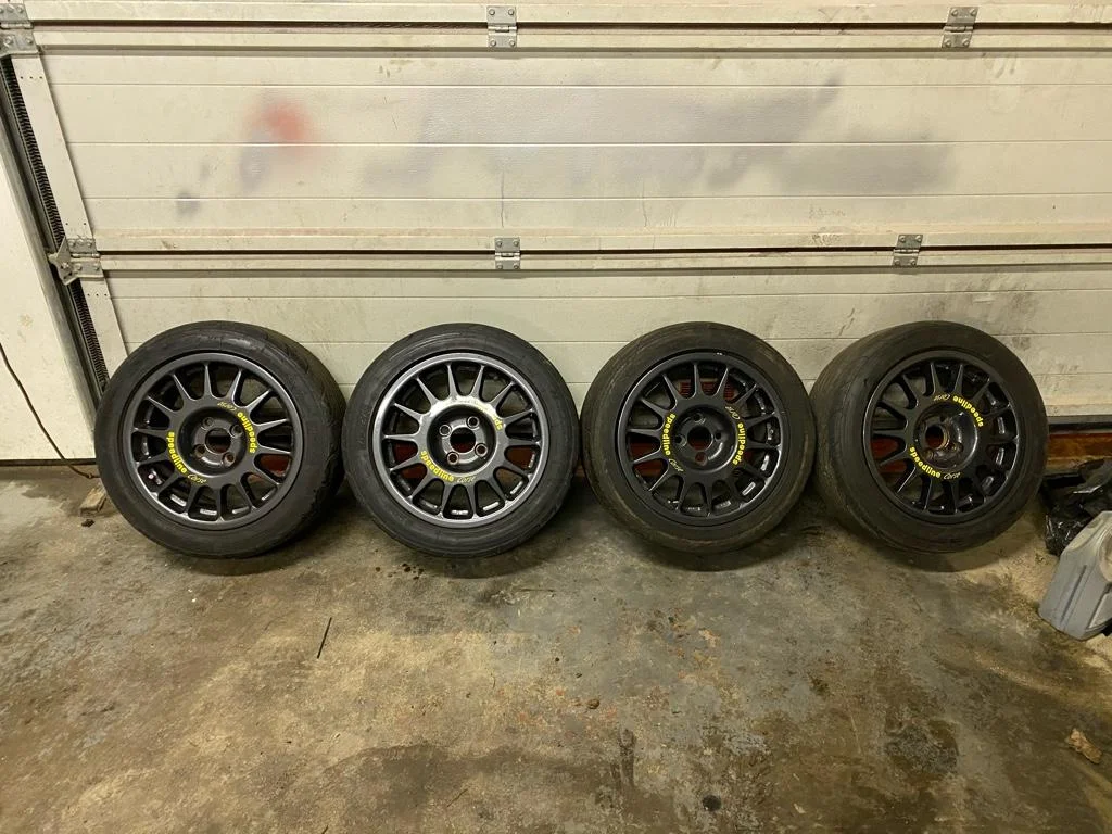

These are the wheels I’ve bought from a mate. Only issue is he is in Aberdeen area and I’m not supposed to drive outside of West Lothian during current restrictions. It’s about 2:30 drive and I was going to take the family a day out. I might just need to courier them but was hoping to avoid that.

First of all I’ve changed the front brakes. Still have the odd braking fault but they needed done anyway as they were slightly warped.

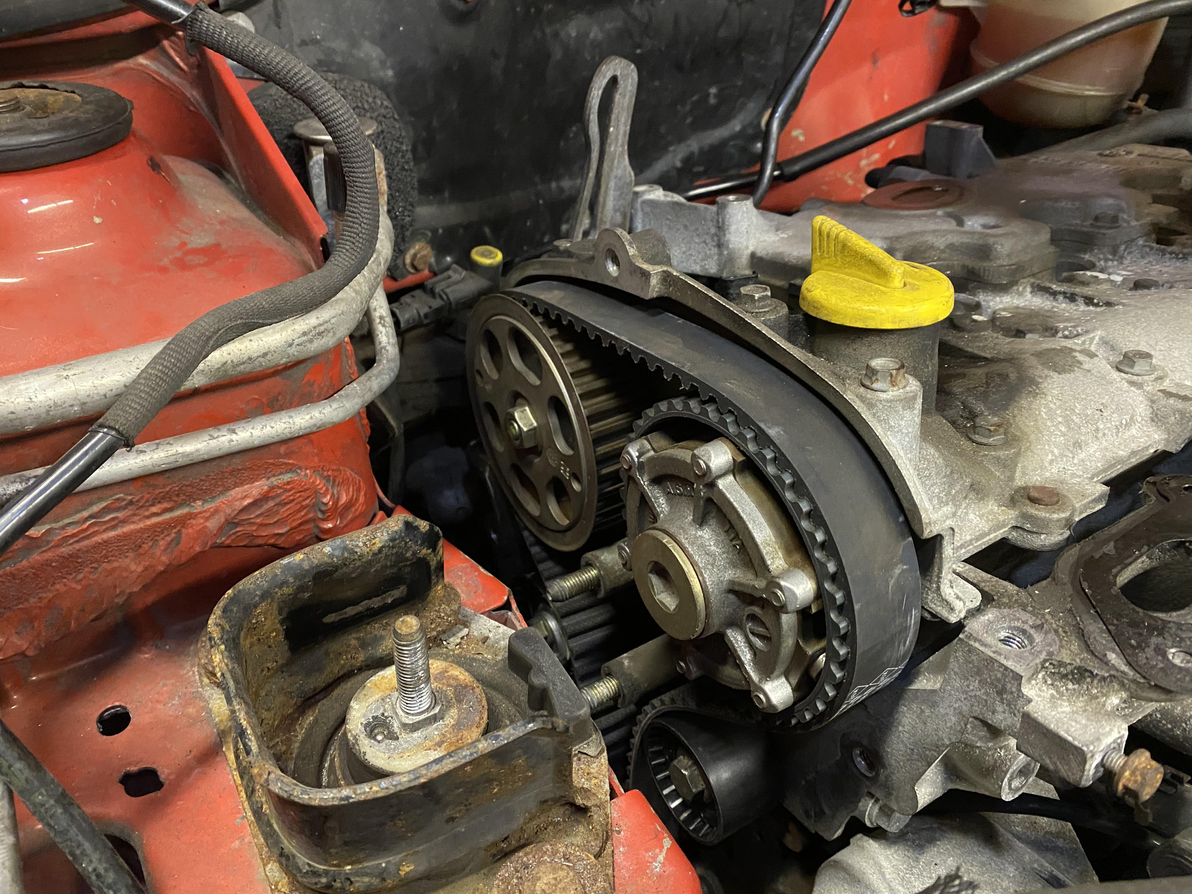

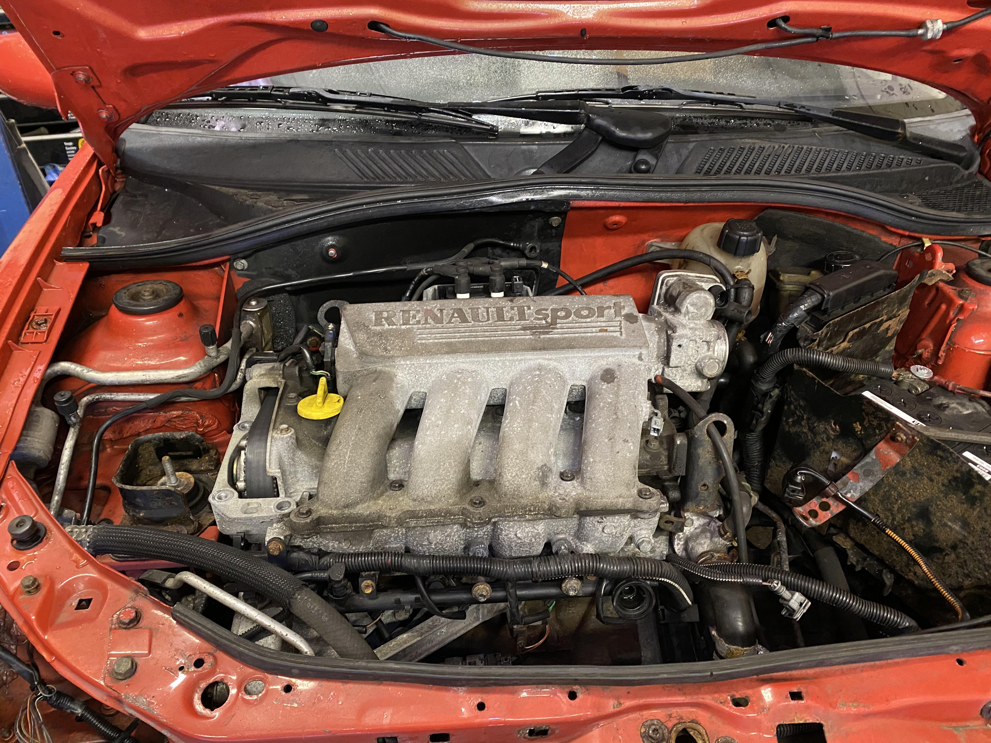

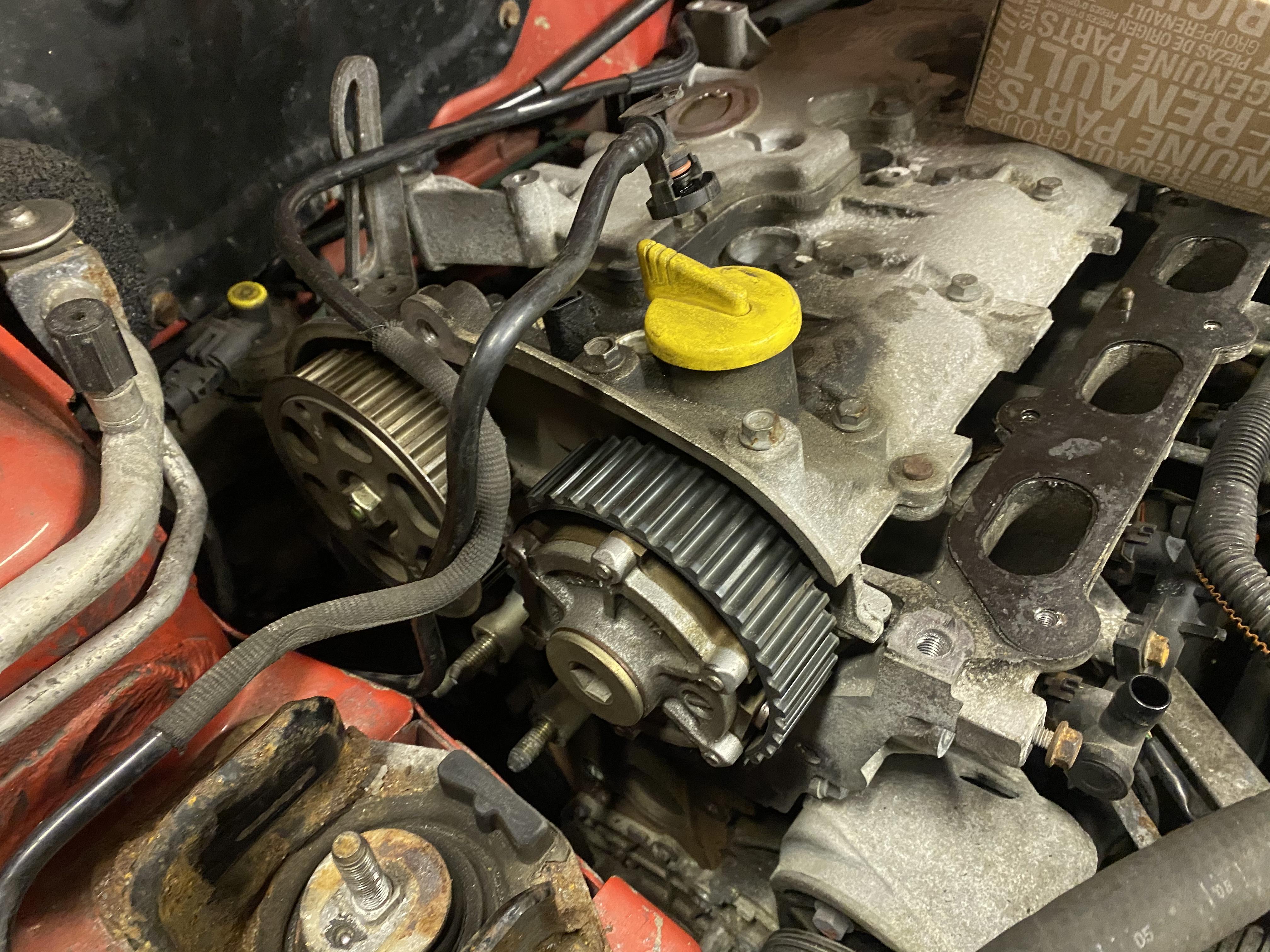

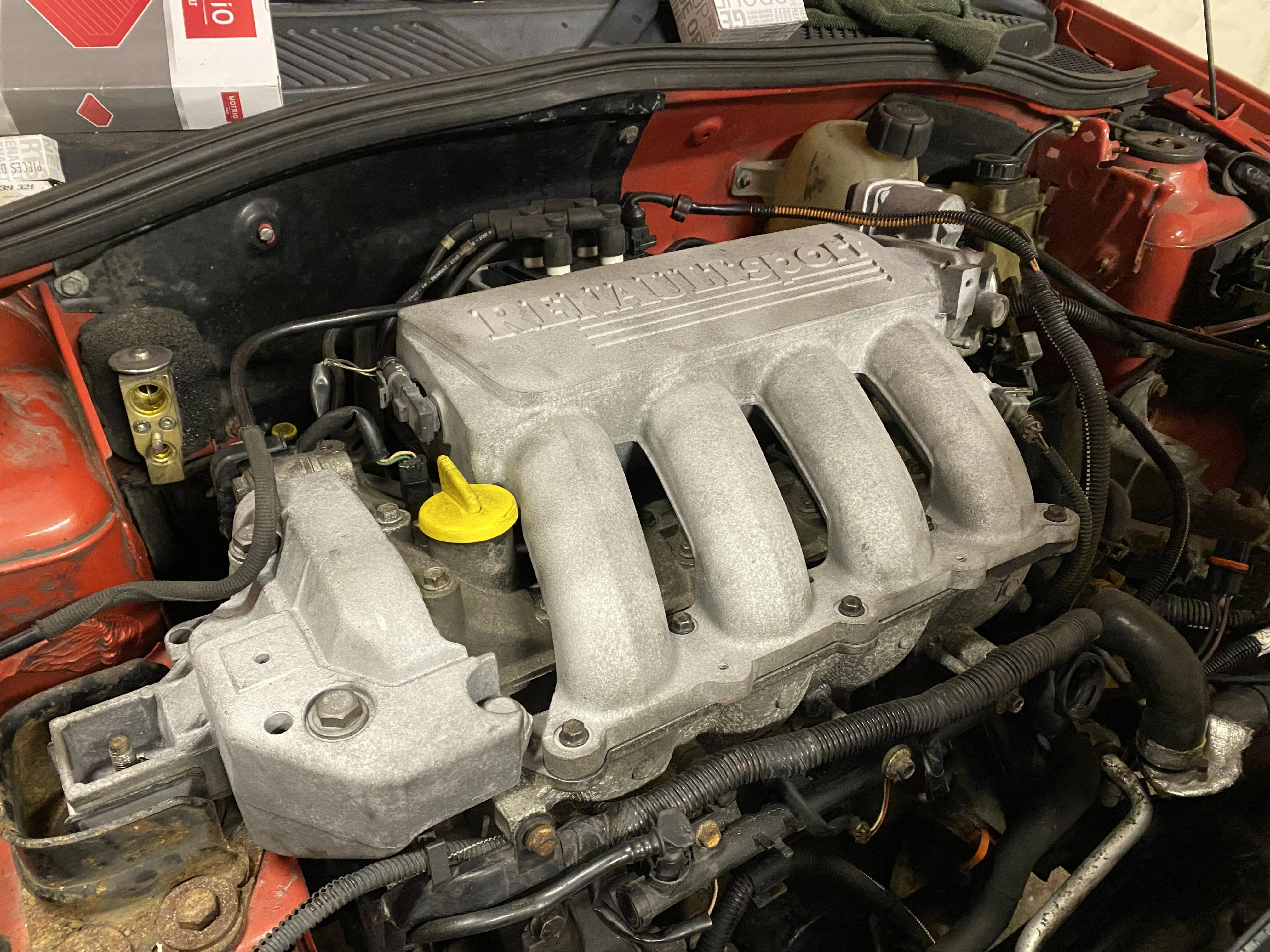

Then today I started the cam belt change. A few things discovered while doing the job.
The timing was out slightly. So good job I’ve checked.
The belt doesn’t look that old. But I’ll change it anyway.

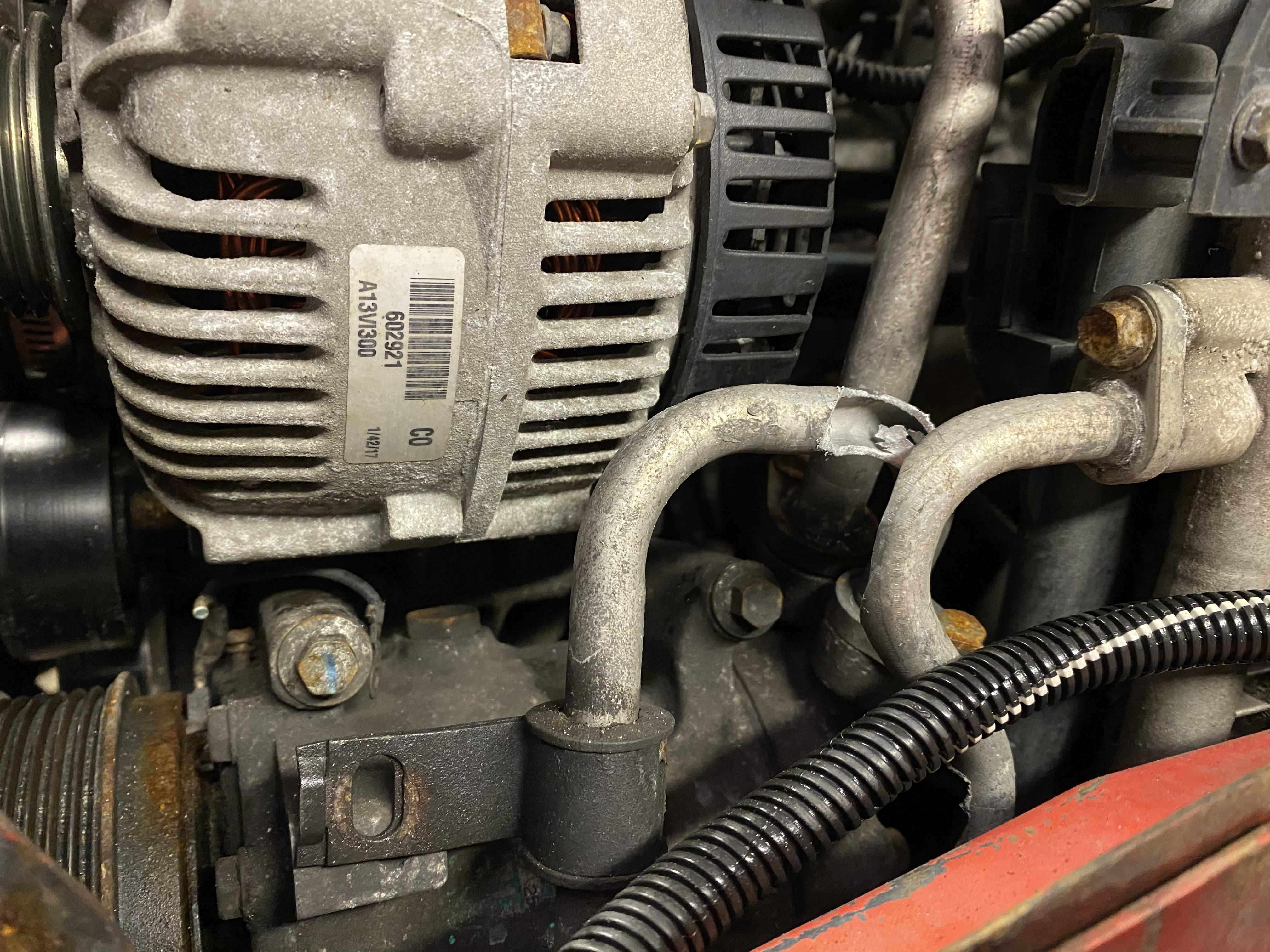

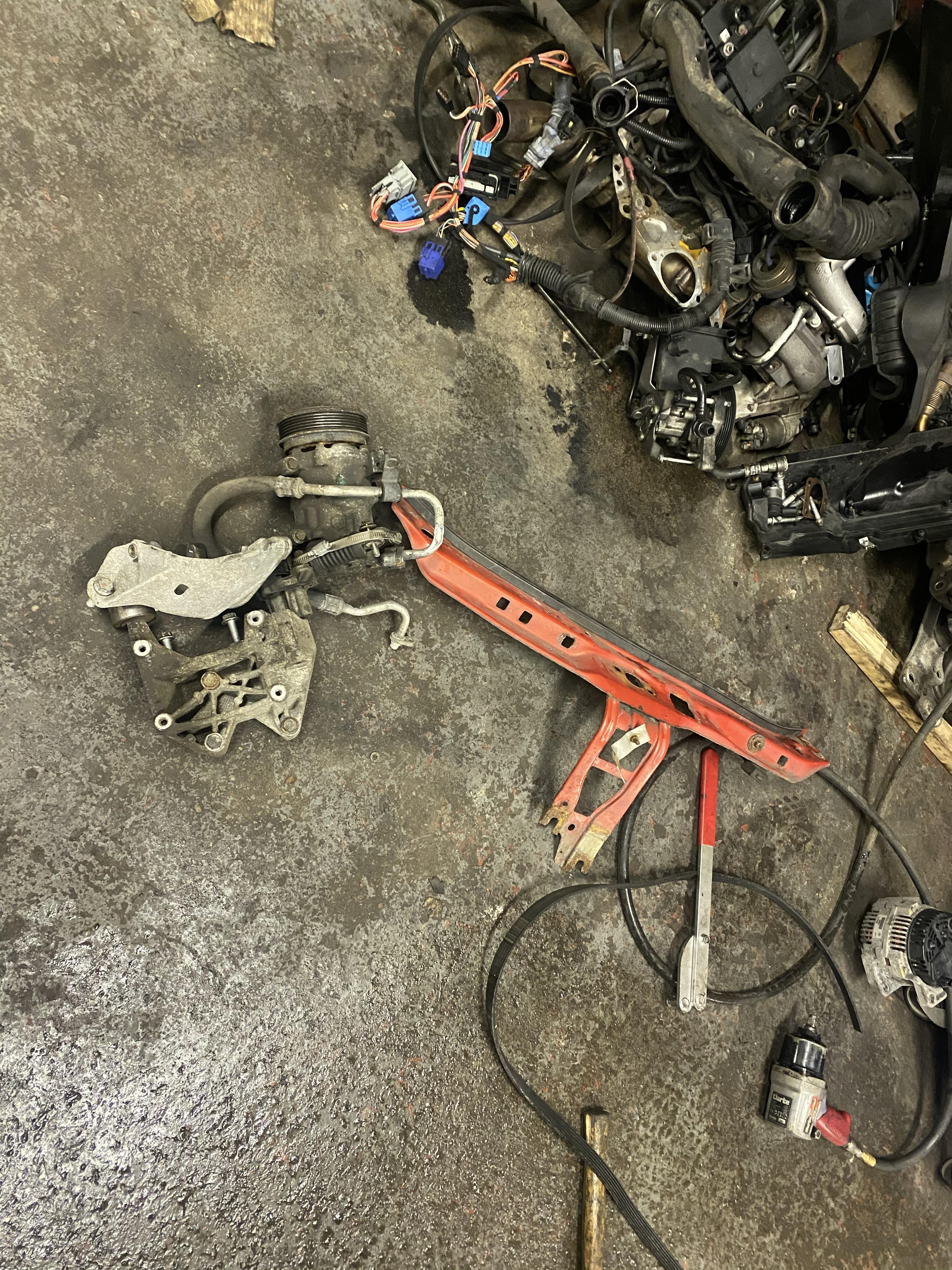

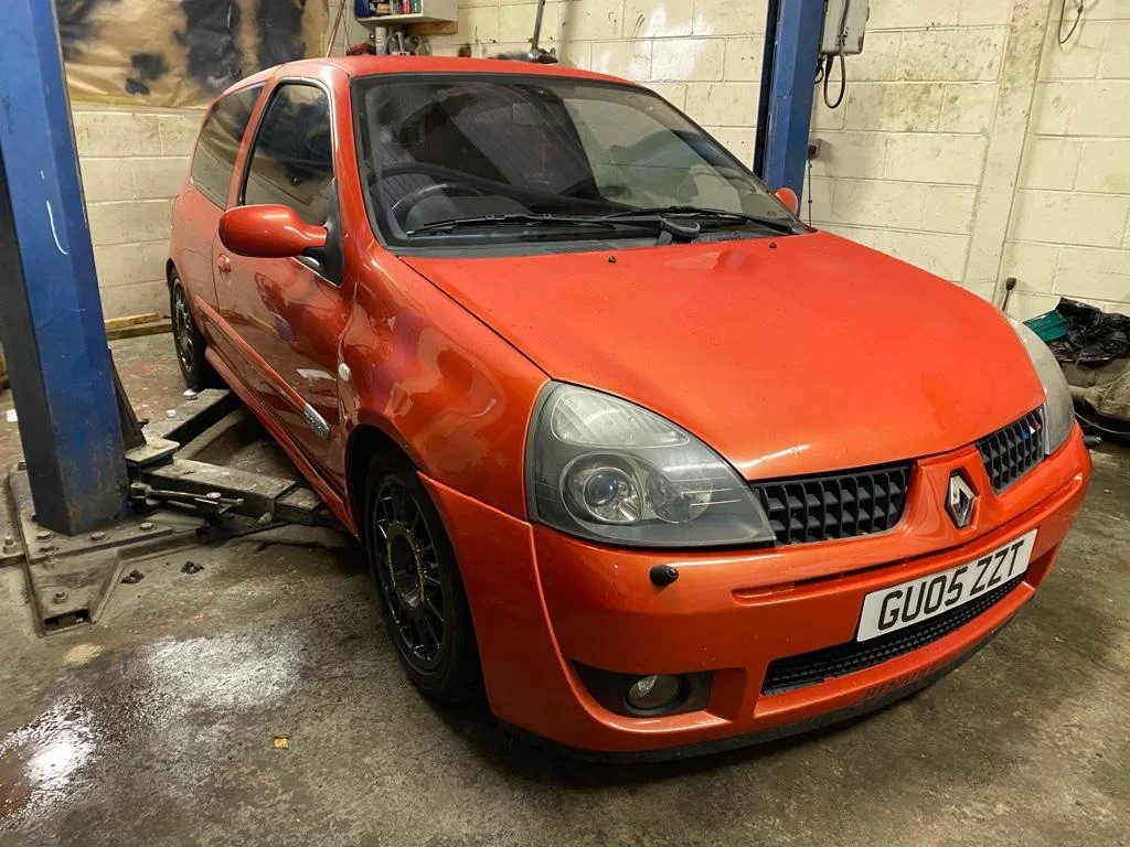

The aircon pipes have been punctured. And this brings me to my next question.
Do I:
1) just replace the belt, leave the aircon in place.

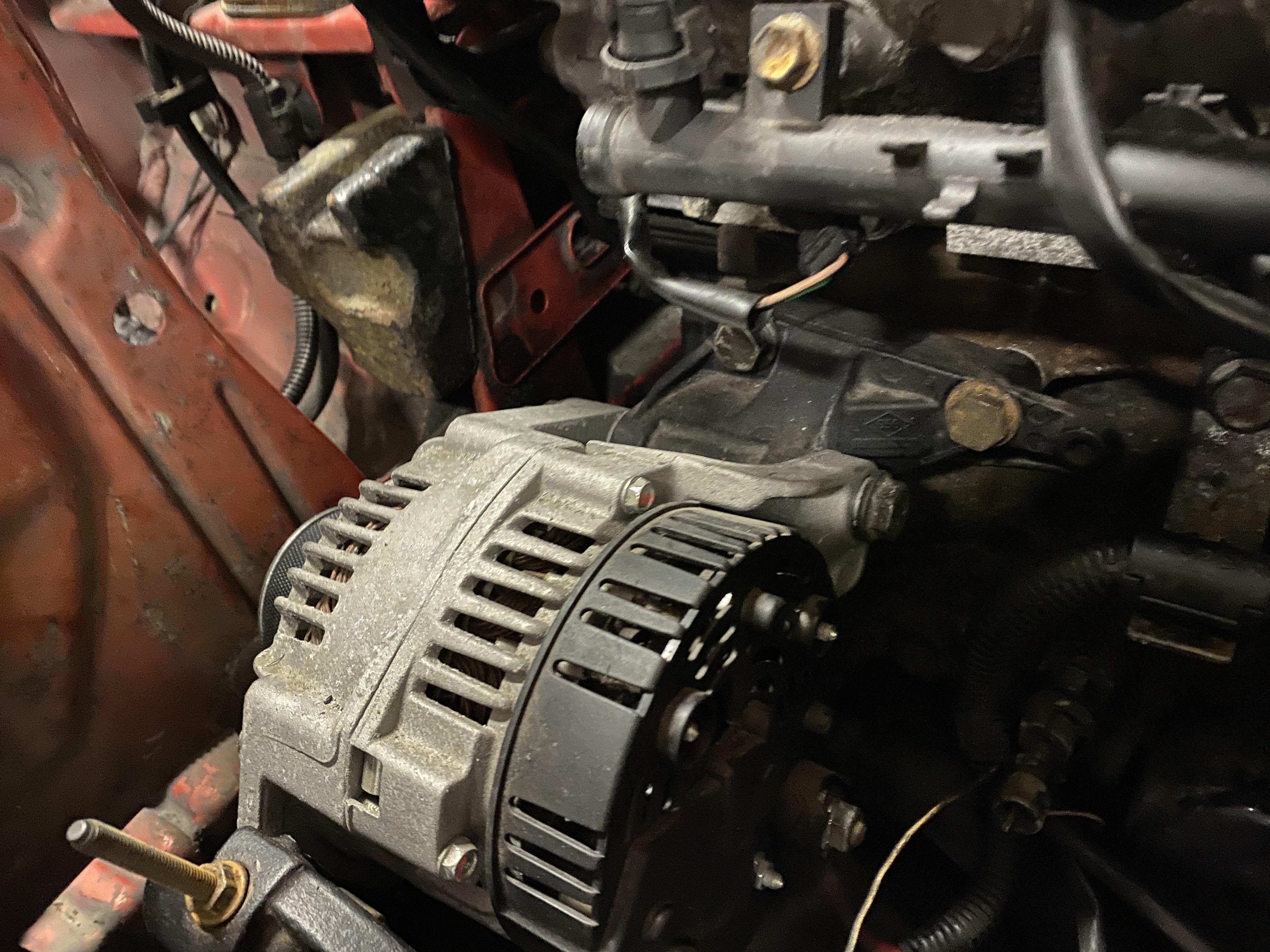

2) fix the aircon as well. I’ll need to source second hand pipes and a new condenser rad. Possibly swap the compressor out as well (it had some loose wires)
3) go for a cup alternator setup. I’ve found one local from a guy breaking a track car.
Interested in opinions. I don’t thing the aircon would be missed. I think the cup setup and fixing the aircon fully would but come out the more expensive options but I don’t like cutting corners on this stuff.

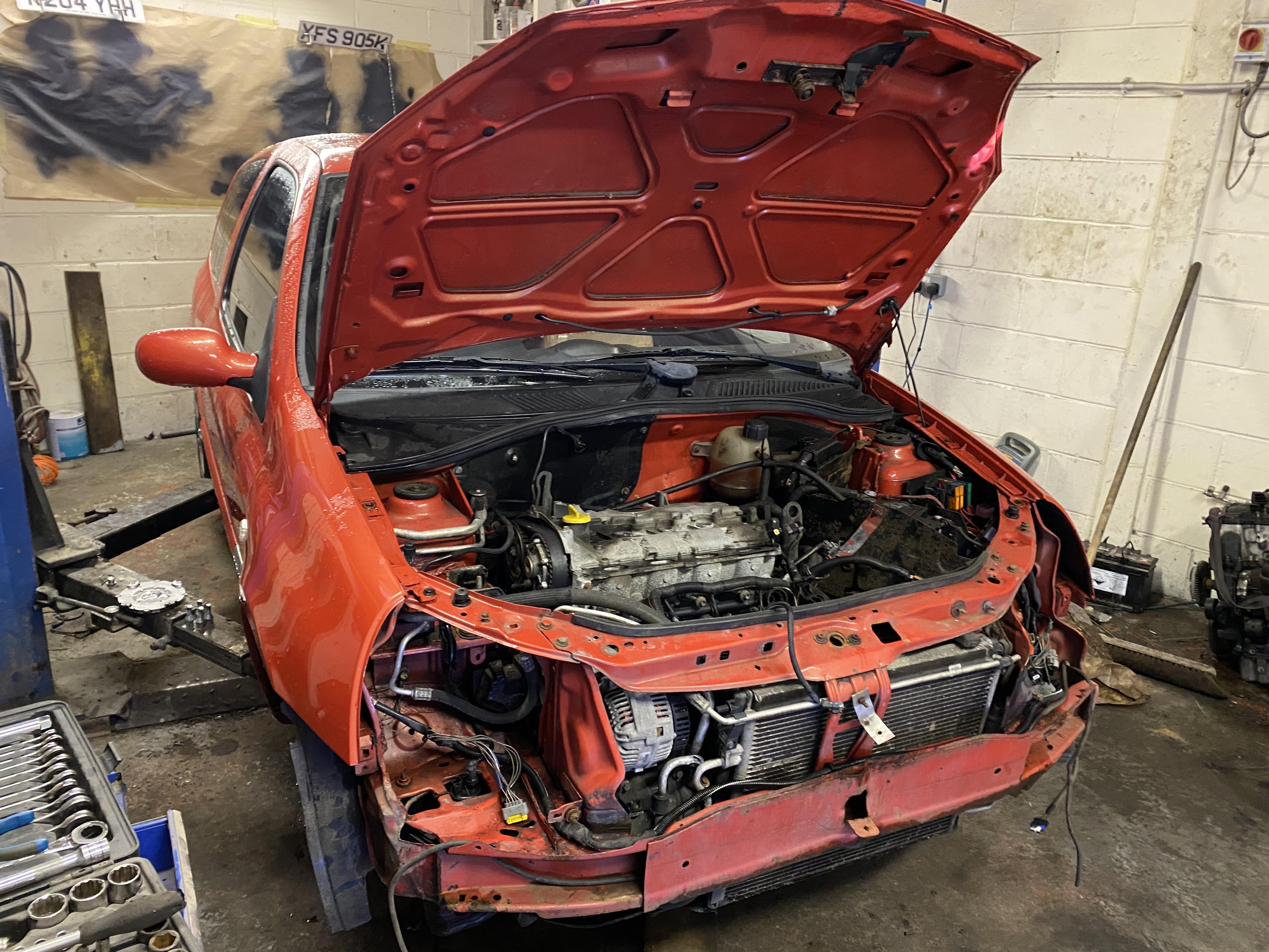

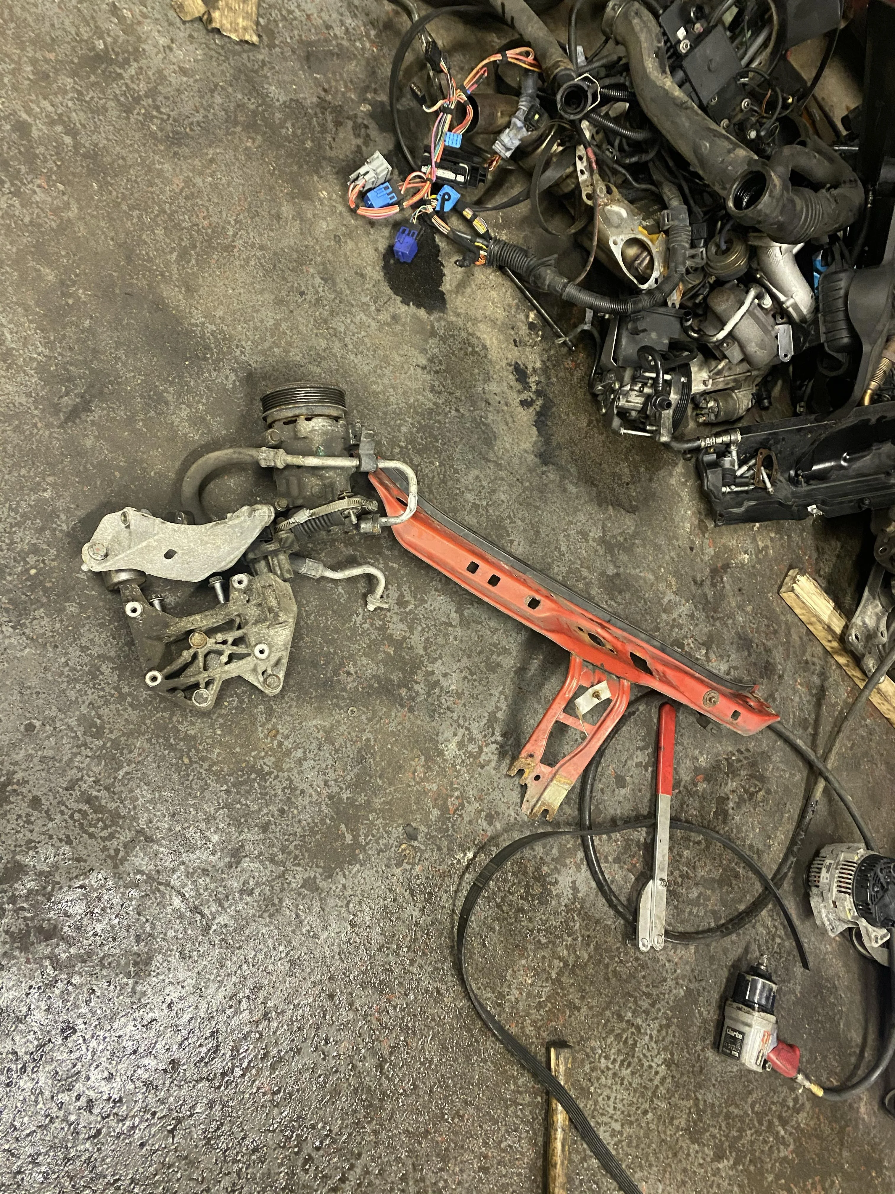

Did the guy bother to mention that to you?
Looks like they've tried to bodge it and make it look less s**t because they've zipped the upper angle off completely 😂
Looks like they've tried to bodge it and make it look less s**t because they've zipped the upper angle off completely [emoji23]
He didn’t need to and you will see from the first post it’s pretty obvious with the cracked bumper and the front end alignment was all over the place.

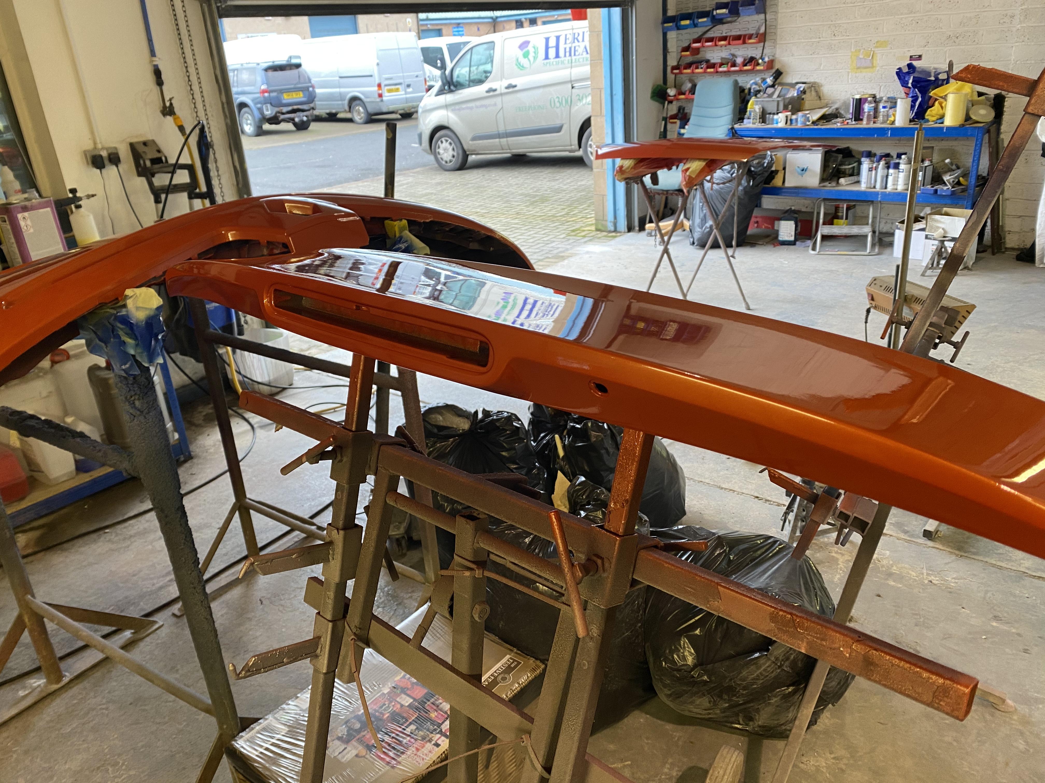

Good thing is it’s a pretty easy fix. The chassis legs are straight. I’ll straighten up the crash bar. Paint it. I’ve got another bumper lined up and I’ll get a new grill. It’s going in for the passenger wing bumper and cup spoiler to be painted.

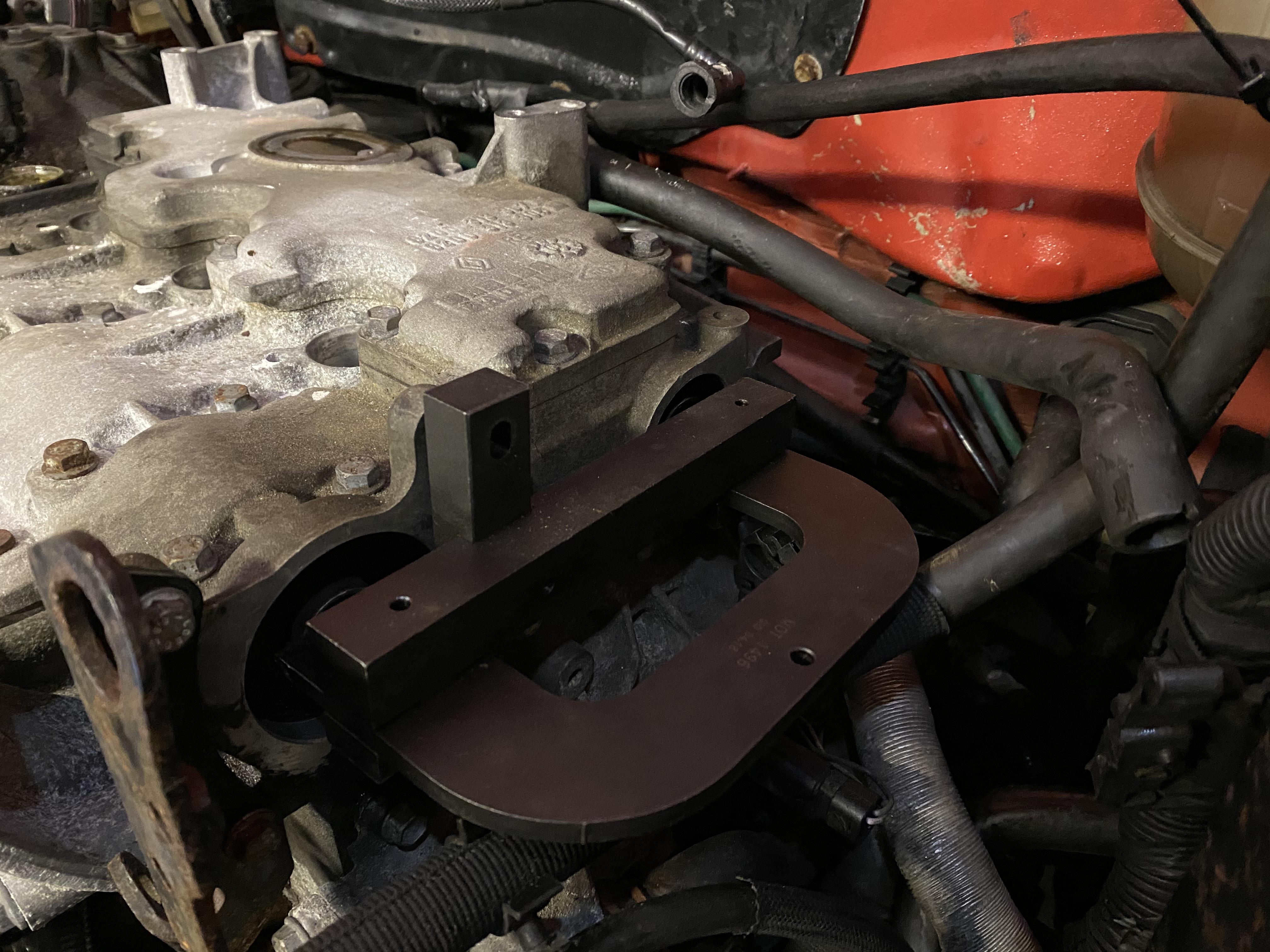

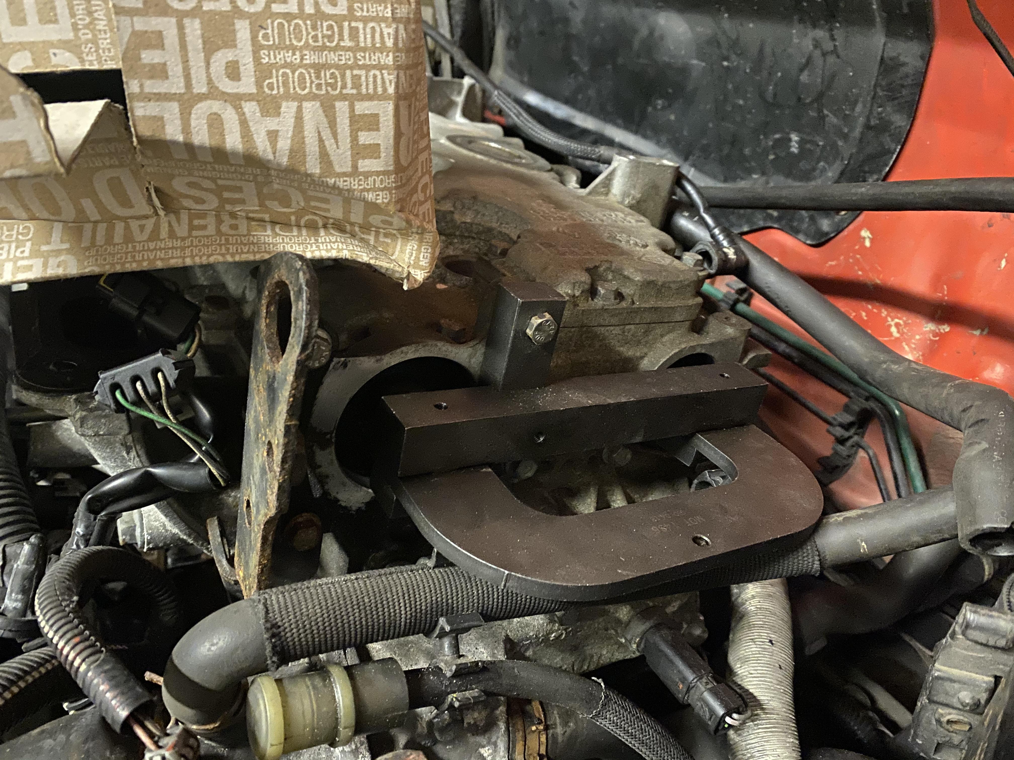

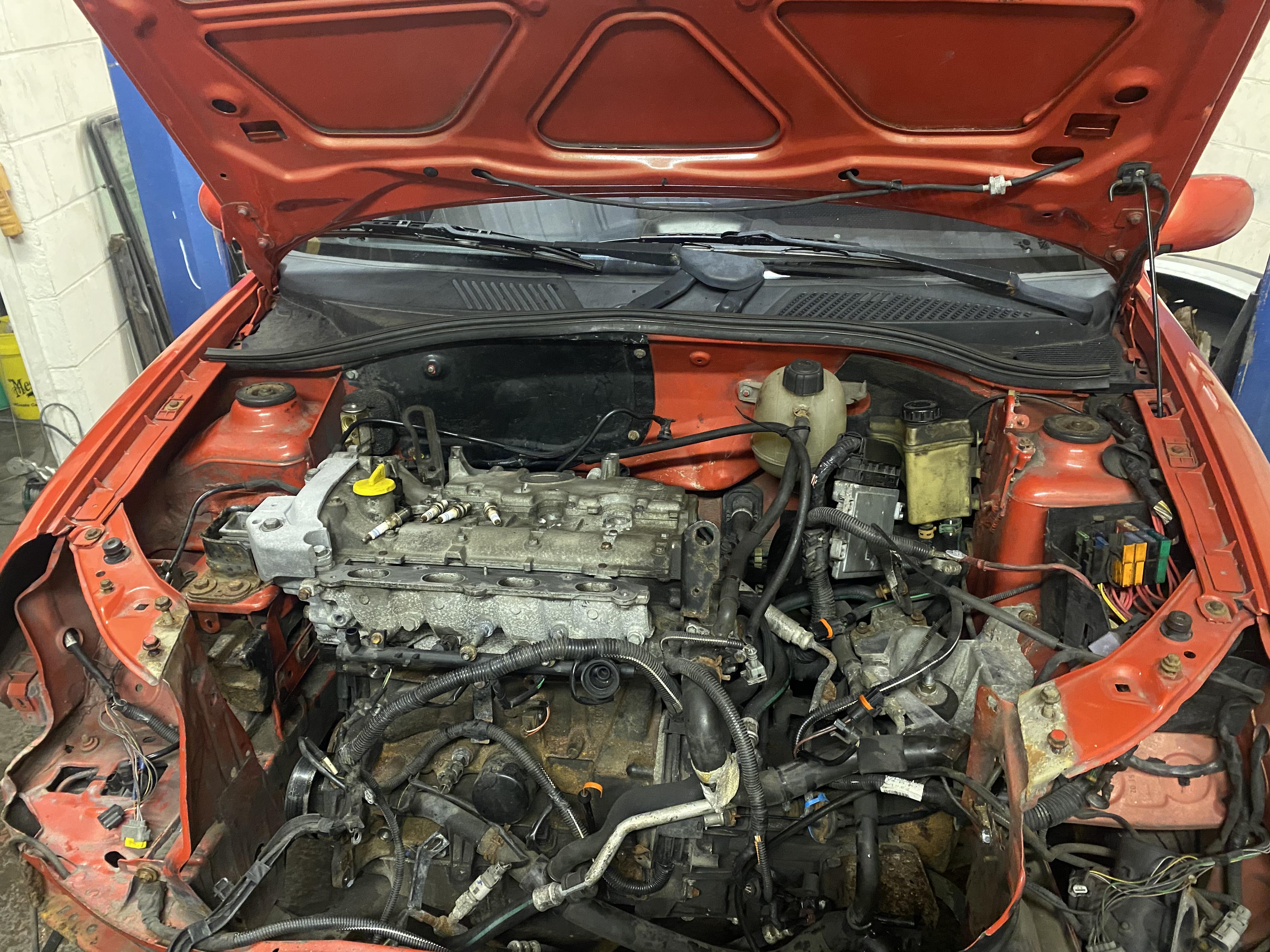

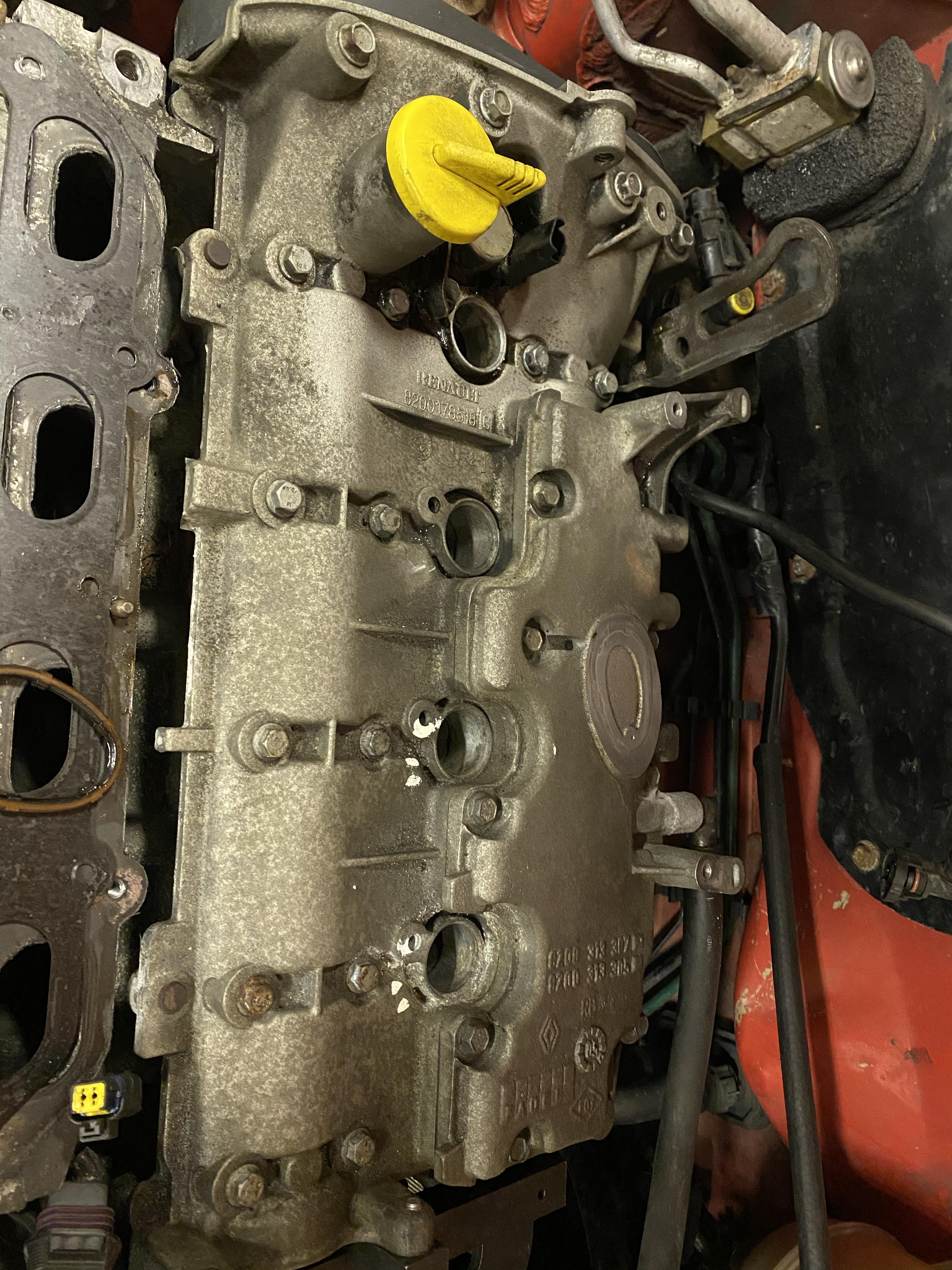

More work done tonight. Belts off and the timing tool located correctly.

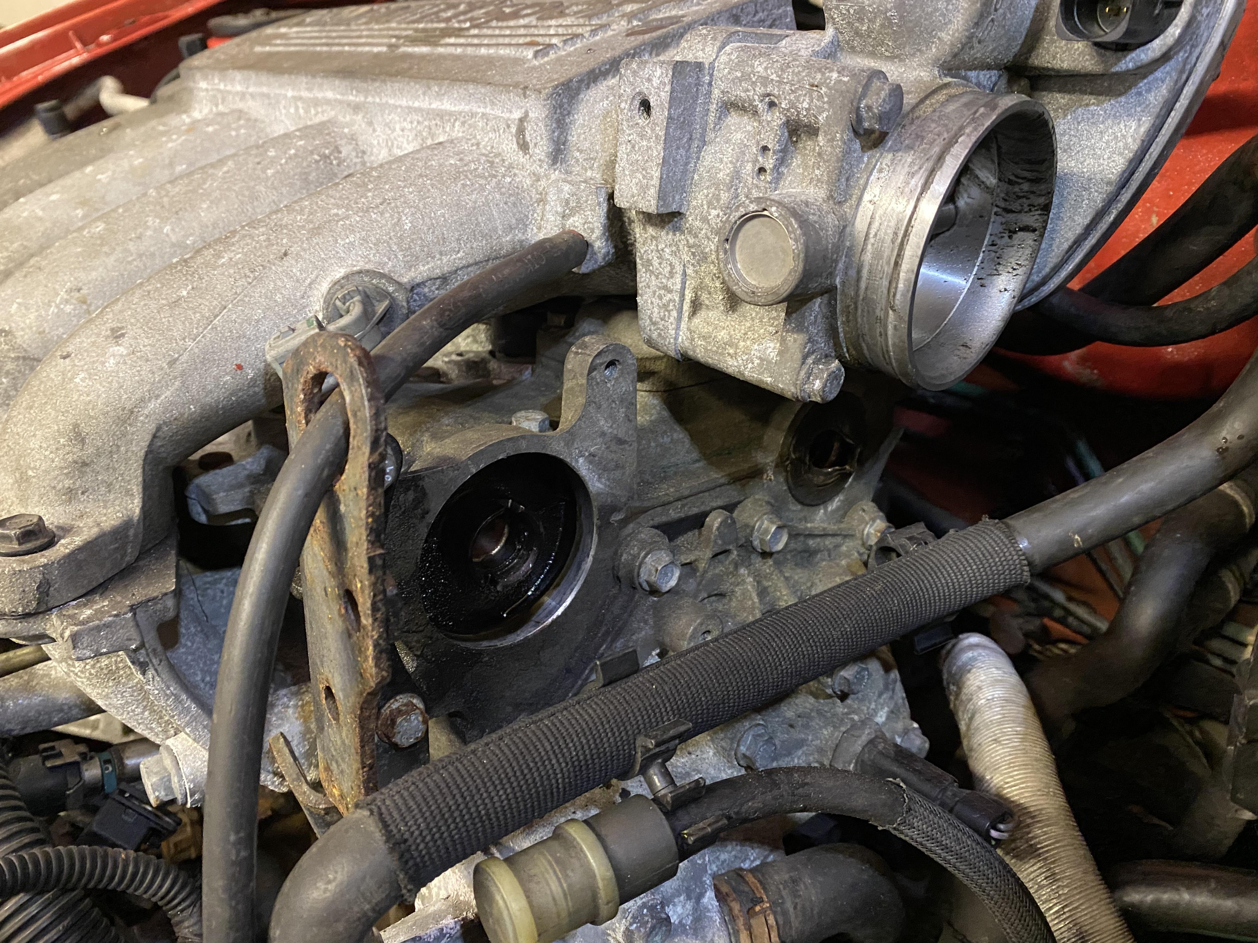

Belt only over the top two pulleys. I need to get the dephaser pulley loose so the belt all lines up exactly. The bottom pulley appears to be locktite in place. Which should stop it moving at least but I think that’s why the previous belt has been out a bit.

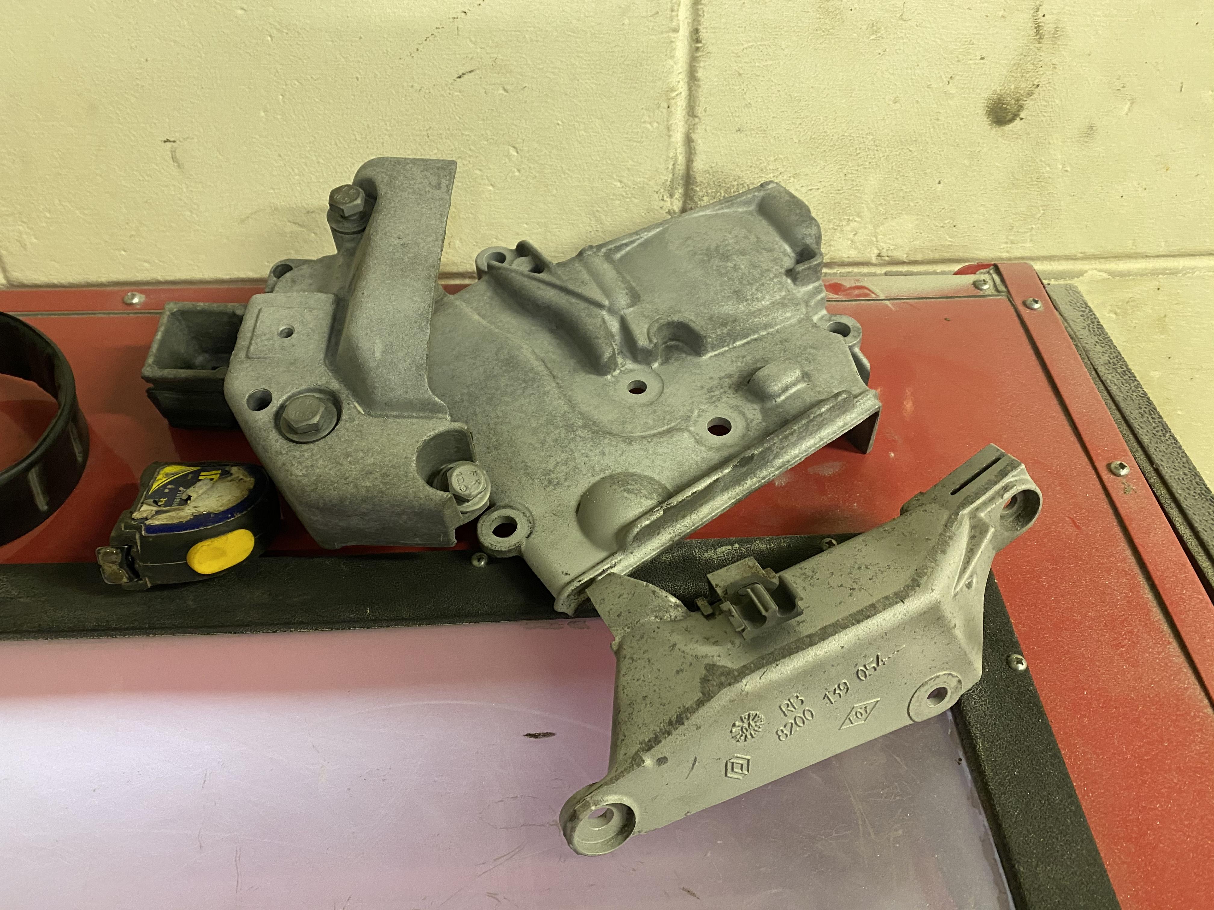

I also look a minute to blast the alloy parts so they go back in nice and fresh. Also poured some fuel on the cam cover and tried to get the worst of that cleaned up.
Decision made. Aircon is off.
Getting the aircon all back working was looking like a £200 job. I’ve got a cup setup including alternator for £150 and I’ll likely sell the 182 alternator to get some money back.
Also the rad out. I’m going to change that, looks like some idiot fired a standard clio rad / condenser in.
And finally. After 5/6 checks the belt is timed in and bang on. Should run nice.
Next is a new set of the correct plugs and a general service. Then it will be time to tidy up the engine bay.
