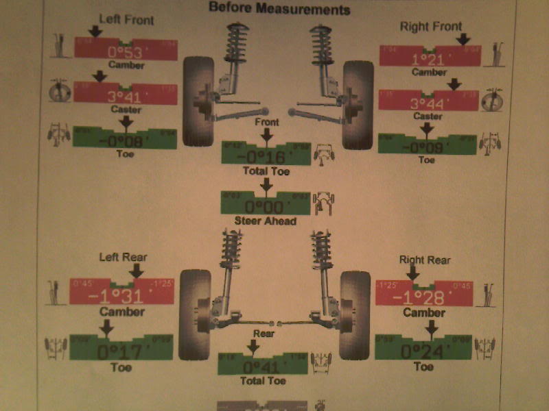

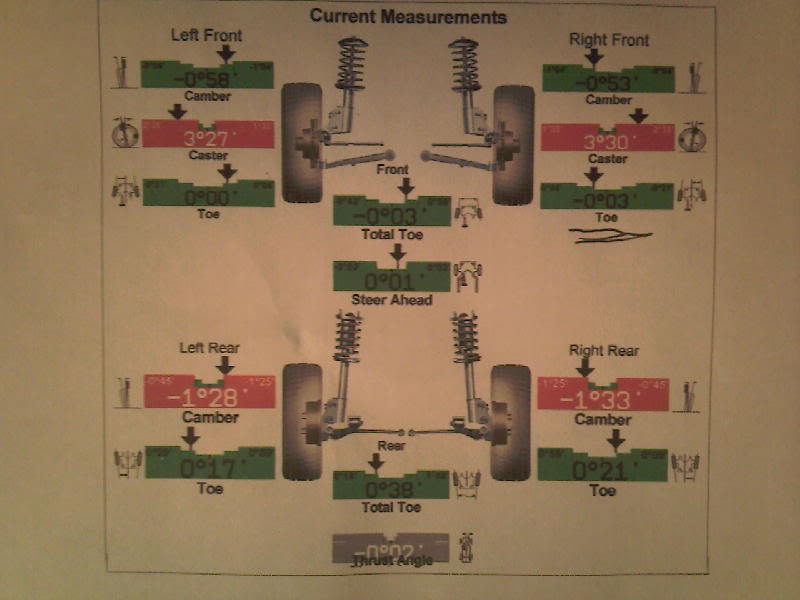

Printout after set up for anyone interested.
Gaz_
  Extreme mode
Nah, thats ok!!! half a degree we're talking here
Lol at the before measurements

I wouldn't be happy with that. Fred set mine up by eye, got the front camber within 0.1 r to l. Rear toe on the right looks high, bearings?
  TrackCar & F30 330d
I've seen your other thread, Take it back mate, it should be equal. Get them to do it right :) And make sure left and right had side are equal :)
