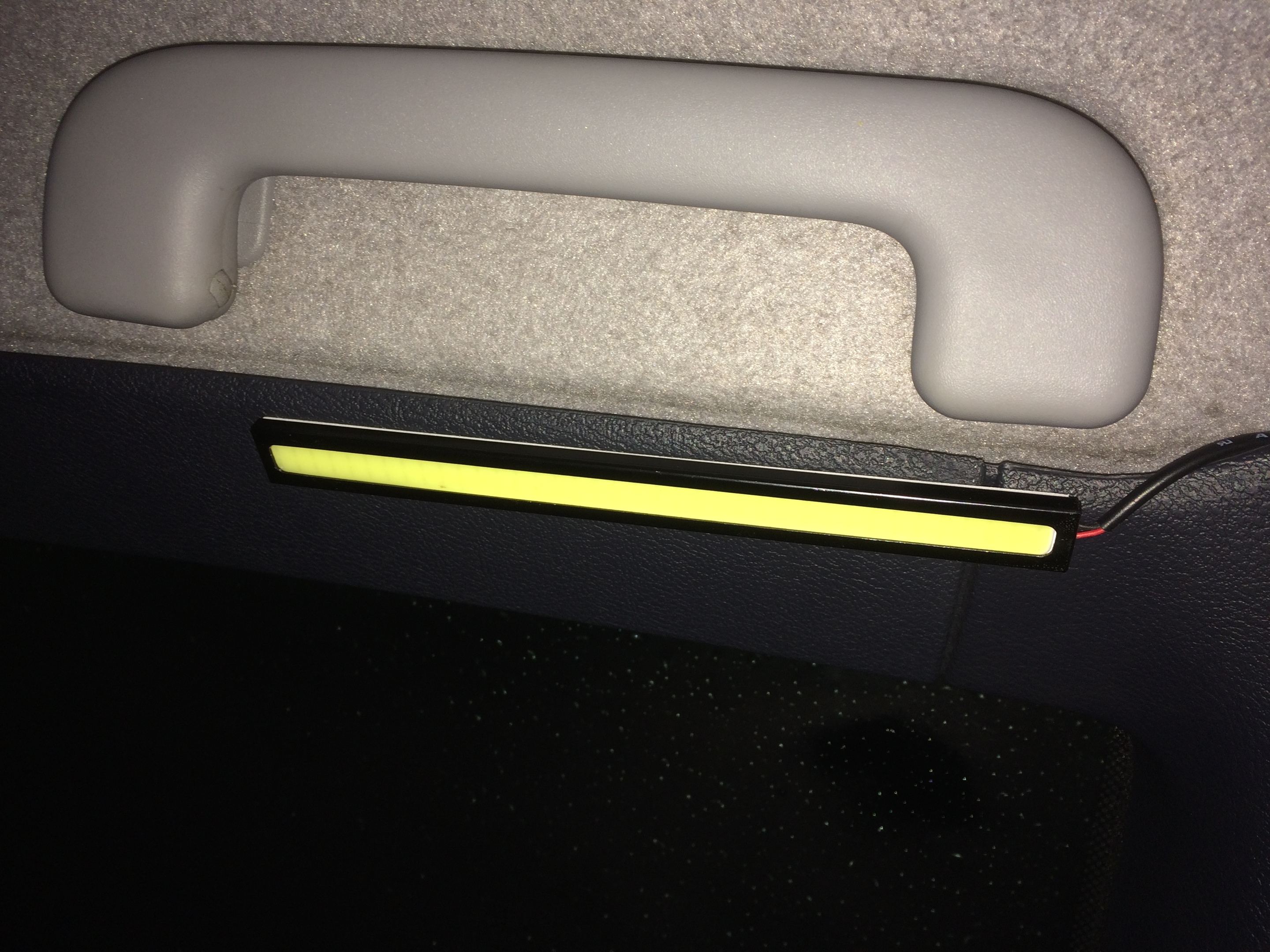

Yes, that's pretty much it AFAIK. If you want to make sure then pop the courtesy light out and follow the tracks to the bulbs - it's all on show and relatively easy to follow. My rear interior lights are connected directly to the tracks for the front interior light bulb, so the wiring in the connectors doesn't matter. That way they come on with the manual switch or the doors. I'd recommend doing that unless you specifically want the rear seat passenger to have a switch for them.
Do you have any closer pictures of the rear light? On and off.
