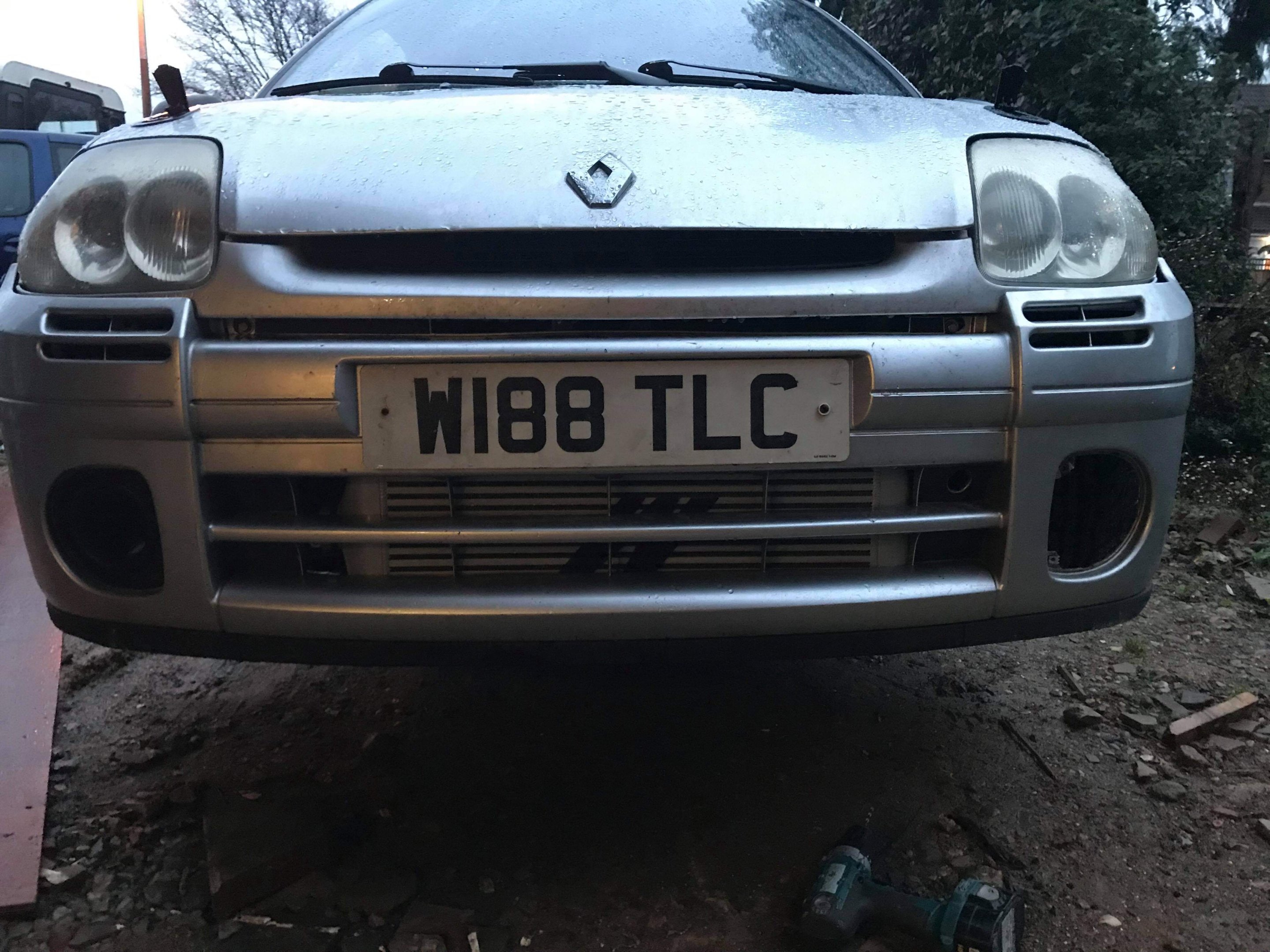

Hey guys, has anybody upgraded the Intercooler on their Clio 182 turbo? Mine has the ED Intercooler that I originally fitted with the kit.
Any info on size, make would be appreciated without me having to do loads of research!
Cheers

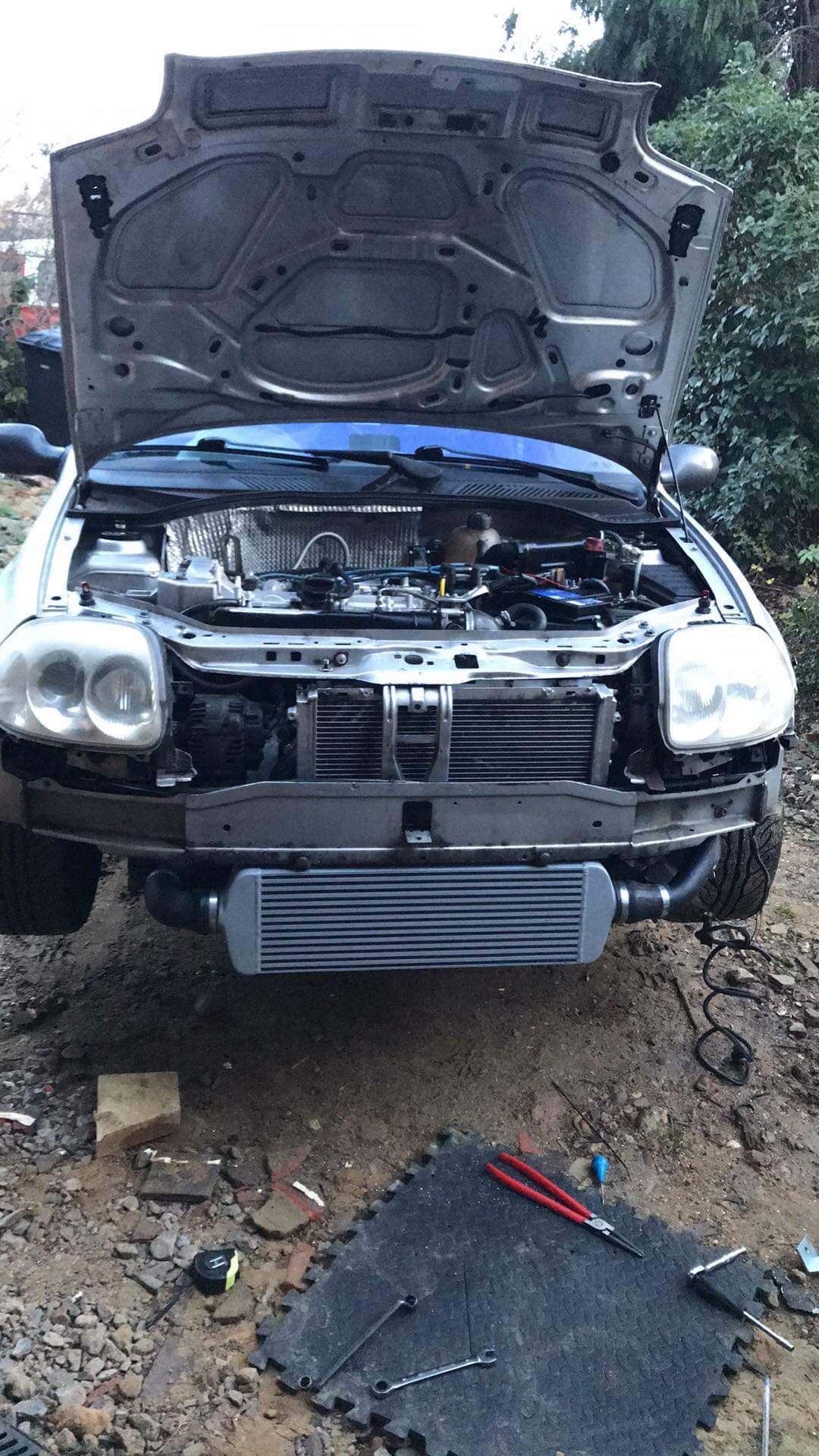

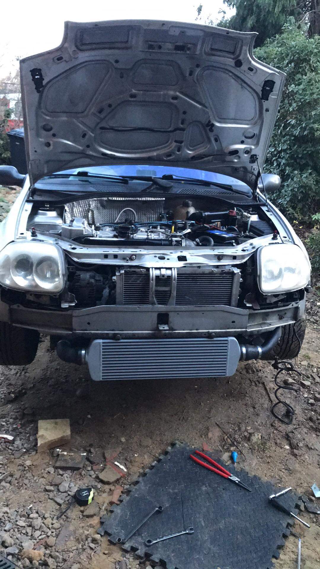

Yep..
Much better than the cheap ebay ones.. My brothers megane engined made more power with less boost after swapping to this intercooler as it was so much more efficient and cooled the charge air well.. The gt2560r turbo he has is pretty much at its max at around 1.2 bar making 300bhp on the megane engine which needs more boost compared to a clio engine to make good power.
Just about fits under the crash bar but needs slight modification to get it as high up as possible
For the price I don't think you'd get a better cooler, rated to 500bhp too apparently

Excellent, thank you for that, I will have a look into it! Looks like it should go in okay without too much fuss... may go for a black one too [emoji106][emoji106][emoji106]
Ideally the crash bar needs trimming to get it to sit a touch higher as the bumper covers the bottom doesn't require anything too drastic.. And yeah I would 100% get the black one as the silver paint is a bit naff
Really tempted to get this too. Is there two mounting points at the top of the intercooler?
Only had mounting points on one side unfortunately hense why its mounted upside down on my brothers car ?

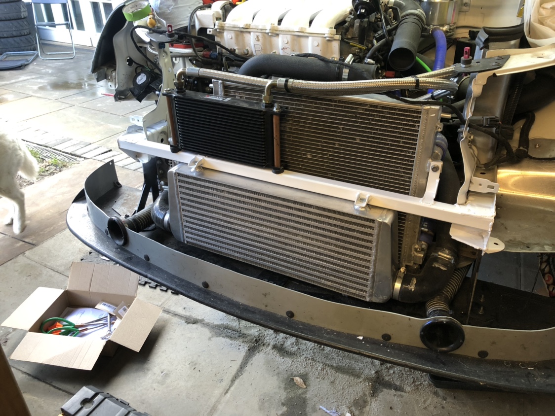

RuskiWeldFab
  Clio 172, RS4 B7

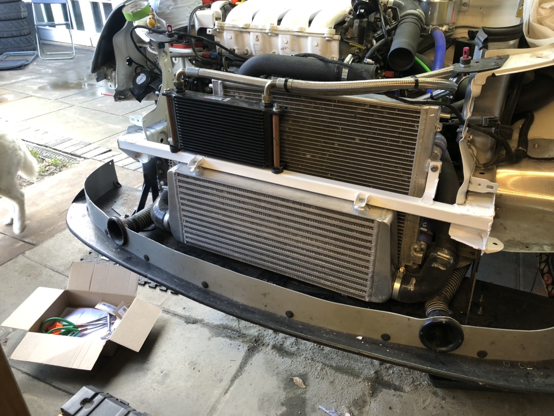

That’s full commitment! Any strength/rigidity issues with removing the crash bar?
Nope none at all. Anything forward strut tops and engine/box mounts is there purely to hold things in place like wings, lights etc etc. Obviously might not be the best idea to remove all if it’s a daily. But for a track car with a full cage no issues.
incy-spider
Nice, it is a fair old lump of metal too.. does get in the way, working around it fitting oil coolers and Intercoolers is a pain in the arse!

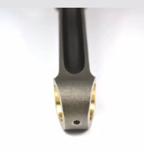

Yeah the turbos with the engine dynamics kit aren’t the best but to be fair it’s not faulted once in 5years of hard work! I’d like to go gen 2 Garret and probably will once I’ve sourced 1 more megane 250 piston, I have 3 which will be going on a set of pec forged rods in the future... so may leave it as is for now. It’s an okay bar and plate cooler in there, just seeing what people have done really

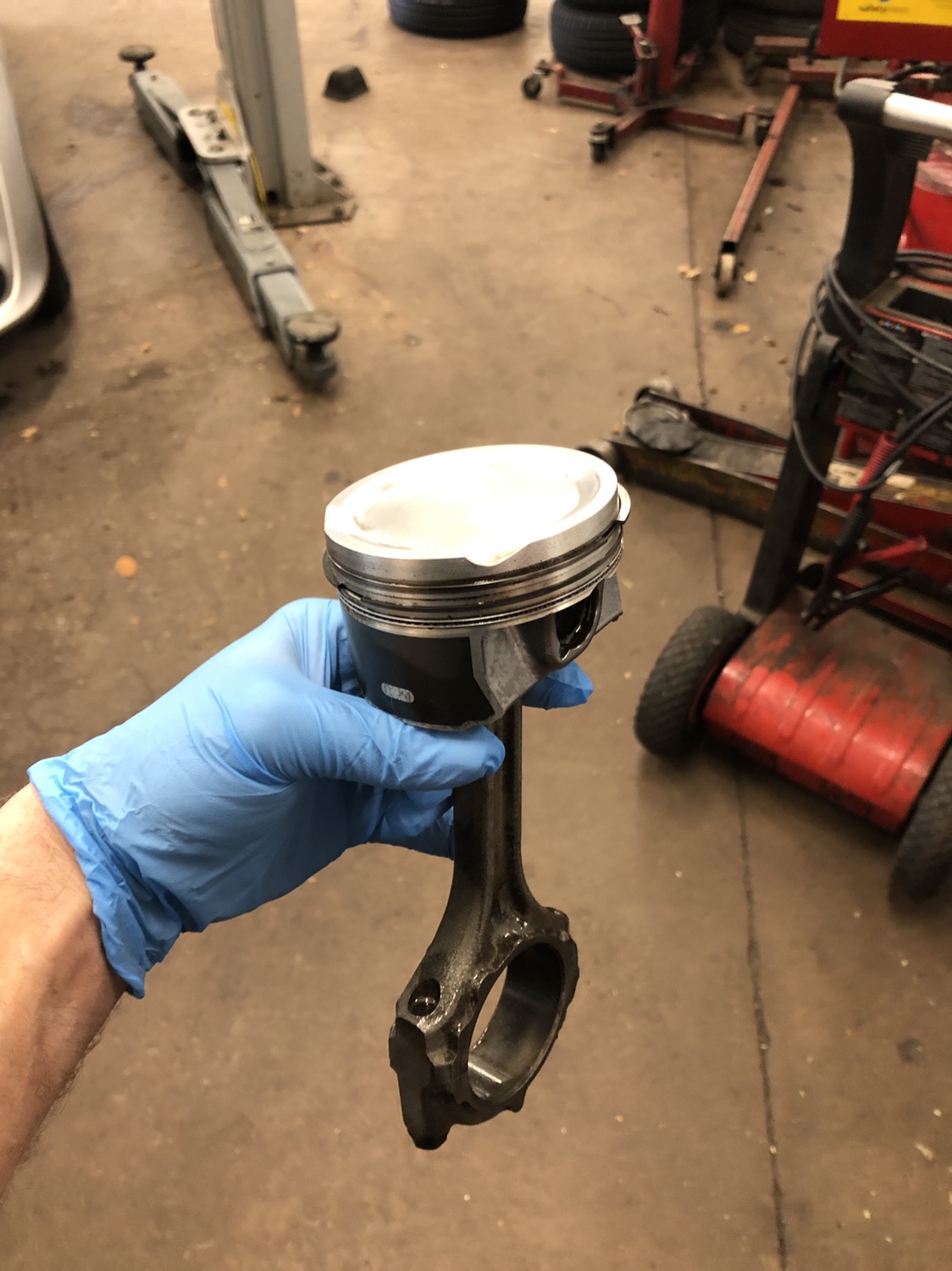

if you're going forged rods then go for new pistons, used 225 pistons are pretty much a waste of time now, seen so many fail. think i threw about 30 into the scrap bin the other week. for the cost of a set of new forged ones it's a no brainer.
incy-spider
Not 225 pistons mate, 250.. totally different, very nice pistons. Forged pistons aren’t for me, it’s a daily car and would kill a set of forged pistons with cold starts, low mileage etc.. I’ve seen far too many slappy oil burning builds to go down that route. Don’t get me wrong they have there use and are great at taking power, heat etc.
Megane 250/265/275 make far too much power for a Clio chassis anyway so around the 300 mark would be plenty for me and reliable with the components I’d like to use.
Not that mine hasn’t been reliable but there is always the underlying thought it’s a de-compressed 182 engine with standard pistons [emoji51]

Lucky to find 250 Pistons. Always keeping my eye open for them but still not managed to pick any up.

I’ve got 3 very tidy ones and possibly have dibs on a set if they turn out to be in good condition, I’ll be aiming for around 9:1 so a 1.3mm gasket should get me there.. need to have the rods tapered at the end too as the megane 250 rods are.
