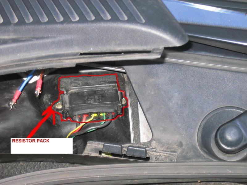

Its the resister pack £90 from Renault for a new one.
Its easy to change its under the scuttle panel under the bonnet.

if you remove the plug from the blower under the scuttle panel you can put a link across the 2 outside pins of the plug and this runs the heaters flat out, this will then prove the resistor pack is the problem

This is the part you are looking for, under the drivers side of the windscreen
Bought mine from a scrappy for £30

Got the same problem, thanks guys for the above help and the picture where the scuttle panel is. superb help.
