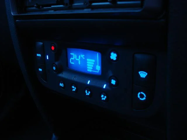

Hi peeps,
Since having my car back from another electrical fault I had a few days ago I've noticed my climate control unit is very intermittent......it used to be like that a few months ago but it sorted itself out, but now its doing the same again.
Example, I get in my car in the morning, drive to college with it working, leave it for a few hours, come back to it to go home and its not?? Then get back in it say an hour later and it is again :mad: The control unit is working, just the fans don't blow. Ive spent enough money on my bloody car this month so wanted to know if there was much I can do myself?
Thanks
Mark.
Is it the same as the Climate control fitted to 1*2's? If so could be the resistor pack which controls fan speed. Common snag.
one of these f*****s:
Same set up then, if its set to that speed and the fans aint blowing then id say your resistor pack as had it.
Thats just a picture off the net.
Doesn't matter what speed I set it to, its just decides when when it wants to work and not. What would I need to do in the case of my resistor pack going?
The resistor pack controls fan speed, some either short on max speed some short with no speed. Yours may be on its last legs, id check the connection to the resistor pack if i were you. If its fucked you can either repair it if your good with a soldering iron or buy a 2nd hand one.
