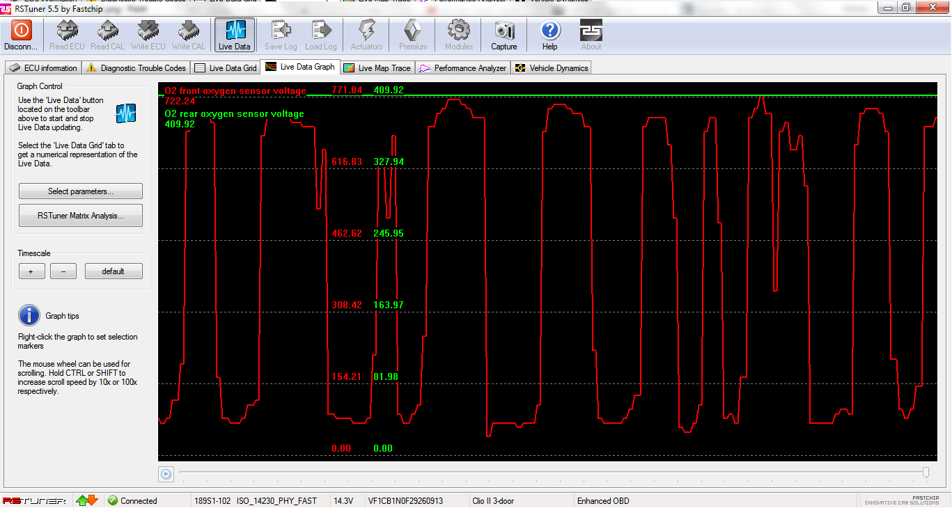

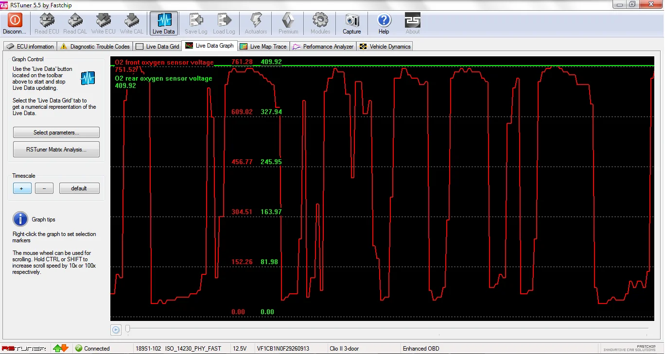

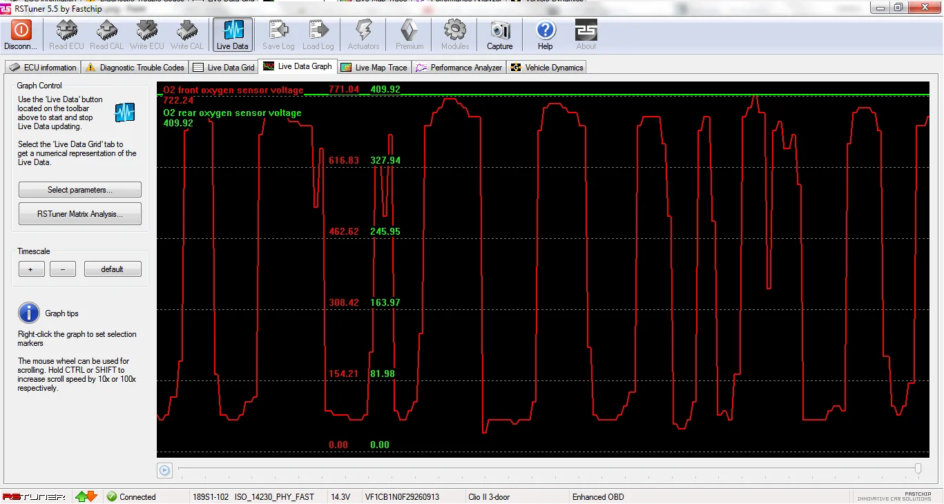

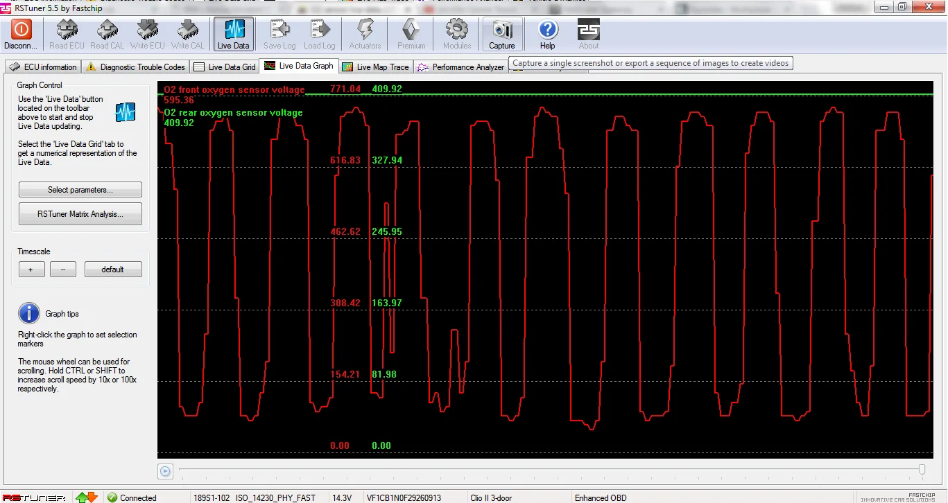

Well...its been throwing the MIL quite a bit more lately so I threw on the RSTuner with a view to looking at the O2 readings.
Was surprised to see both front and rear O2 sensors showing as a historic fault.....bit worried that there could be more to it than an O2 sensor.
Anyway.....what do you think of these graphs for an up to temp idle?
Bear in mind....I wasn't touching the throttle at all so was wondering if those "wobbles" in the signal could be candidates?

Hi, before I replaced my pre cat sensor my graph looked the same. It would switch between .1v and 0.7v. When I changed it for a new one the tick over graph still looked pretty similar to yours but my new one went from 0.0v to 0.8v, so more of a swing. However what really changed with the new sensor was when I held it at 3000 rpm and the graph became much better 'shaped', none of the wobbles and it switched much faster. Maybe try see what the graph looks like at 3000 rpm. I would say your sensor is ok but not perfect. The cumulative imperfection may cause the error code/light. There will be many here that know more than I though.
If yours is ok it may be it's cleanable. I've 'heard' of people cleaning them. In fact I have the one I took out currently soaking in vinegar in my shed as an experiment. I know this will probably get me struck off the forum but I'm going to hook it up shortly to see if it makes a difference. Thankfully I love the smell of vinegar so there is that as I watch the car burst into flames.
Your rear sensor looks very stable like mine too. I thought it must be broken/stuck it was so stable so I briefly swapped the sensors around and it remained the same.
