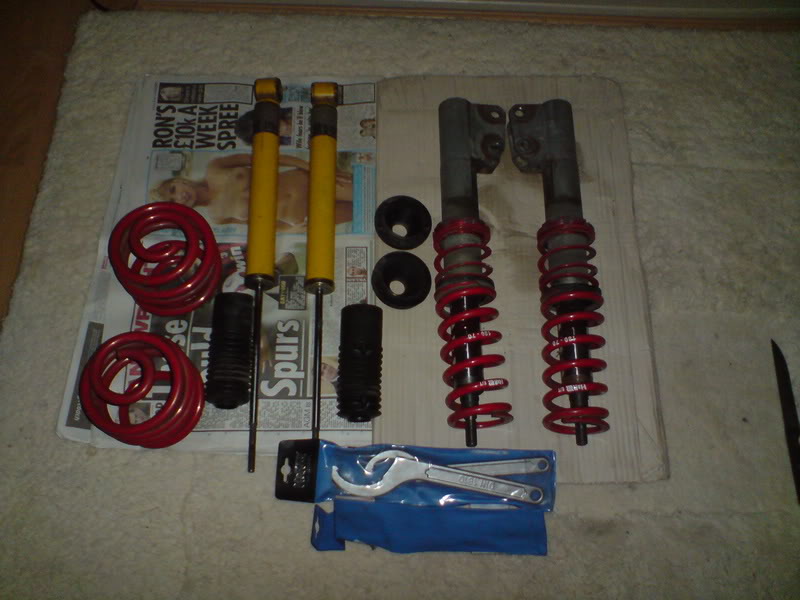

ive just received my coilovers and was wondering if all the gear is hear i know the rear platforms are missing.
thanks
Bit hard to tell from that pic but at first glance I'd say it looks like you have none of the parts that make up the rear platforms. Rest looks ok albeit a bit dirty.
heres a but better pic. is the rear just missing the platform or is there other things that are needed
Much better pic, lol. Nope all the rest is there, those boots go on the front struts on the rear dampers btw. I'd pull it all apart clean out all the threads and lubricate the whole lot thorougly before fitting it. All the parts that you need (bar the missing rear platforms) you swap over from the OE strut.
one more thing would i be able to fit the rear ones until i get new platforms
Craig, can you measure the length of the rear springs for me in mm
Wont be able to fit till you get platforms due to the wider springs, you could but i doubt it would be safe
