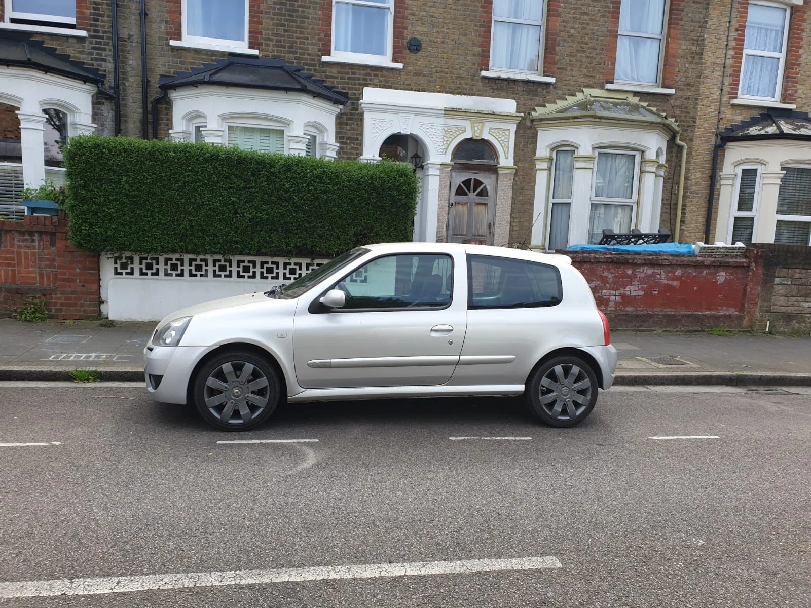

First post on here as my Clio 182 arrived at 1pm today.
The car is currently fitted with a Powerflow exhaust and de-cat pipe - it's incredibly loud.
Does anyone know if I can just swap in a cat and make it quieter, also those £80 cats on ebay seem far too cheap - what's the crack with them?
If anyone has a standard exhaust setup, I'd be keen to swap! Based in East London
