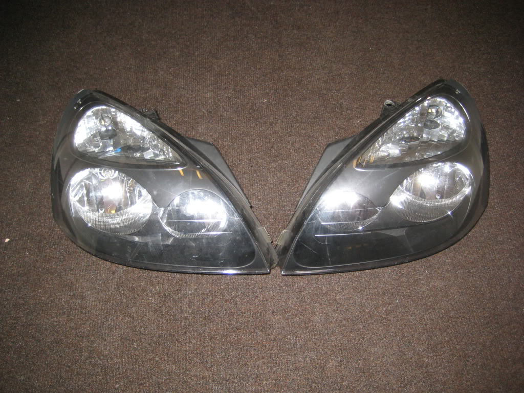

Buy some cheapo 1.2 headlights. Remove the insides. Remove anything which means you need the bumper off to remove them. Use the top two fixings only and remove when you get to the track.. It appears like you've got them to anyone else, but they're easily removed at track. Done.
When I say remove, I mean hacksaw off.
I've got some cheap ones. Just didn't know if they would slot in/out with the bumper on. It would mean my xenons would only be held on by 1 bolt though :S Sounds like an easier / less risky option. Bonnet should hold things in place anyway.lol

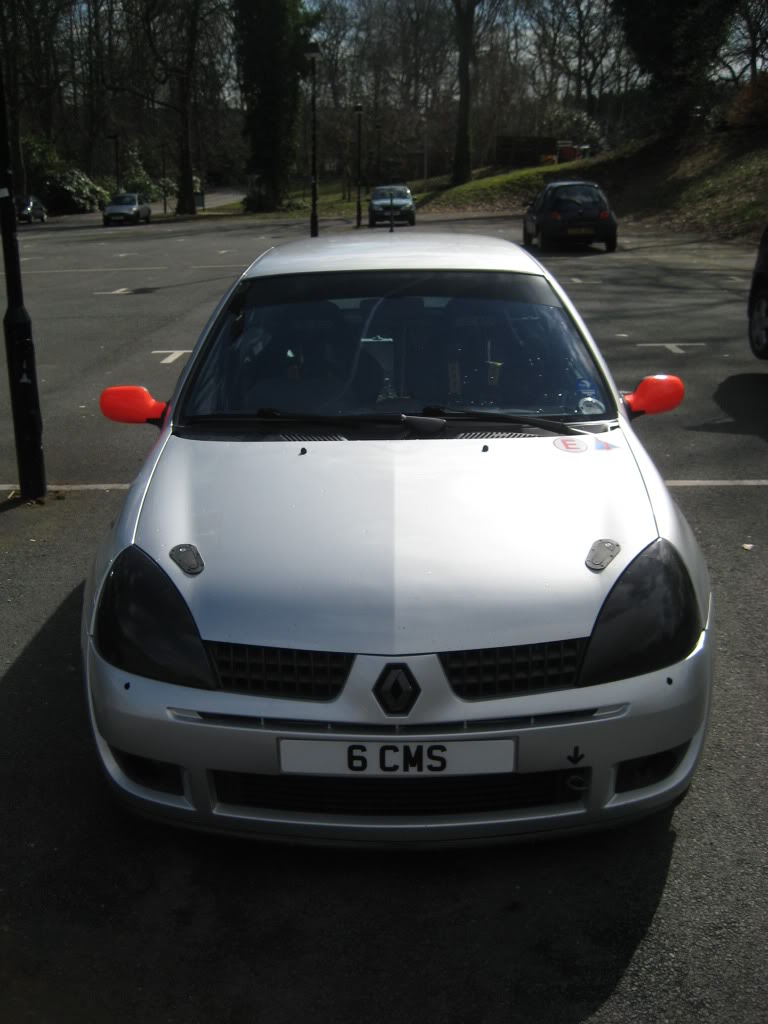

But yes i would have thought they are illegal to drive the car looking like mine do.
My bumper comes off in 2 seconds so it only takes me 2 mins to swap my xeons for my blanks

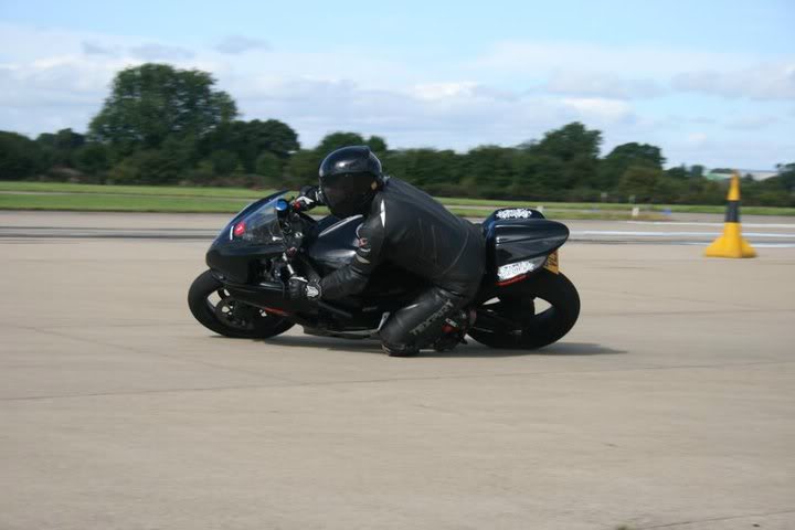

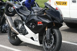

You can get a day time only mot, I have one on my gsxr 1000 as it has no lights, indicators or mirrors :)
Very nice :approve:
I wonder if there is a different ruling for bikes on this though. Not that there should be, but you never know.
Glad you like it mate, heres one of it being used correctly with a bit of knee and toe down action. I was really starting to get to grips with it towards the end of the day and was moving my body off a bit more, managed to get my elbow a couple of inches off the floor but just couldn't quite muster up the courage to push it any further to get my elbow down :(

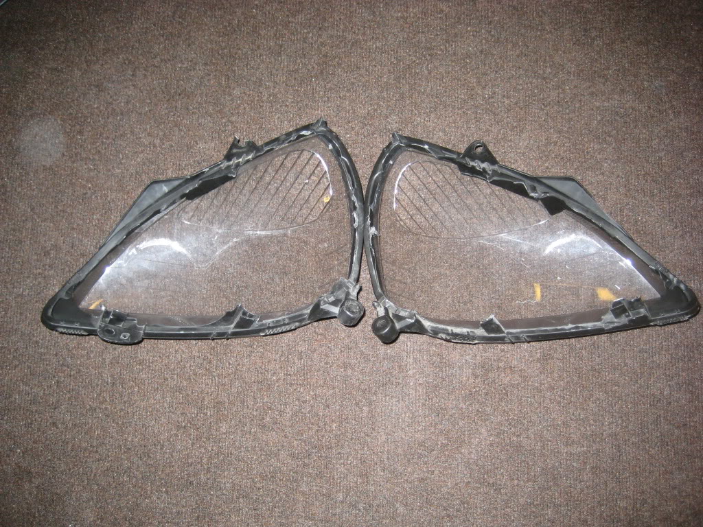

hacked them to bits this weekend. It's amazing how accurate you can be with an angle grinder :D It removed the two lower fixings from the xenons, replaced the bumper and you can just manouver them out. You just need to remove the two plastic "screw things" that hold the black plastic bit of the bumper to the car. I suppose I could put the bolts back in from the rear, but the feel stable enough with just the one bolt. Just need to get the hacked ones sprayed now. Might go down the powder coating route. Just depends on temps etc.

Weight saving wise Daz it only saves around 2kg between them. Not much, but it's as far forward as you can get, so less weight there the better. Main reason was so I can put a vent in the front OS light and stick the CAF there for the airbox. Might run rents in both to help engine cooling. Plus like you say, save the xenons :D
