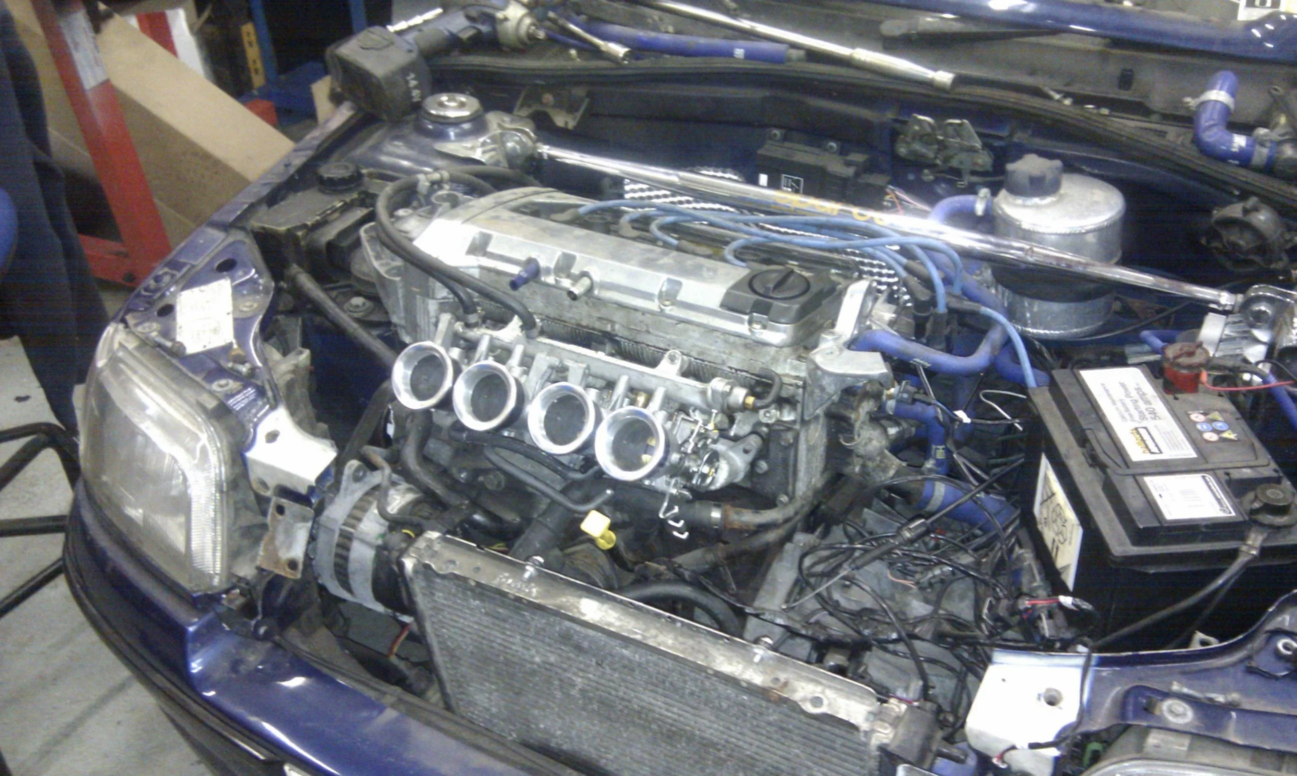

Cool thank you for the reply just having thoughts of what to do was going to match my inlets and then sort some more fuel out... Sounds like you know what you talking about when it comes to clios? What would you recommend engine mods wise as I've just got a 172 and I'm tracking it... Would you just recommend throttle bodies? Possibly bike ones??
  182/RS2/ Turbo/Mk1
Throttle bodies tend to be quite expensive, but are well worth doing if you have the budget for it.
If you can make a set of bike ones fit it yourself, and convert it to aftermarket it and remap it ok yourself etc then its quite a cheap option that will work ok, although the problem with bike setups is that the intake lengths tend to be a bit short for something with 500cc per cylinder like an F4R
Will work ok, just not as well as a "proper" kit

Bike bodies are an arse ache. They're not cheap really once you take the extra work of adapting them into account
Wish I'd said no to this really......
You live and learn. Off the shelf would have been easier and to a better standard.
  182/RS2/ Turbo/Mk1
If people are enjoying working on their own car, then their time doesnt cost them anything as such.
Certainly true from a commerical point of view though.
