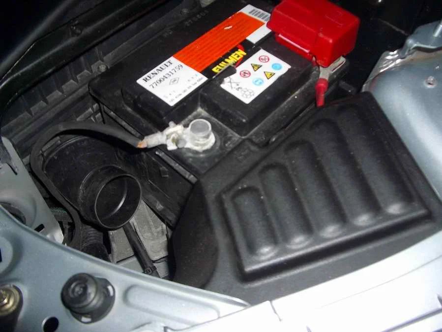

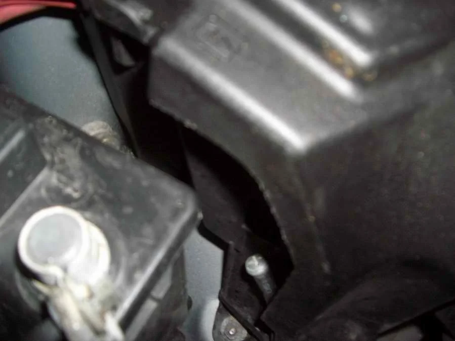

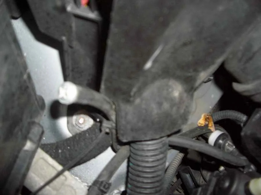

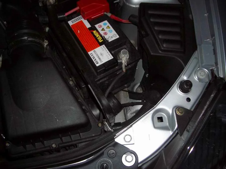

Hi everyone i picked up my girlfrined's new 172 lastnight very nice to drive i must say:D , the only thing is once i got it home and had a look over it in a better light i noticed the idle has a ever so slight miss-bump in it ! . Also it look's like there is a part of the air box missing ? and i found a pipe with a screw pluging it off !
I took some pics as below. So if somone can shead any light on this would be great thanks matt ;)

thats the vaccum feed for the accoustic valve, thats had an iduction kit on it before
that pipe should go all the way upto the plehan and attach just to the left of the throttle body
or you can just rip it all out
that pipe should go all the way upto the plenham and attach just to the left of the throttle body
thanks for the help guys , so would this explain the idle blip? and is it best to reconnect it ? what will it affect if left like this? thanks
