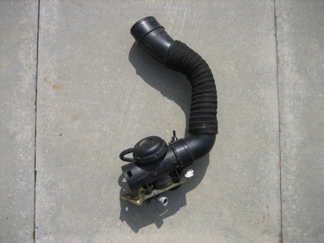

Yes I think the lower part is the valve. Well it's what I removed from mine yesterday! Must admit I can't tell any difference with it off.
Yep the acoustic valve is the section on the end of the inlet pipe, last 5 ins or so, they should separate.

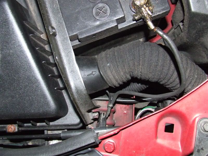

I don't think my car has one? Maybe the old owner took it off, it's attached to the pipe on the in air feed that appears to go behind the wheel arch?

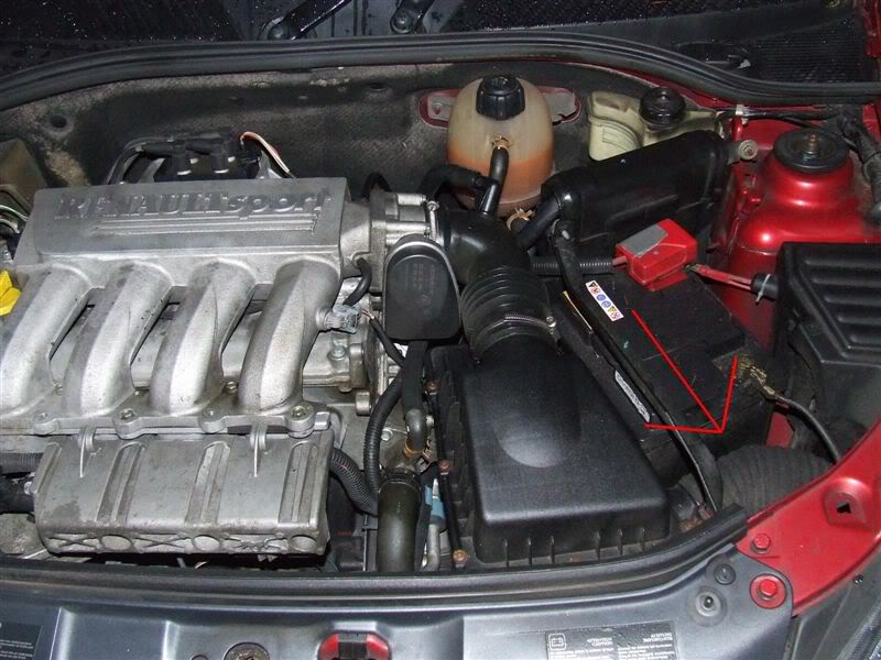

Is it on the end of this hose?
Which leeds down the side of the wheel arch for some stupid reason?

It's held on with one bolt and comes off easily. It's the black cylinder bit above the horn in the photo above.

Thats what I thought! It's one bolt, a vacuum pipe and the air feed. It took 2 mins to take off. I can't feel any difference but it's not goin back on just yet!
