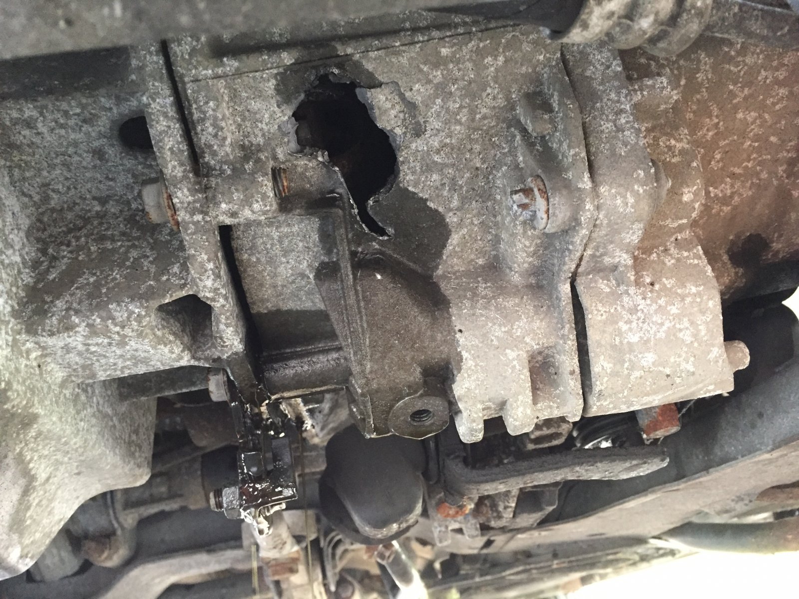

So tonight this happened....
Where can I get a good reconditioned gear box!

Clutch failure by the looks of that mate. Where in the world are you? I've got a set of casings I could potentially build your original box up into.
I'm in north east mate, I don't think it's clutch? I down changed to second at 80 instead of 4th. Stupid mistake. Internals might be okay? Diff will have went I'd imagine.

Flol yeah that won't have helped! Internals might be ok, but doubtful mate. The hole looks to be in the front of the bell housing?
Yeah it is mate. I'm devastated cause the box was perfect. What's the best option for me now I want another box that's just as good.

I lost all box oil mate. Came from a different part of the box. Possibly the diff. Car now won't start either sounds like starter is just spinning and not engaging? I'd imagine engine should be okay? It's on 80k.
Ah right ok. Well it's safe to say whatever let go has taken other stuff with it. It will have smashed the crank sensor mate that's why it won't start. If I were you I'd be getting the box off and out the way to make sure the flywheel is ok. I'd say it will be though tbf.
I've seen this happen before, the flywheel and clutch came out through the front of the gearbox and took the radiator out.
But also with the engine revving so high it also made the cam belt bottom gear slip which took the valves out.
You might be lucky.

I had one in a few weeks back that did exactly the same, at the same speed etc. Engine management registered 9488rpm, and it had undone the crank bolt. Hadn't done any damage to box or flywheel though! Pulled the sump off and it had spun big end shells aswell. Safe to say yours will be knackered.
Well there hole in the box is big enough and lost all gearbox fluid. What's best to check first as I don't have access to a ramp where I can leave it there until it's sorted. It sounds as if starter is just spinning up. I can't remember if engine was still running when I stopped tho. I just turned it straight off. So most likely it has blew engine too?
