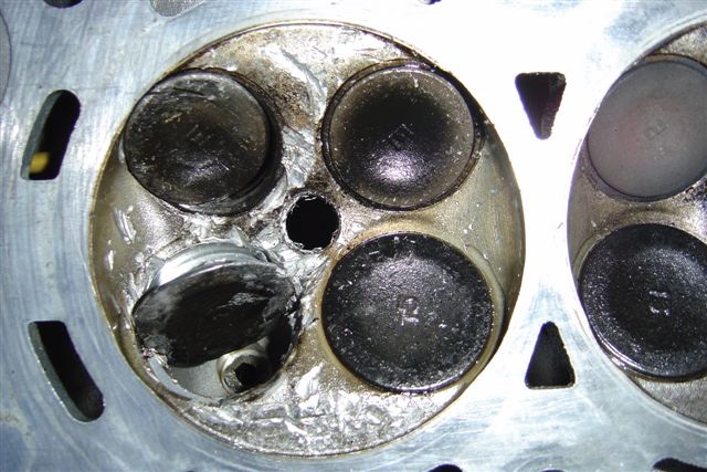

Just a little update. I've turned it over I can feel the cams rotating and the timing belt so I guess somthing has went bang.

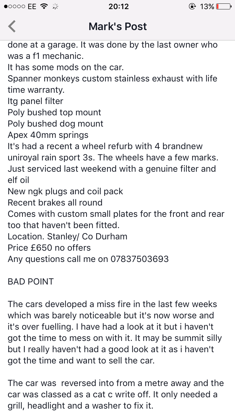

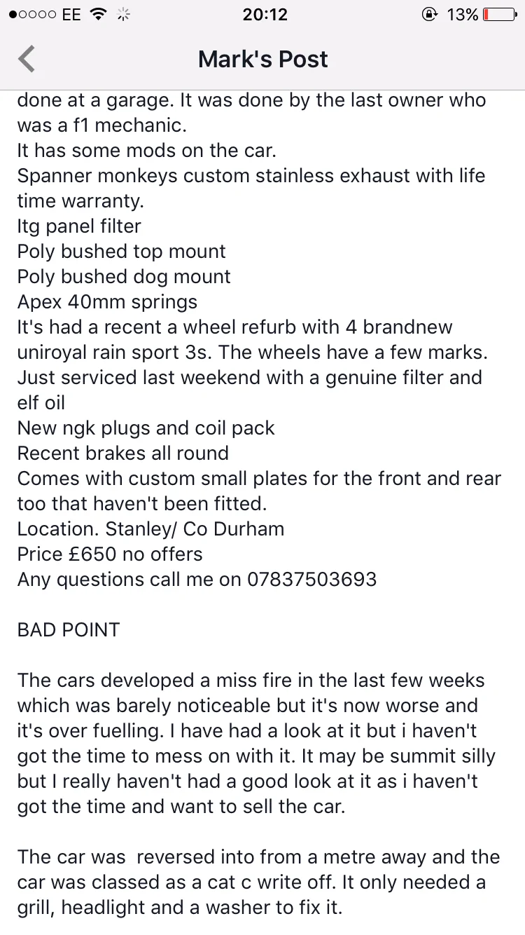

Look at this photo this 172 is £650 it has 87k on clock. But read engine problem. Is it worth it?
You can't modify it mate. The plate that is!
The misfire could be a duff injector or lambda as the other stuff has been replaced reading that.
Think it's worth getting for the engine?? Surely the engine will be fine? And I can change injectors over? Do they need re coded?
Replied in the pm mate, but no the injectors aren't coded. Buying the complete car to carry out a swap over is a very easy way to do it as you'll have everything you're likely to need at your disposal.

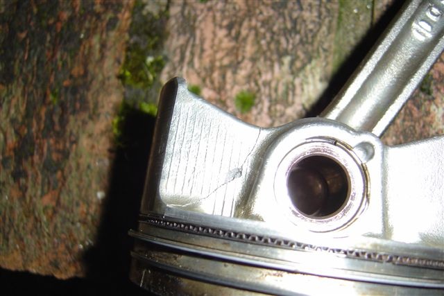

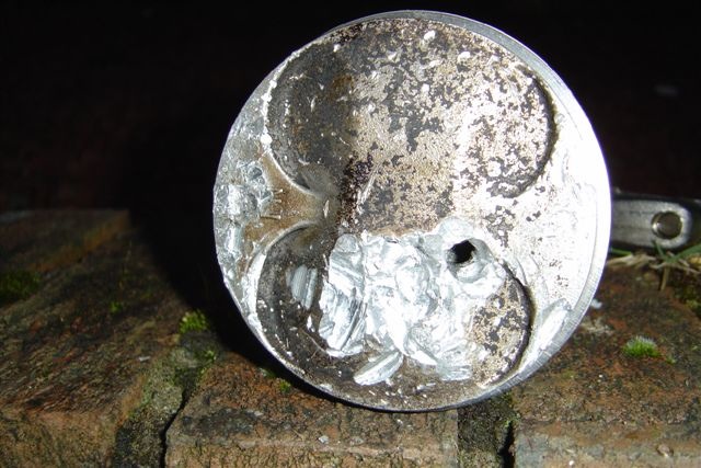

If the cams are moving with the belt then that doesnt mean anything is amiss
Defo fit a new box and engine after going into second instead of forth
All mechanicals would have been spun at over 10k by the driven wheels
Pictures are from a ctr that I changed into 2nd when going from 5th to 6th but got 2nd instead
Don't take a chance and change both box and engine
Rebuild? Sounds like a lot of hassle.
I'd just be dropping a 2nd hand lump and refurbished box in over a weekend if you think the car is worth saving.
2nd hand bits like this always appear on the forum, or just go on one of the many RS Facebook groups and find what you need there. You can often find engines with the belts done too.
