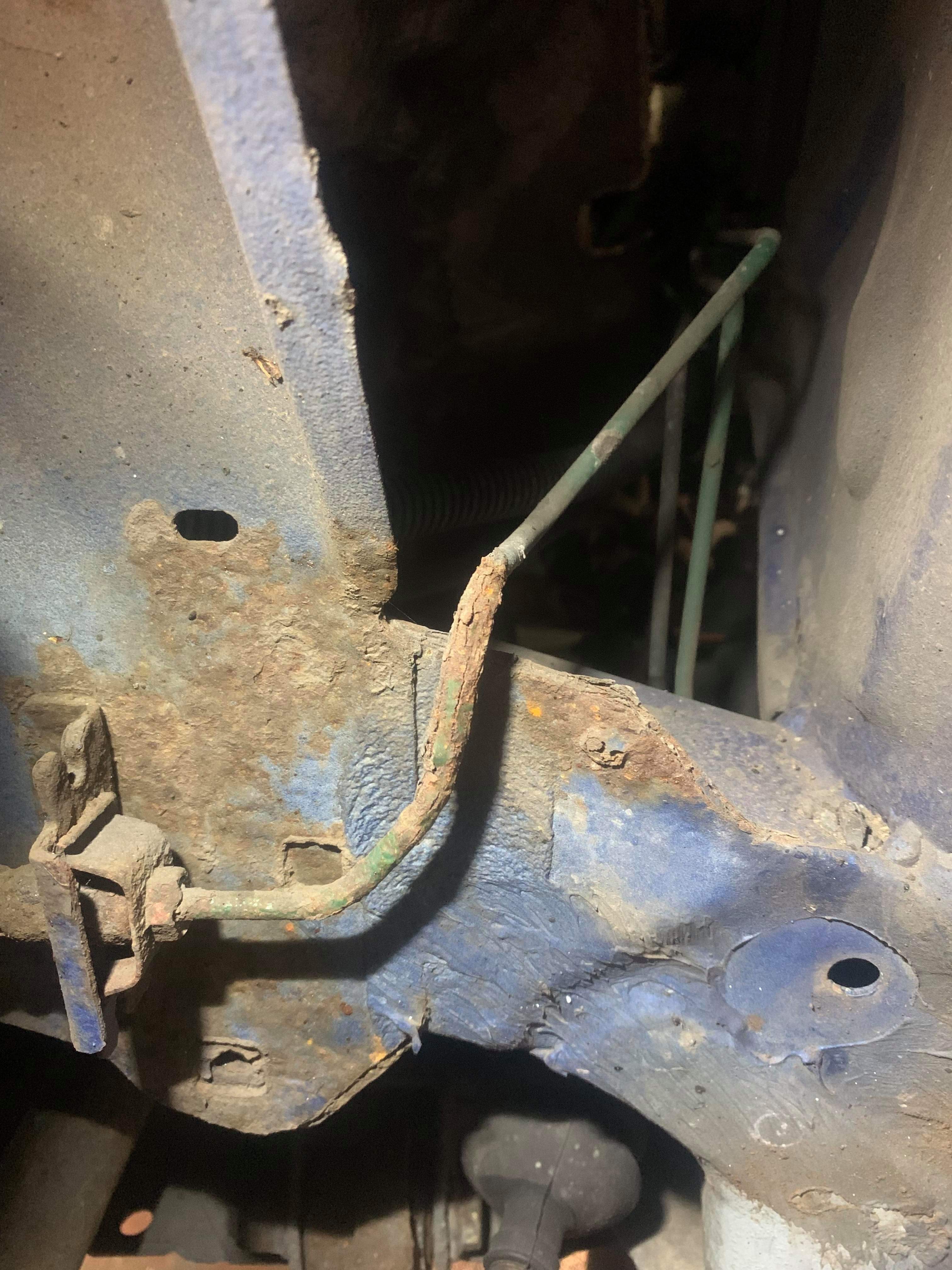

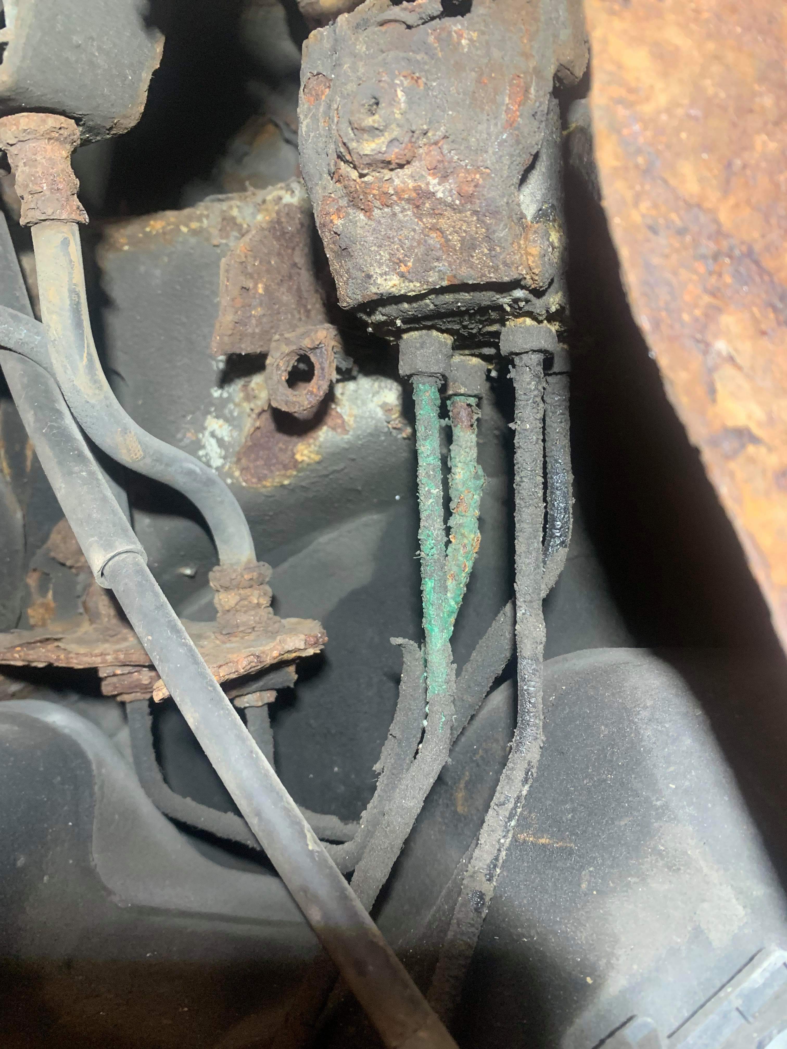

I’ve just been advised by my local garage that I should probably fix my car and sell it due to the amount of rust it has. My brake lines are so rusty that you can peel them apart. What should I do?

These clios do rust in certain hard to get to areas, them brake lines should of failed the mot a good few years ago, but are cheap and very easy to fix, the green areas on the lines are a sign of erosion and will likely fail very soon, find someone on here local who knows what their doing and change all the lines, easily done in a day no issues, basic maintenance

Not true, they're green from factory.
I reckon those brake pipes would burst if you had to stand on them hard 😉😮
I certainly wouldn't be selling the car for any of those problems though!
