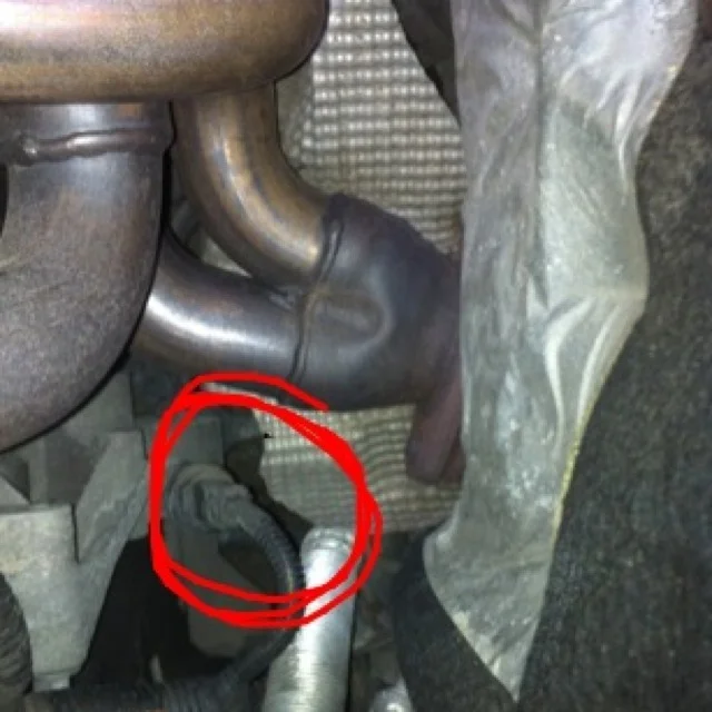

Is this the speedo sensor?
Car  RB FF 182
Hi guys.
Wanna make sure this is the right sensor before I take it out to check/clean it.
It feels like it needs to be removed with a spanner??
Thanks for any help.

yh thats speedo sensor, the switch has to clips that once pushed into the box clips into two holes oppsite each other, u have to push both in then pull the switch upwards. quite fiddly
The plug is cliped on and should be easy to get off, getting the sensor out is another matter. I had a new one waiting to go in so i used a big pair of mole grips to grab the big plastic bit and tugged for ages. Eventually poped out.
Then the new one slipped straight in.
Changed! Finally know how fast i'm going! lol
Was pretty easy to get when I realised it sits at a slight angle... Spend ages pulling straight up, but it leans slightly toward the cabin of the car.
Once I pulled in the correct direction it came straight out. New one slipped straight in (although doesn't feel secure... but it's still there and working).

Tbh you need to push it in as hard as you can so it does feel secure. Just keep pushing until it clicks and you should be ok.
Yeah it's in as far as it will go, I was expecting a click as I've read that somewhere before.
Speed is accurate. Once I get home and it's cooled down I'll have a look. The old one came out really quite easily, and the new one has a similar level or resistance. So it's probably OK. No harm in checking though.

Why did you change the sensor? Was it because the speedo is completley out? The only reason im asking is because my speedo has completly died and says im doing 160mph lol and im going to change the sensor and hope it sorts the problem.
I changed mine last year as my speed was working intermittently, before you order one I'd double check and make sure your car uses one (going by your username if you have a 182 the speedo uses the abs system rather than a sensor on gearbox)
