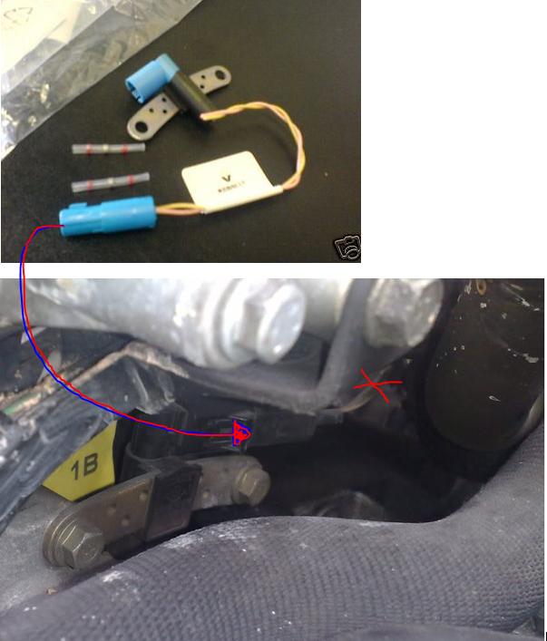

Is this the tdc sensor?

This may be a rediculously simple answer, but if you were to buy the revised TDC and Loom is it just a plug and play affair.
Does the end of the new loom connect right into the old wiring where indicated? Or do you have to splice the cables where indicated by the red X? Does it connect further up past the X?
When I cleaned mine around a year ago it solved the issue, but now i'm getting the over night turnover problem. It looks pretty tight down there any splicing the blocks with some bullet connectors would be pretty fiddly!
Or maybe it's a lot simpler!? Can someone help? There's no real explanation in this thread about what to do with the cables?

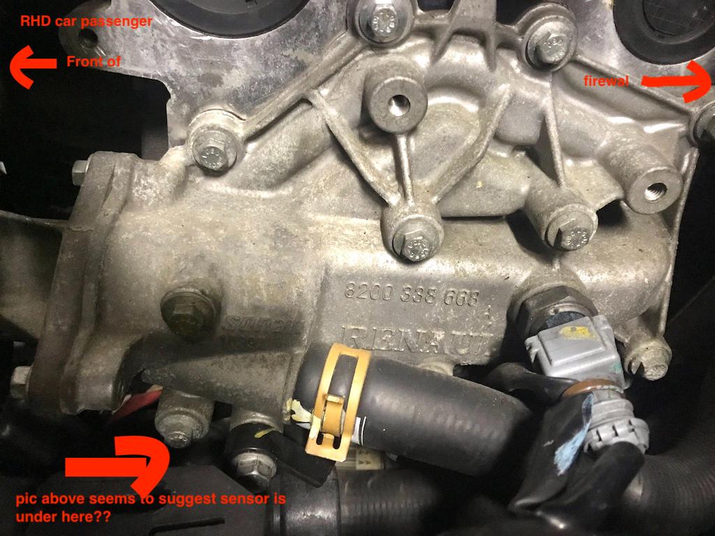

dragging an old post out... what is the location of the sensor? cannot see it as per pic above which seems to suggest its below the plastic bracket :-(
Any help greatly appreciated.
Car is a RHD 2008 Clio Sport.

Assuming it’s a Clio 2 with an F4R engine, it’s basically under the throttle body from memory. Need to take the air box out of the way.
  Clio 172 + Clio200T
Thanks pulled airbox out but its not obvious, unless i'm missing something :-(
Look at the side of engine, see those 2 black round caps ? (For camshafts) ok now point between them and follow a vertical line going down.. until you find where gearbox joins engine. In that point you will find the sensor it has a black roundish connector if first type, or nice blue if newer type.
  Clio
As per @hopgop1 above, the sensor is indeed in front of the g'box. Accessible from under the car after removing the tray. A tad fiddly buy relatively easy to access. Quick clean and back in for the time being. Now to source a replacement :)
