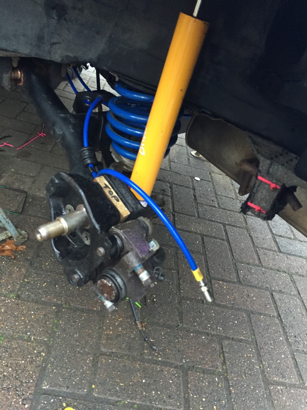

Update.. Brake pipe is burst and is causing the issue. Need new brake lines and Renault don't supply them any more. So need to get them made up.

I went custom for mine as got fed up trying to find some, cost me £60 for the pair and it's a much better way of doing it IMO
1 pipe from the splitter box to the calliper now joins
Great idea .. mabe look into this actually.
