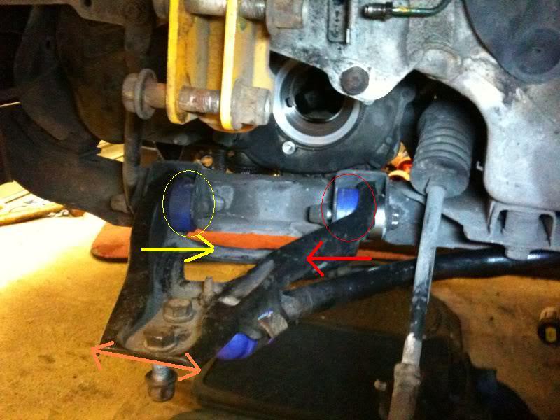

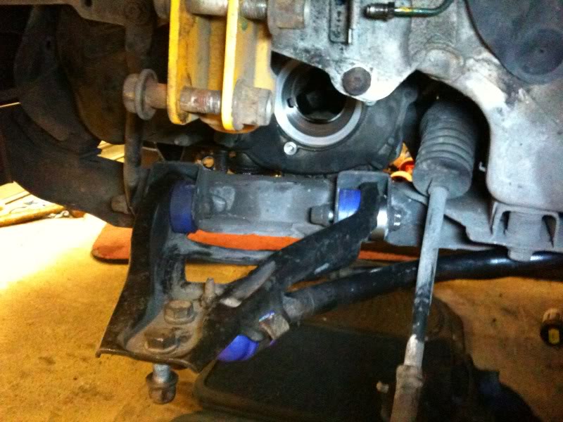

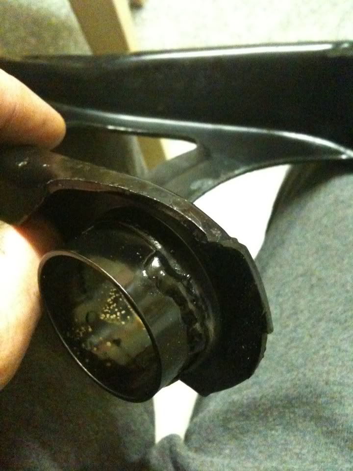

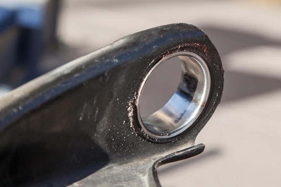

With that you can rule out the nut/ bolt because it isn't moving, the subframe and the wishbon, only remaining offender is the bush and sleeve. What's the front one like? Got any pictures?
Got two photos here that show the front bush. As you can see, it is no where NEAR as bad. The odd thing though is that the rear bush on the right side isn't as bad as the left side either.

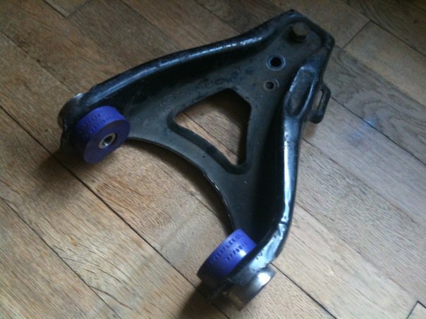

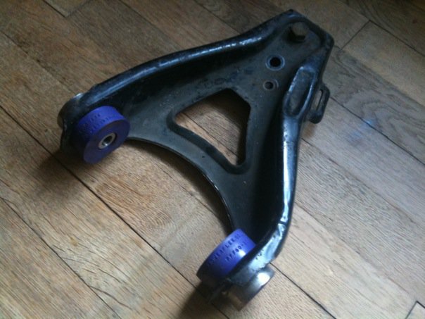

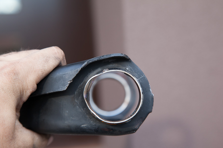

Did mine myself about two years ago, no rubbing what so ever. Just need to make sure the sleeves are in the right place and give it some good welding ;-)
The sleeves as they are, are in the correct place and welded fine. There's no point welding too much - it won't help my situation and the weld is just there to stop the sleeve from being pushed out of the wishbone, so you don't need much at all! Don't underestimate the strength of a small spot weld.

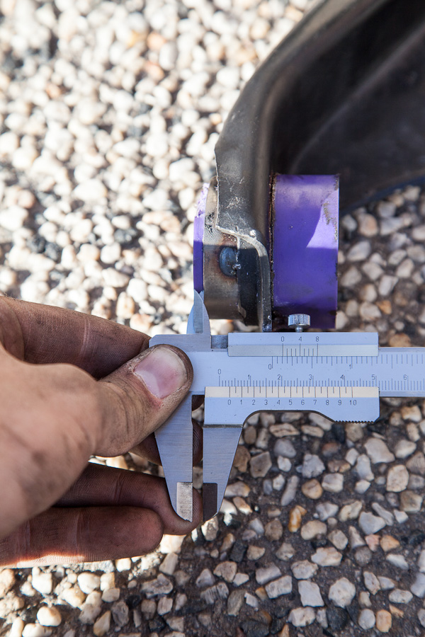

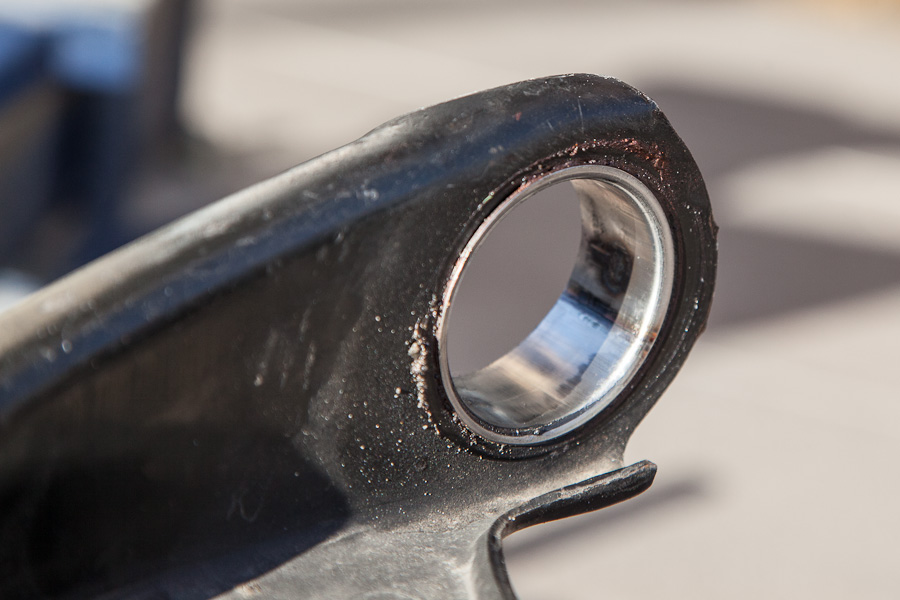

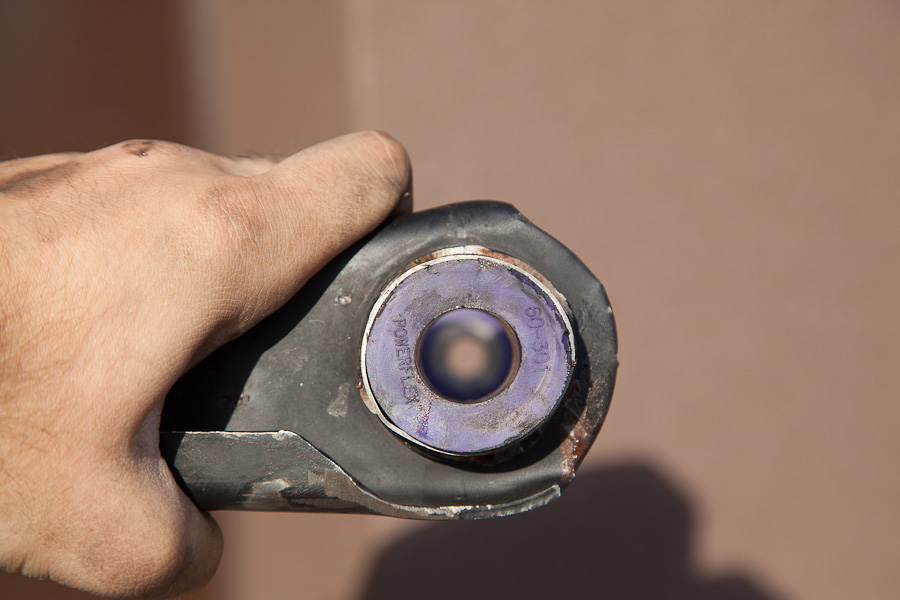

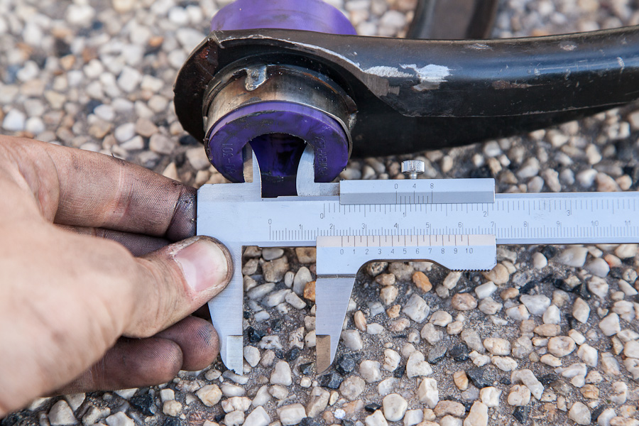

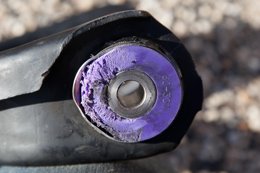

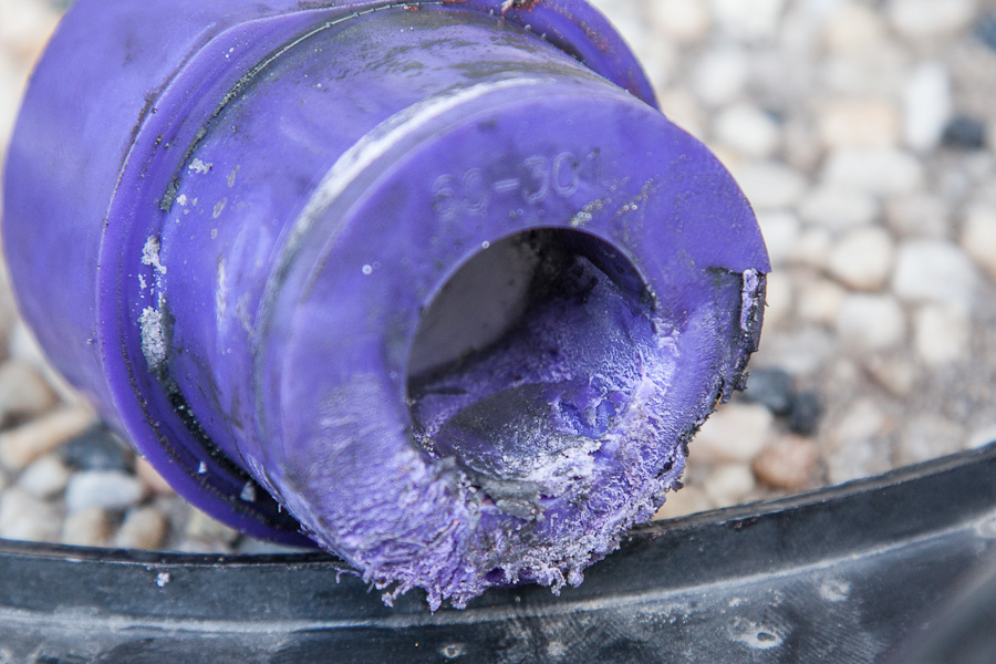

And we continue on with some more images.
Here we have a ahem, 10mm, gap...
