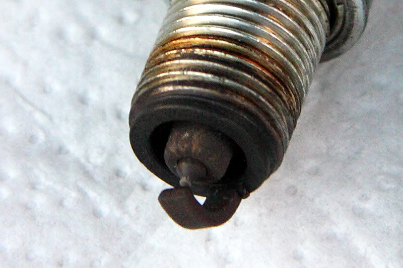

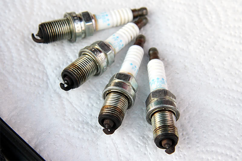

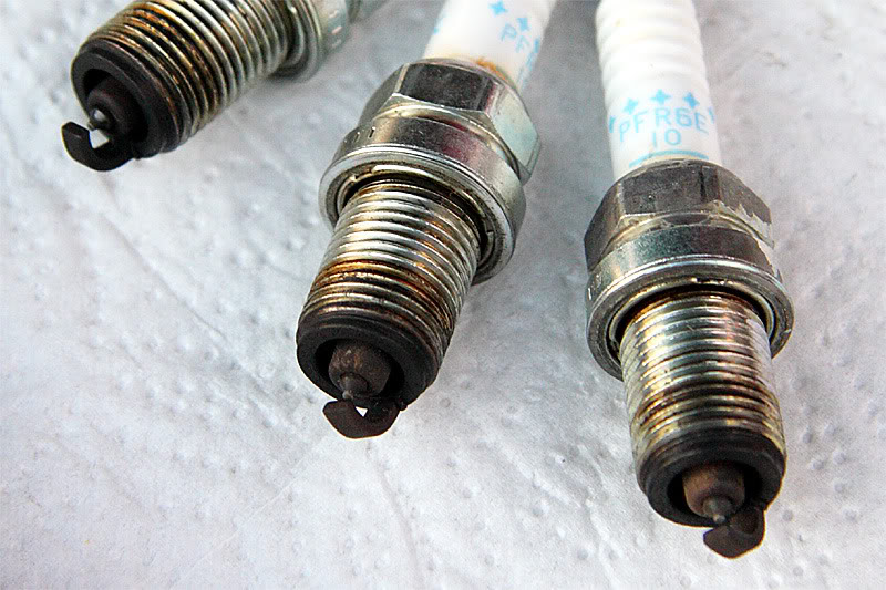

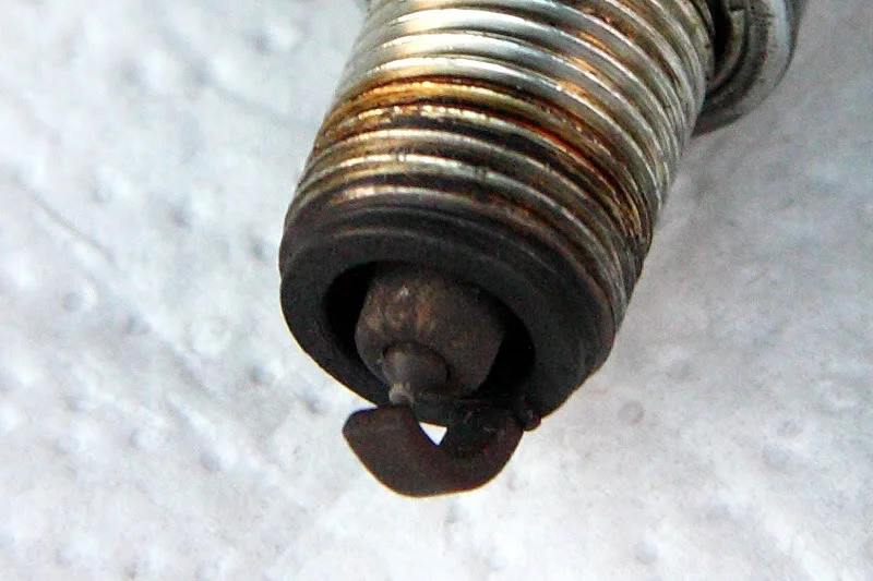

Danny, this is the condition of the plugs now (having been wiped and cleaned with WD40).
I'm no expert... but they've probably seen better days?
